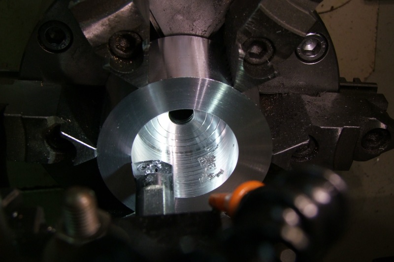

So I bored the existing hole a little bit to clear the female nut:
And then bore the inside to allow room for the wires, switch, and future LED Driver.  I also designed a small area near the top which will be a press-fit for the OD of the female nut.  Of course I did the boring in several passes, and then one final cleaning pass:

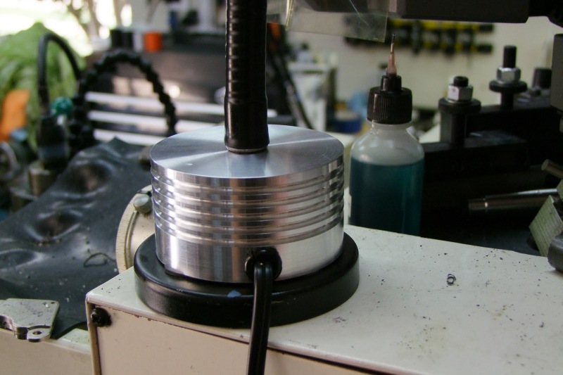

Since in the future this base will house an LED driver, I went ahead and cut some deep grooves to aid with air flow - plus yes, it makes it look like a piston:
Since the walls are so freaking thick compared to the plastic base, I had to go back to the mill and cut a recess for the ON/OFF switch:
This is how everything looks like before bolting up - yeah, I know the 4x holes are not concentric - I only cared that they matched the 4x holes in the base, so this was "close enough":
Here is the assembled, and once again fully functional lamp:
