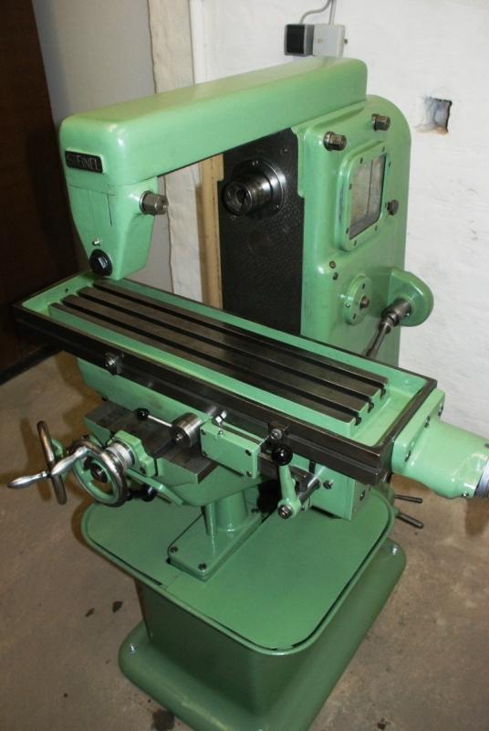

            I have a Rodney Plus Mill which I had for ages. It is a free standing mill and is identical to the ML7 attachment, but on a fabricated base containing the motor and speed change pulleys. The speed range is 320 to 2750 showing the bearings to be very substantial. The quality of the machine matches Myfords quality, and has proven its worth in machining the gears and pinions for  many mechanisms, plus numerous workshop machinery projects. I have been well satisfied with this 2nd hand machine. The only change to the machine was I had to raise the column 5 inches to enable dividing heads and vices to be accommodated. Buy a machine that has been looked after and I think you will be happy. The Rodney is better than the Amolco. The main thing to consider is forward planning your projects, so that when making components, you can turn several, then mill in batches to reduce lathe/ mill change over hassle.
                         Good Luck   David
