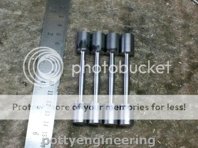

Then turned up the spool valve from some silver steel bar,
Drill and tap and acuratly turn the gap and over all length as these are important to the valve timing.
http://i431.photobucket.com/albums/qq32/sbwhart/Potty%20Simpson%20and%20Shipton%20Short%20Stroke%20Engine/131_1255.jpgPotty Simpson and Shipton Short Stroke Engine
Camera went flat at this stage, and couldn't be arsed to get the spare out of the house.
Finished of the rest of the bits for the gland, this is how they all fit togethere
http://i431.photobucket.com/albums/qq32/sbwhart/Potty%20Simpson%20and%20Shipton%20Short%20Stroke%20Engine/IMG_3576.jpgPotty Simpson and Shipton Short Stroke Engine

Next up the con rods the engine has four using 9/16 free cutting mild steel first cut off to length face them up so they are all the same and centre drill and turn up a lost centre.
http://i431.photobucket.com/albums/qq32/sbwhart/Potty%20Simpson%20and%20Shipton%20Short%20Stroke%20Engine/131_1419.jpgPotty Simpson and Shipton Short Stroke Engine
With a part off blade put a couple of grooves into them to show where to stop and to give some clearance to the turning tool.
http://i431.photobucket.com/albums/qq32/sbwhart/Potty%20Simpson%20and%20Shipton%20Short%20Stroke%20Engine/131_1420.jpgPotty Simpson and Shipton Short Stroke Engine
The with a running centre chew the meat out of the middle.
http://i431.photobucket.com/albums/qq32/sbwhart/Potty%20Simpson%20and%20Shipton%20Short%20Stroke%20Engine/131_1421.jpgPotty Simpson and Shipton Short Stroke Engine
Slew the compound over a couple of deg and with a radius tool form taper toward the chuck, swap it round and tune the other end to form the barrel.
http://i431.photobucket.com/albums/qq32/sbwhart/Potty%20Simpson%20and%20Shipton%20Short%20Stroke%20Engine/131_1424.jpgPotty Simpson and Shipton Short Stroke Engine
http://i431.photobucket.com/albums/qq32/sbwhart/Potty%20Simpson%20and%20Shipton%20Short%20Stroke%20Engine/131_1425.jpgPotty Simpson and Shipton Short Stroke Engine
Cut the centre pips off then over on the mill cut the flats.
http://i431.photobucket.com/albums/qq32/sbwhart/Potty%20Simpson%20and%20Shipton%20Short%20Stroke%20Engine/131_1426.jpgPotty Simpson and Shipton Short Stroke Engine
