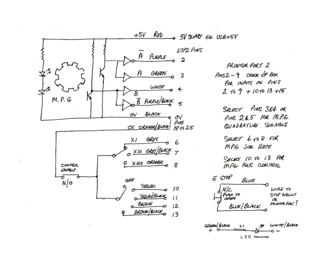

Hi Rob
I've been watching your inspirational project
if you have not solved the Mach 3 settings for the board
what info do you have for the breakout board?
 a table showing the function of the printer port pins ?
PS is this any help ?

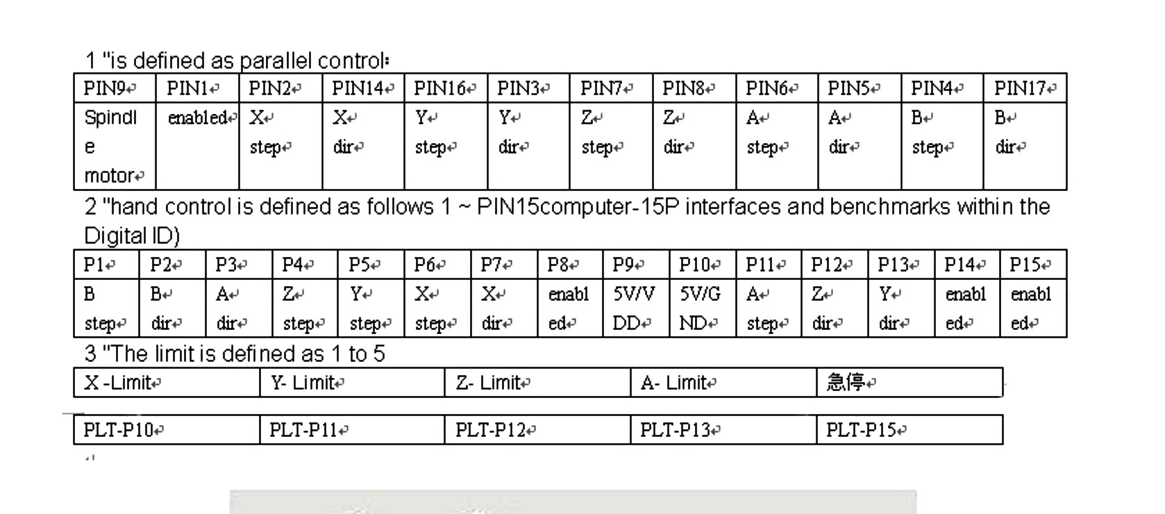

Re: Chester 626 mill CNC Conversion
« Reply #58 on: October 17, 2011, 12:30:52 PM »
Hi Rob
Hi John  :wave:
I have sorted the first breakout board inputs and out puts ,, and all configured in Mach3 ,, Estop,Home switches and all motor spin .
Its the second breakout board (the one in the photo with nowt plugged into it )  inputs and out puts for the hand controller ,,, i have the same drawing as you witch shows the connections to the 15 pin plug ,,,, but what pins do they correspond to on the 25 pin plug  :scratch:   ,,,,, first i need to fined out what pins  are inputs and  outputs on a second  PP card .
Chers Rob
Offline John Swift
  • Posts: 344
« Reply #59 on: October 17, 2011, 01:41:59 PM »

Offline John Swift
  • Posts: 344
« Reply #61 on: October 18, 2011, 10:47:40 AM »
Hi Rob
if you power the manual pulse generator from a usb port  ,
you may be able to connect the switches directly to the second printer port ,with pins 2 to 9 programmed as inputs
(or via a 56 ohm resistor, this  would limit the current if your switch grounds a pin that is  an output at  +5V !!)
better still  another  breakout  board using two  74hc245 octal buffers that can be switched to give you more inputs on pins 2 to 9
you need to set up mach 3 to use the A & B manual pulse generator outputs ,pins 3 & 4  (or inverted A & B  outputs, pins 2 & 5  )
the switches need to go to input signal pins programmed as OEM trigger    (I think ,now I've downloaded the mach 3  manual ! )
not sure what voltage the LED indicator is for , the resistor value is not readable in your diagram
I think I'd connect the E STOP button in series with another  lowvoltage STOP switch  on the machine and not use it via the printer port
 just had a look at the limited info for the TB6560 boards and on the 15w D type connector they have used
pin 14 for GND and pin 15 for +5v
link --   http://www.ebay.co.uk/itm/Handle-Controller-FR-TB6560-5-Axis-Stepper-Motor-Driver-/220859461910?_trksid=p3286.m7&_trkparms=algo%3DLVI%26itu%3DUCI%26otn%3D3%26po%3DLVI%26ps%3D63%26clkid%3D3567783428599467203
the long white connectors on you breakout board is for this type of display -
http://www.ebay.co.uk/itm/320762884378?ssPageName=STRK:MEWAX:IT&_trksid=p3984.m1423.l2649
« Last Edit: October 18, 2011, 02:05:25 PM by John Swift »
« Reply #62 on: October 18, 2011, 12:59:28 PM »
Hi John
Cheers for the wiring diagram  :beer:  ,,,,,,, I was planning on using P9 5V and P10 G  on the 15pin connector on the second BOB to run the MPG , do you think that would work ?
Yes your correct the switches need to be configured in Mach3 ,,,,, i have a list of OEM codes that Mach uses for external switches.
Looking at the board all the 25pin connections have a 56 ohm resistor fitted to them already  :thumbup:
Cheers Rob
Offline John Swift
  • Posts: 344
« Reply #63 on: October 18, 2011, 01:27:52 PM »
Hi Rob
the only picture of your breakout boards I've found is an advert for the  TB6560 boards
I'm not convinced it will let you use printer port pins 2 to 9 as an input into the PC
but the 15 way D type connector does have a +5v supply for the simple "blue"control sold for the boards
I'll see if I can find out which pin
for you initial test just connect the switches to see if the breakout board will let the PC detect  the switches
and not the manual pulse generator
PS   ---  just looked at the limited info for the 15 w D type connector as used on the TB6560 boards and they have used
             pin 14 for GND and pin 15 for the +5v to the "blue" remote control
link --  http://www.ebay.co.uk/itm/Handle-Controller-FR-TB6560-5-Axis-Stepper-Motor-Driver-/220859461910?pt=LH_DefaultDomain_0&hash=item336c3ff116
the long white connector on your breakout board is for a display like this
http://www.ebay.co.uk/itm/320762884378?ssPageName=STRK:MEWAX:IT&_trksid=p3984.m1438.l2649link   --
« Last Edit: October 18, 2011, 02:10:01 PM by John Swift »

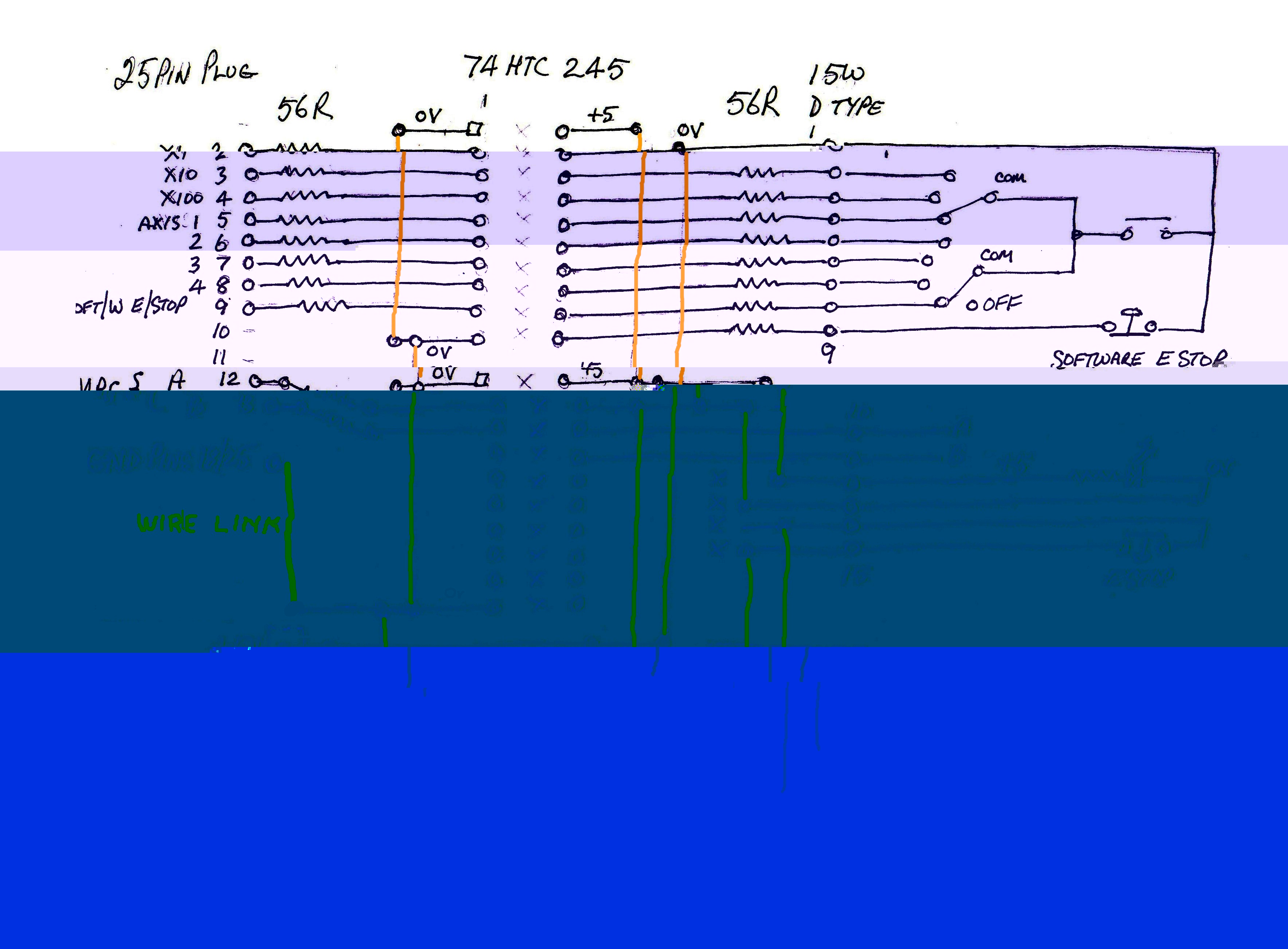

Offline John Swift
  • Posts: 344
« Reply #65 on: October 20, 2011, 02:36:34 PM »
Hi Rob
just an initial idea for a DIY breakout board using two 74HTC245 IC's and vero board
the 56 ohm resistors are optional
so I've not found somewhere that sell an old style of D-Type connector that is ideal for use on veroboard
the 25 way plug will only need one wire to GND with pin2 1 to 13 connected directly to the board
but the 15 way D-type will need 6 wires for pins 9 to 15

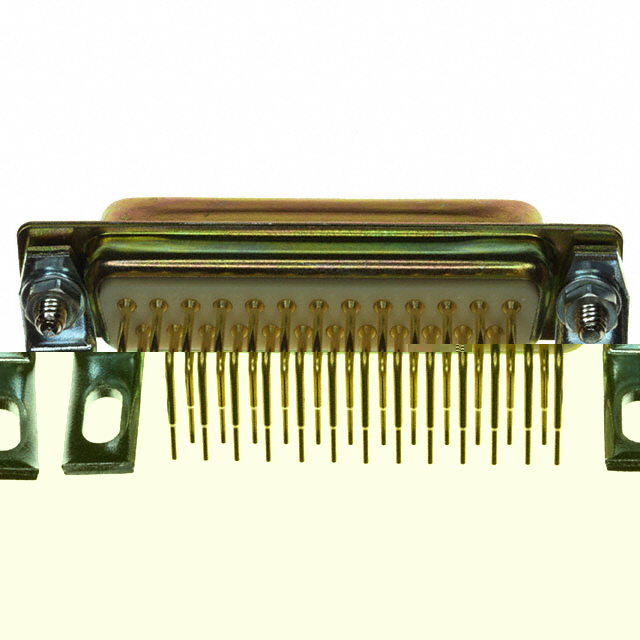

« Reply #66 on: October 20, 2011, 02:42:02 PM »
Hi Rob
Like these ??? Or not the same/similar ???
http://www.rapidonline.com/Cables-Connectors/Right-angle-39-D-39-connectors-63708
BC
Offline John Swift
  • Posts: 344
« Reply #67 on: October 20, 2011, 02:55:19 PM »
Hi Dave BC
for a printed circuit board the connectors from rapid are OK
 but the ones in my picture are better for veroboard
because you can bend the long pins from the top row to fit the 0.1" grid
the solder tag version is the alternative I'm likely use ?
« Reply #68 on: October 20, 2011, 03:05:52 PM »
Cheers John ,,,,,,,,, Now that looks like a great plan B  :thumbup:
Cheers Dave ,,,,, looks like i better setup an account with Rapid  :headbang:
Just an idea ,, i could have the 25 pin on a lead and fix it so it comes through  the side of the  enclosures    :zap:, it would make it easier to hook the computer up .
Cheers lads Rob     :)
« Reply #69 on: October 20, 2011, 03:16:15 PM »
Hi John
What are the two capacitor values ?    ,,,,,,,,,,,,,,,,, is it better to have the resistors ?
Offline John Swift
  • Posts: 344
« Reply #70 on: October 20, 2011, 03:26:47 PM »
Hi Rob
sorry its a bit too small on the diagram but any thing around 0.1uF will do
If you use ribbon cable you can place both connectors on the side of the enclosure
IDC  D-types and IC headers could make the connections easier
how are you going to use the stop switch ?
« Reply #71 on: October 20, 2011, 03:45:17 PM »
Hi John
cracking diagram  :headbang: just printed it off .
I think i have a header cable some were , plan gets better .
the  E stop i will connect across to the first BOB E stop pins .
Just need to fined some 74HCT245 chips ,,,,,,, was hoping maplins would have them ,,,,,but they dont  :(

I only have 17, but they are 74HC245's ...
Want some ???

Hi Rob ,
the circuit can be rearranged to use the 74HC541 that maplin have cat no UB93B but it looks like you have to order it
