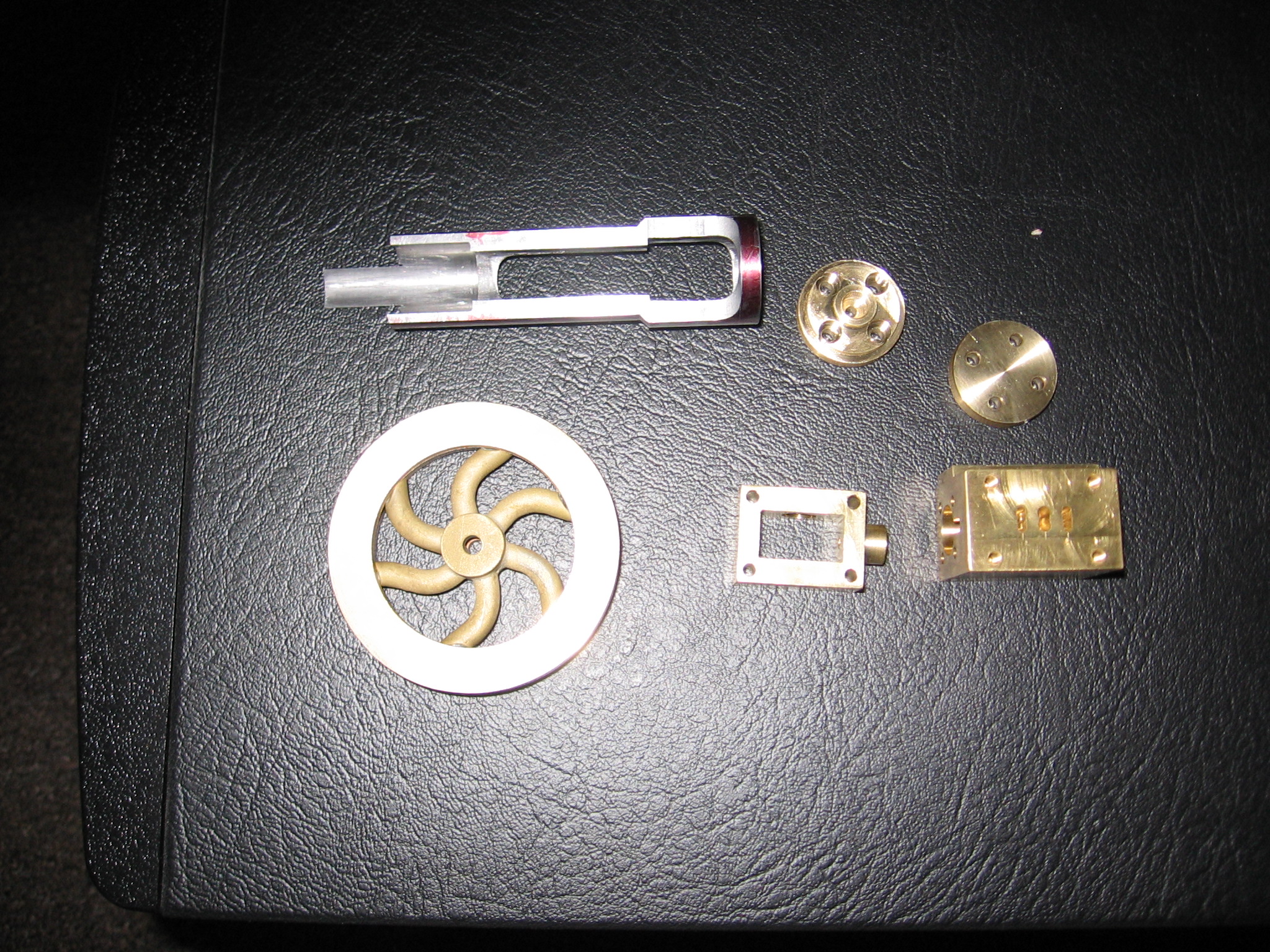

Hi Guys.
 well I've finally bitten the bullet and started building this engine.
this won't be a blow by blow account, rather a show and tell as I (hopefully) finish a part.
It will also take me a fair amount of time as I have to save for the material and tooling required, I've already come to a stop on the head because I need a rotary table and they don't grow on trees.
parts so far, cylinder jacket
http://i293.photobucket.com/albums/mm72/wheeltapper_2008/model%20engineering%20stuff/cylinderjacket.jpgNemett 15cc 4 stroke engine
crankcase nosepiece.
http://i293.photobucket.com/albums/mm72/wheeltapper_2008/model%20engineering%20stuff/bearinghousing.jpgNemett 15cc 4 stroke engine
part finished head.
http://i293.photobucket.com/albums/mm72/wheeltapper_2008/model%20engineering%20stuff/partfinishedhead.jpgNemett 15cc 4 stroke engine
and crankshaft.
http://i293.photobucket.com/albums/mm72/wheeltapper_2008/model%20engineering%20stuff/crankshaft.jpgNemett 15cc 4 stroke engine
That's it so far.
next is get a square lump of ally for the crankcase.
expensive hobby this, ain't it :(
more to follow soon.
I hope  :D
cheers
Roy
