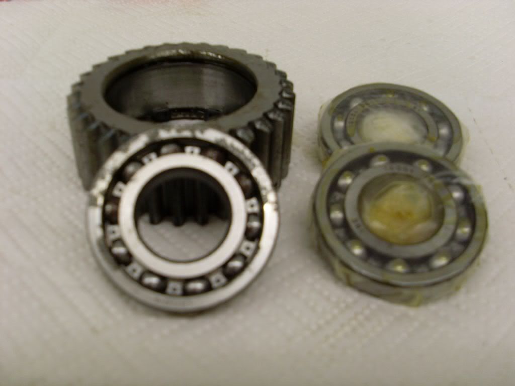

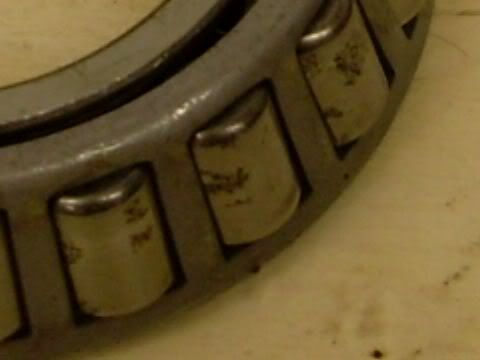

I remembered reading a post a while back on Model engineer from Lathejack and he has an album here of the problems wrong with his lathe.
http://www.model-engineer.co.uk/albums/member_photo.asp?a=13378&p=225751
Here are some pictures of his bearing from a new lathe
http://i702.photobucket.com/albums/ww21/1top720/John2.jpgNoisy spindle bearings...
http://i702.photobucket.com/albums/ww21/1top720/John.jpgNoisy spindle bearings...
http://i702.photobucket.com/albums/ww21/1top720/John3.jpgNoisy spindle bearings...
As you can see his came with rusted bearing from the supplier.
Kero will be fine, but I think the spindle would be better out of the head stock and this will give you better access to see the bearings and check them over.

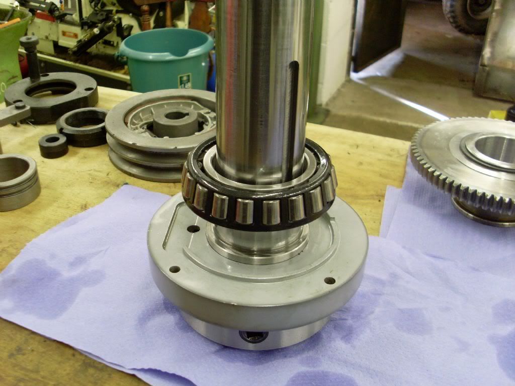

I thought today would be a good day to take a look at those spindle bearings....
It was only a few minutes to get the cover off the left hand bearing and to take the lid off the box, then I took out the four screws that hold the ring around the other end of the spindle.  Of course I had taken the chuck off but that ring does not come off over the D1-4 mount,  surely the mount does not come off the spindle :scratch:
So back to the other end, I loosened the preload lock nuts, they were not very tight and required only minimal effort to loosen them.
Then I looked inside the box to see what would be required to slide the spindle out, there are a number of gears on the spindle which seem to be kept in place by one black metal ring which has two set screws, so I loosened them but the ring does not easily move.  So that was the end of any notions of being able to slide the spindle out or get a close look at the bearings. :scratch:
Although the oil is up half way in the indicator window there was almost no oil in the one spindle bearing that I could see and none in the oil channel under the lid, so I tipped in a bit more oil so that the big gear on the spindle is now dipping the surface which should surely slosh it around a lot more.
I put the spindle nuts back on, the first one I did up fairly tight but it might not have even moved the bearing on the spindle and it certainly did not nip up the spindle at all, then the lock nut on behind it.
Of course it is still noisy but maybe not so noisy now that the bearings have oil.
Does anyone know what is required to get the gears off the spindle?
