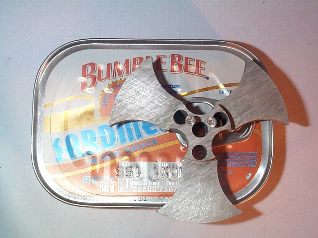

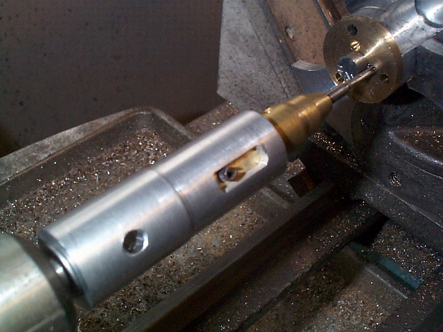

First one is my clunky taping gizmo, spot, drill, tap. Its lightly spring loaded so, you get the picture.

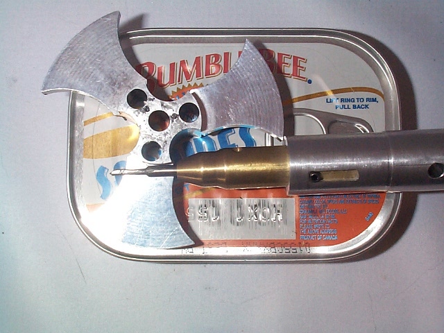

Second one is broken tap Blah
Third is tada,  all better now
