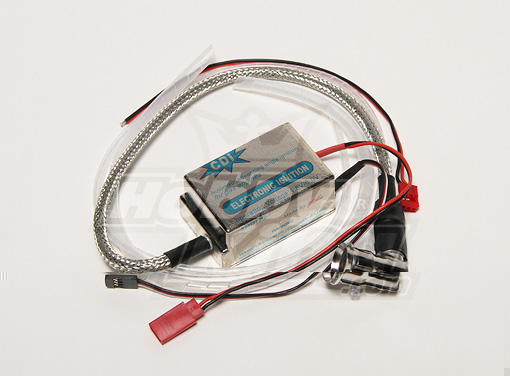

How about one of these, cheap simple and I think they do them for more cylinders as well.
peter
http://www.hobbyking.com/hobbyking/store/uh_viewItem.asp?idProduct=10996
http://www.hobbyking.com/hobbyking/store/uh_viewItem.asp?idProduct=9906

Yeah you're right John, I don't think it'd be a simple task to modify it. It'd have to be hidden away under a box I think too, don't think it'd look pretty.
Peter, the point of this is, it is self sufficient i.e. doesn't need anything else to make it run other than fuel and authentic!

It was realy just to see if it would help madjackghengis from the post above mine. I prefer the mag as well for older engines, but some members also build more modern engines as well.
