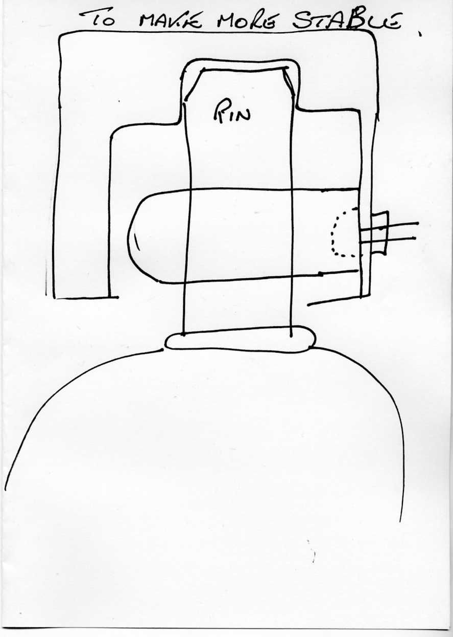

A couple of suggestions on using a hole saw.  For a neat clean hole without destroying the painted surface start the hole saw from the painted side but stop just after the teeth of the saw mark a full circle.  Withdraw the saw and re-insert the pilot bit from the reverse side and proceed to cut the hole.  The result will be a clean hole on both sides without the normal "tear out" and the swarf will not be harming the surface.  This tip is especially useful when hole sawing wood.
When cutting a hole in a thick piece of material again pierce the material with the pilot drill and cut just enough to mark the perimeter of the saws kerf.  Once the kerf is clearly defined stop the saw and withdraw it from the work.  Drill a "chip relief hole" just inside the outer kerf mark.  Make the relief hole so that its circumference is tangent to the outer edge of the kerf mark.  The idea is to give the swarf an exit when sawing through rather than filling the tooth gullets and plugging the saw.
Also be sure to use plenty of lube/coolant that is appropriate for the type of metal being cut.
I hope the sketch makes sense.  Using the drawing function in a word processor is rather limited.

Nice tips there Roger, I have another to do yet, and prob more after and will take note of what you said, ta.... :thumbup:

I like the idea you started with, but maybe modified a bit.  I'll PM you a quick .jpg of a part I whipped up.   Top is threaded, so you can use nuts and washers to sandwich a wire or ring terminal.  Feel free to post or use at your discretion.
Edit, nevermind, I'll find a host and post the pic.  Give me a minute.
Edit again, my spellink stinks!
« Last Edit: January 15, 2009, 08:33:42 PM by rleete »
Offline rleete
  • Posts: 552
Re: Valve Base
« Reply #43 on: January 15, 2009, 08:32:23 PM »
Something like this?  Sorta what you have, but without the taper on the inside, and a sliding fit.  Adjust to make good connection by squeezing the prongs together.  Maybe use some contact grease or Artic Silver (stuff to give good contact on computer CPU heat sinks)?

OK that is something similar to what would have been used originally,
I'll see if I can sort a pic, depends if I can find sumut in the den  :lol:

Looks like I just reinvented the wheel, then.  I'm assuming the outer profile of the insulator doesn't matter, just whatever appeals to you.  You ought to be able to machine that up, and so the looks of the connector part aren't so important, just the function.

Darren,
Might be a stupid idea, but could you use terry clips.
C-o-C attached
The heat resistant insulation might be the problem.
« Last Edit: January 16, 2009, 01:14:55 AM by bogstandard »

How about a Plug cap (mini spark plug) cut down if need be and the internals of one of the ceramic caps.

Thanks Guys I'm working on something this evening, not ready to show just yet though.
John,
I've seen those clips on the market stall and did give them some consideration.
I have to think about safety foremost but almost as important is the finished looks.
Apart from that I'd like to make something myself, after all, it what we have these tools for init  :thumbup:
