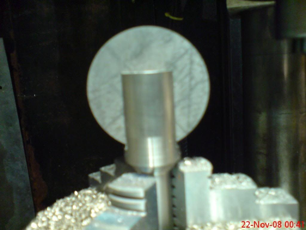

Tonights (well this mornings too!!) offering...... The start of the cutting tool to make the die.
To start with, a piece of 1/2" gauge plate (from an anonymous benefactor  :wave: ) is cut into an approx 55mm square (approx because it was cut with a hacksaw!) This photo taken on a break 'cause I was knackered!!!... Supprised it's not blurred with the heavy breathing going on!
http://i289.photobucket.com/albums/ll221/dividedhead/Herons%20Wind%20ball/DSC02492.jpgHeron's Aeolipile
A hole was then drilled through the centre to allow the use of an arbour (8mm with an M8 thread on the end).
http://i289.photobucket.com/albums/ll221/dividedhead/Herons%20Wind%20ball/DSC02496.jpgHeron's Aeolipile
Once all that was done the corners were removed with the hacksaw and then the turning to exact size could begin.
http://i289.photobucket.com/albums/ll221/dividedhead/Herons%20Wind%20ball/DSC02497.jpgHeron's Aeolipile
The blank is left at 51mm dia' to be sized correctly in the next step.
http://i289.photobucket.com/albums/ll221/dividedhead/Herons%20Wind%20ball/DSC02499.jpgHeron's Aeolipile
The compound slide is then altered to 3' (from here on ' is the symbol for degrees). The blank is now turned to size using the compound to create the cutting angle required.
http://i289.photobucket.com/albums/ll221/dividedhead/Herons%20Wind%20ball/DSC02500.jpgHeron's Aeolipile
http://i289.photobucket.com/albums/ll221/dividedhead/Herons%20Wind%20ball/DSC02503.jpgHeron's Aeolipile

Any comments like "there is a much easier way" will not be taken totally to heart.... I'm happy so far  :D
Ralph.

http://i289.photobucket.com/albums/ll221/dividedhead/Herons%20Wind%20ball/DSC02546.jpgHeron's Aeolipile
Then the fun starts.... The first step, increnmental cuts were taken, to rough out the shape of the dome required.
http://i289.photobucket.com/albums/ll221/dividedhead/Herons%20Wind%20ball/DSC02548.jpgHeron's Aeolipile
Then the form tool (held in a QCTP holder) was used to create the final shape.
