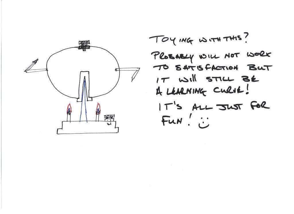

I think Ralph is going to use a single bearing due to the burner having to go at the bottom.
This is not entirely correct at the mo' John.... I'm toying with a spike right up it !!!  :bugeye:
I'm just trying it to see how it reacts? You got to try the silly simple stuff first and work your way up to super complex ehh?
Your idea Stew is not a hundred miles off from what I'm going to try first.... I'm just not going to employ a ball bearing at this time  :)
Something like this.... Oh and I got a pirate version of Crap 'o' Cad from the pound shop today  :lol:  (it comes in Quad colour.... Just decided not to use the green  :headbang: )
http://i289.photobucket.com/albums/ll221/dividedhead/Crap-o-Cad/img069.jpgHeron's Aeolipile
Still pretty crappy in the hands of an unskilled artist though!!  ::)  The jets will look very different in reality!!
Stew, your C-o-C's are still welcomed, They may inspire another approach?
To everyone who contributes and adds their opinions, thank you for taking the time to think about my workings.... It all helps. What I or someone does not use on todays project will certainly be useful in next weeks or even one next year!   :thumbup:
I'm taking everything on board.... I've just got to put it into practice!
Ralph.

Ralph
One suggestion. Move the jets to the upper part of the sphere so there is room for steam accumulation and more available water. A pair of bearings in be base will be a bit more stable as well.

« Reply #127 on: January 21, 2009, 02:18:43 PM »
I don't see why the spike method wouldn't work.  The old style tire balancers used a similar method.
Point the jets up slightly to keep it planted, or it might just take off on ya.  I doubt a steam filled metal ball sailing around the room would do the decor much good!

Steve... "The jets will look very different in reality!! " I should have said "this drawing is as crap as it gets and they were only added for effect!!"  The idea is still to emulate the Karsten design a little in that area  :)
I think he hit the nail well and truly on the head with his designs... I'm just trying to make some fun things as gifts etc   :thumbup:
There is no problem with Stews suggestion, I'm just working my way through the ways and means... I want to know I've tried all the aproaches I can think of, as well as those that others have already made (clearly they work!)

« Reply #130 on: January 21, 2009, 07:09:56 PM »
Ralph,
Piddle on time. :(
Your single point bearing system, I think, will cause you a few sleepless nights. :bang:
That method is OK if you use one at either end of the ball. Having one point bearing will mean you will have to have it perfectly balanced to prevent oscillations and so large amounts of friction. Especially as you will be using a very unstable medium ie boiling water, that just cannot be balanced due to the formation of differing sizes of bubbles.
I have done a C-o-C to show what I originally thought you were going to do.

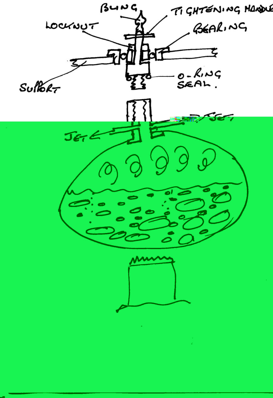

Ralph,
They didn't get my pass word. What ISP does is not let you in to your site. They send you a new pass word to get in and then you change it to what you want. It was for security reasons. I'm back running again. Still need to clear up one issue and then I'll be all set.
Ok, now on to my suggestions. After looking at that last C-o-C of yours I figured that ball won't probably run very good on a pivot such as you had drawn. Here's my idea I'd like to enter for your brain to think about.
On a shaft mount two bearings make sure the shaft is about 3/4 the length of the ball dia. :scratch: I'm sure you got that, but just incase. Let's say the ball is 2" in dia. you would make the shaft 1.75" long to mount the ball bearings on.
Now comes the part about making it look "pretty", at least I think so. I have done this type of work(?) since I was very young and enjoy it very much. It's called "fret work". I believe it acutally started in the UK eons ago. Here's a link to better understand what's involved:  Fret Work
And here's some of the work I've done. It's a piece of wood 1/8" thick X 2.5" wide X 3.375" long. Bascially you glue a pattern on the wood and cut it out. Same can be done with 1/8" thick metal (brass, copper,etc.).
And here's an example C-o-C of what I envision for a Heron's Aeolipile"
Of course you could make it a lot fancier than my C-o-C, but you get the idea.
So that's my input to your project of a Aeoipile.

Hi Ralph
Looks like I've got this scanning thing sorted. :thumbup:
Idea 1:  Not to good as it'l get in the way of the flame.
http://i431.photobucket.com/albums/qq32/sbwhart/sc00008ce1.jpgHeron's Aeolipile
Whoops the B****rs upside down      :lol:
Idea 2:  Same as John's idea but my C-o-C is more artistic.
http://i431.photobucket.com/albums/qq32/sbwhart/sc0000cca1.jpgHeron's Aeolipile
Idea 3:  Uses picture frame wire and a fishing swivel as used on lures  (spinners)
http://i431.photobucket.com/albums/qq32/sbwhart/sc0000ef45.jpgHeron's Aeolipile

Ok, I think I have enough to run with?! Well there's plenty of things to try anyway... That'll keep me busy for months  :D
Bernd.... Holy fretwork batman!!!! :jaw:   That site is quite astounding.... I am not sure of my patience levels meeting that kind of requirement!   :scratch:
The bearing idea is one to think about... And I have had a little help from elsewhere too  :thumbup:
Stew,
The upsidedown version would be quite interesting... How would I get the flames to travel down and the water to stay at the top?  :lol:
The string is definately out! too easy!
The bearing over version is one that I saw a long time ago when I first started looking into this toy (bout 2.5 years ago!) I'm just trying not to copy it... Even though it is probably the best solution?!
I saw your other post on the metals.... The goblet should be used.... Should be fun  :)  Give it a go, it has every chance of turning out to be a nice piece?  :dremel:
