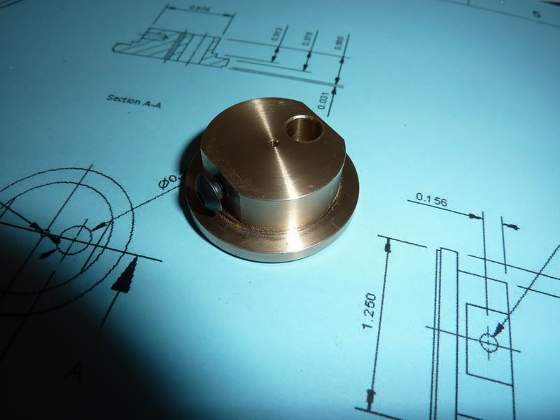

Well, I finally got a little bit of motivation and got in the garage to cut some metal tonight!
A slightly frustrating night but it has yielded 1 component - I started off collecting some materials together but then got bored of that so started turning the bottom displacer cover or hot plate as I've called it on my drawings. I quickly realised that because of the thin register I need to turn that and part it off a longer piece of stock. I have some cast gunmetal that I'm using. The slither that I had planned to use has now ended up as the flywheel! This means I've already deviated from my drawings, when I felt the weight of the aluminium I'd planned to use for the flywheel I thought it was too light, so I thought I'd use the cast gunmetal and thicken it up by 1/16" to 1/4" thick. The diameter has ended up as 1.22" or something rather than the 1.5" I had originally planned. Actually, this now seems a bit heavier than I thought so may have to do the ally  one after all but maybe keep the 1/4" thickness, then it might be heavy enough.
Anyway, here it is:
http://img.photobucket.com/albums/v287/NickG24/Tiny%20Stirling/2010-12-0323-46-56_0001.jpgTiny Stirling Engine
The cake is 2nd hand, my 2 year old son licks the icing off but he didn't do a very good job on this one so waste not want not!
http://img.photobucket.com/albums/v287/NickG24/Tiny%20Stirling/2010-12-0323-47-33_0002.jpgTiny Stirling Engine
Feel a bit disappointed that that's all I managed in a night but at least it's done. As I said, it deviates from the drawing in size and material. I couldn't be bothered to find  / change tools etc either so the recess isn't quite right. I think I will modify the drawing just to widen the alloy flywheel. Unless this one works then I'll change it to brass. The plan is just to loctite it to the crankshaft - just easier for this little engine, it'll have no power so won't come loose.
This is probably the 2nd most complex part on the engine so at least it's a start.
Nick
Re: Tiny Stirling Engine
« Reply #36 on: December 04, 2010, 03:41:26 AM »
That looks good Nick.Yer off to a good start. Despite the material decisions/ recycling.  :thumbup:
You are tougher than me..... I've managed 3off, 20 minute sessions this past week. Before the fingers gave up.  ::)
Angle grinding yesterday. REALLY didn't need the extra cooling draught it produced......  :bang:

http://img.photobucket.com/albums/v287/NickG24/Tiny%20Stirling/2010-12-0700-16-05_0001.jpgTiny Stirling Engine

Nick,
Sorry, I replied to your post over on HMEM.
I gave a few pointers that might help.

Hi Nick, I'm keeping an eye on this one, the tiny ones are the hardest to get running, as the friction and power come closer to each other from opposite directions.  With regard to the nylon, your biggest issue is mass, and if you can counter balance the mass of that displacer, the power piston only has to make it change direction, not lift it, so it's a matter of inertia rather than sheer power.  If it's too heavy, you can drill many holes in it, and cover them with plastic film glued on.  Moving the displacer is necessary, but it is the big energy drain the power piston has to provide for.  I keep thinking of a well with two buckets and a rope so you only lift the water and not the weight of the bucket, and thinking about two tiny engines, with their displacers out 180 degrees and with the cranks connected, so all the parts counter balance each other.  I'm really hoping you get this little engine running, it ought to, for your dad.  :poke:  by the way, what is "cold" there?  I'm feeling it here, and it's 25 degrees F.   :bugeye:  On the car, I hope the engine swap goes well for you, and you find a warm day somewheres along the way, I know I don't look forward to engine swaps any more.  That engine sounds like it has too many parts for its own good, all in all.  mad jack

Thanks for the advice John / Madjack - I will have another look around for more suitable displacer material. I think I might have some balsa wood round at dads - can't imagine it machining well!
John mentioned exactly the same over on HMEM. I was planning on putting a counter balance on the flywheel but as you say, this could make the moment of inertia too high - funnily enough I had just sketched the bucket scenario, you also have the power piston which is 90 deg out but that is pretty light. If I can't find anything else easily, skimming a bit off, drilling a load of holes and sealing with some film seems a good idea though.
