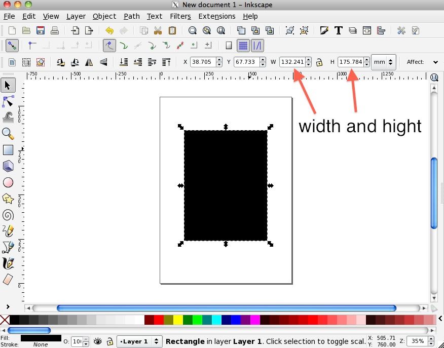

As requested by John I will try to show you how I made the front panel
First you will need to measure your panel hight and width

Inkscape is a free Open Source vector graphics editor, with capabilities similar to Illustrator, CorelDraw, or Xara X

Click the "box / rectangle tool" and in the white rectangle which represents your sheet of A4 paper
Click and drag to draw a rectangle
Size is unimportant but be aware that anything outside of the A4 area will not be printed
You should now have something like this before you go any further right click on the box you just drew and select "fill and stroke"

Now we can size the box If your box is not selected use the select and transform tool and then click on your box
Now we need to change the measurements from pixels to mm or inches what ever you are using
click the green arrow
http://i602.photobucket.com/albums/tt102/ja2onx/124.jpgAnother 4" CNC rotary table
And select the mm option
http://i602.photobucket.com/albums/tt102/ja2onx/Screenshot2010-10-22at131657.jpgAnother 4" CNC rotary table
You wil now probably have to select your box again then you can change the size by typing in your own dimensions in the arrowed boxes
http://i602.photobucket.com/albums/tt102/ja2onx/Screenshot2010-10-22at131730.jpgAnother 4" CNC rotary table
This black box will be our guide so if it is the correct size save your work and continue
Next draw a rectangle using the box/rectangle tool roughly to the shape shown below
While it is still selected pick a colour from the bar at the bottom pick a colour you can find again
as we need to make four boxes the same colour
