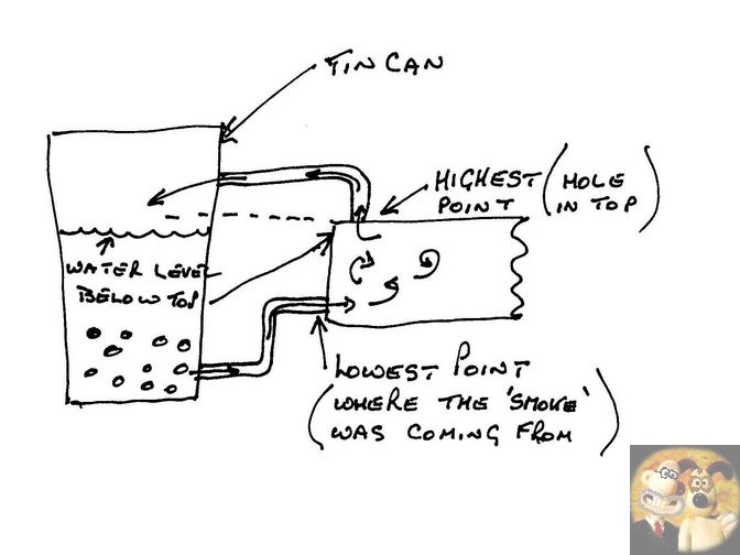

David,
I don't know much about this type of Stirling engine, but could you rig up an external 'tin can' radiator to keep it well supplied with cooling water. It could be a semi sealed system, with only the tin can having an open top.
The circulation should be automatic, by convection.
I have shown the water level as being below the top plate, but if it didn't caused any internal engine leaks, it could be above.
« Last Edit: November 11, 2010, 02:41:41 AM by bogstandard »

Thanks for all your comments Chaps!  :thumbup:
Stripped it again, this afternoon.
The only problem with a forum, your failures are public, as well as occasional triumphs.  :doh:
John, that is the way I intend to cool it. When/ if I get it sorted......   ::)
