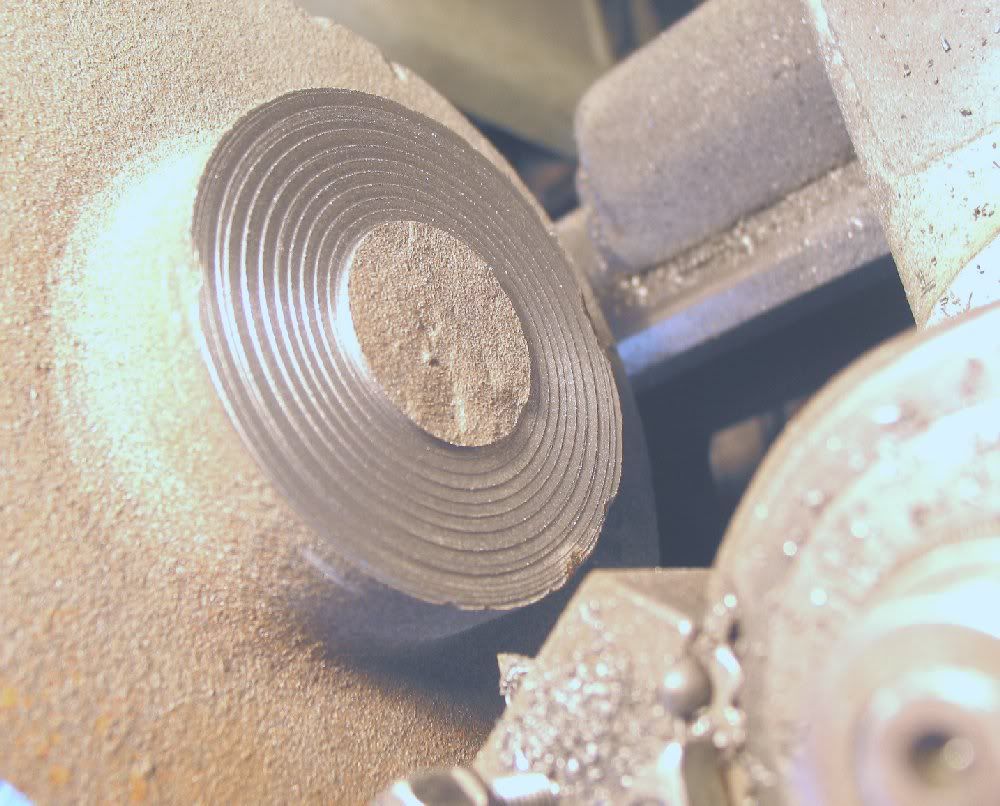

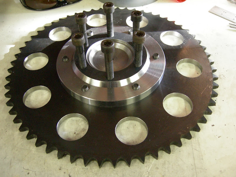

I have to do those size holes and bigger on daily basis but mostly in aluminium which has numerous disadvantages.
If you can get the job in a 4 jaw on lathe drill or open up as much as you can, my instance is a 28mm because largest available in MT3.
I then open up by boring out, heres a something simple 130mm o/d with 42.2mm bore.
http://pic20.picturetrail.com/VOL15/728921/1252422/311844089.jpg
Removing 1/2" facing off one pass http://pic20.picturetrail.com/VOL15/728921/1252422/14582043.jpg
Showing 42.2mm bore x 15 deep http://pic20.picturetrail.com/VOL15/728921/1252422/14584596.jpg
I can fill a wheelie bin with swarf within an hour next alum will be free cutting with small chips.
Hole saws are used to originally put the main 6 holes in http://pic20.picturetrail.com/VOL15/728921/1252422/14584660.jpg without centre drill.
Then bored out individually on rotary table, easy done well over 500 over the years.
In your case hole saws waste of time, drill and bore out which will take an eternity on such a small lathe.
Your boring bars will be flexing i have brand new unused from that place, totally worthless. No substitute for quality robust tooling ala Kennametal, Iscar Ceratizit, etc Could get away with the cheap brazed 1/2" round shank such as http://cgi.ebay.co.uk/RDG-CARBIDE-BORING-BAR-SET-1-2-12PC-SET-BORING-HEAD-/370142246041?pt=UK_Home_Garden_PowerTools_SM&hash=item562e327499  May take a couple of hours per hole though but no alternative.
