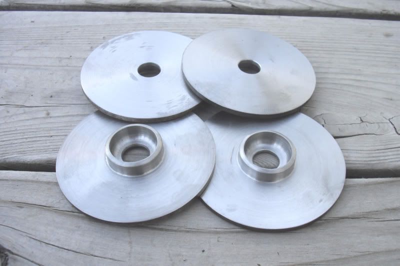

« Reply #54 on: September 26, 2010, 09:21:28 PM »
Today I managed to get all the lathe work done on the endcaps for my pedals. I am happy with how they turned out.
http://img.photobucket.com/albums/v652/Powderkeg3418/Penny%20Farthing/Pennyfarthing049.jpgPenny Farthing Bicycle
I've been making parts for my new shaper. I should be able to finish the endcaps this next weekend. If I can stay with it. There is still a fair amount of metal to come of  he endcaps. the centers will need to be case hardened also. I'll have an excuse to use my heat treat oven\o/
Wes :wave:

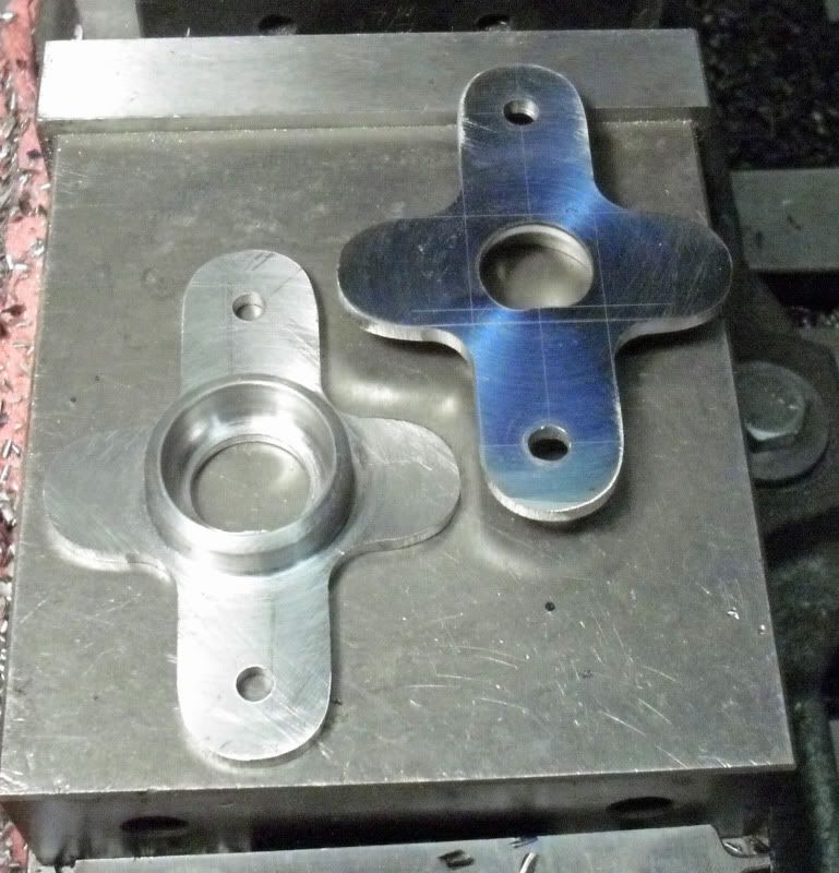

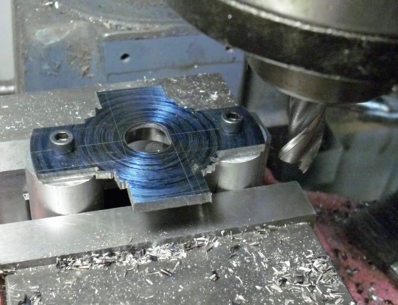

« Reply #59 on: November 19, 2010, 07:52:15 PM »
More progress today\o/ I finished laying out some more lines.
http://img.photobucket.com/albums/v652/Powderkeg3418/Penny%20Farthing/Pennyfarthing017-1.jpgPenny Farthing Bicycle
The parts had some metal removed with the band saw.
http://img.photobucket.com/albums/v652/Powderkeg3418/Penny%20Farthing/Pennyfarthing018-1.jpgPenny Farthing Bicycle
I turned some jigs so I could hold the caps in my mill. Pretty simple stuff.
http://img.photobucket.com/albums/v652/Powderkeg3418/Penny%20Farthing/Pennyfarthing019-1.jpgPenny Farthing Bicycle
The jigs hold the part above the jaws really nicely.
http://img.photobucket.com/albums/v652/Powderkeg3418/Penny%20Farthing/Pennyfarthing020-1.jpgPenny Farthing Bicycle
After Milling I used my belt sander to round the ends.
http://img.photobucket.com/albums/v652/Powderkeg3418/Penny%20Farthing/Pennyfarthing021-1.jpgPenny Farthing Bicycle
One set of pedal end caps nearly finished. I'll finish sanding them tomorrow.
http://img.photobucket.com/albums/v652/Powderkeg3418/Penny%20Farthing/Pennyfarthing022-1.jpgPenny Farthing Bicycle
I still have to drill and tap the holes that hold the pedal rubber to size. I'll get this tomorrow also. Yeah, The pedals are almost done!!!
Wesley P
