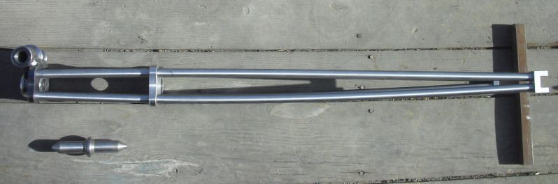

Ok, I've been putting off building the jigs for the forks because I had way over engineered them. I had all kinds of welding and machining involved. The other night while on the crapper It came to me:o) I couldn't believe It would be so simple.
I laid out the spacer I had made earlier for the fork ends and drilled and tapped it.
http://img.photobucket.com/albums/v652/Powderkeg3418/Penny%20Farthing/PennyFarthing151.jpgPenny Farthing Bicycle
Then using the all thread that I used to hold the forks while welding. I bolted the whole lot together.
http://img.photobucket.com/albums/v652/Powderkeg3418/Penny%20Farthing/PennyFarthing152.jpgPenny Farthing Bicycle
http://img.photobucket.com/albums/v652/Powderkeg3418/Penny%20Farthing/PennyFarthing153.jpgPenny Farthing Bicycle
I have something similar planned for the front forks. It will be a little more complex though.
~Wes~
Wesley P

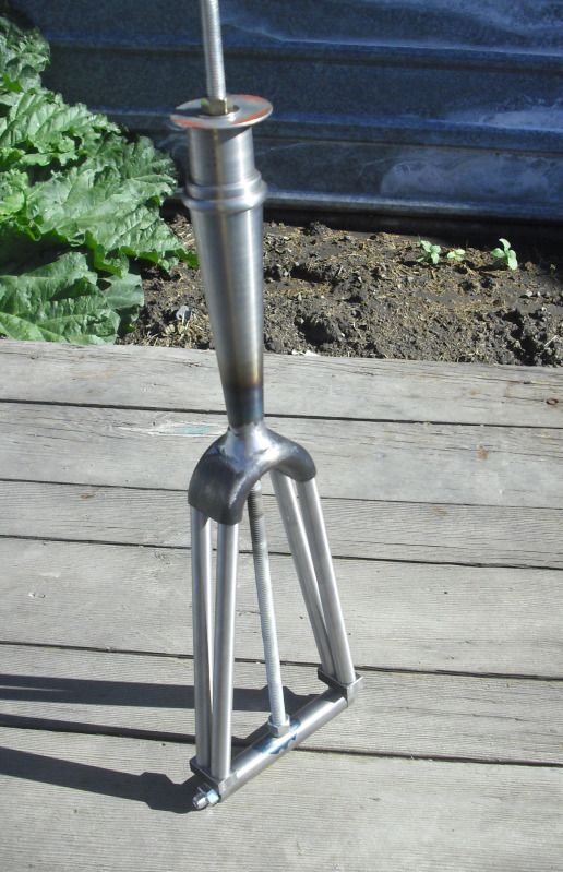

I had to file the holes just a little to get the tubes to fit into their holes. I think a little more and it'll fall together:o) The bottom plate has to come up a little so the legs will spread far enough to fit the jig.
http://img.photobucket.com/albums/v652/Powderkeg3418/Penny%20Farthing/PennyFarthing154.jpgPenny Farthing Bicycle
Here is a side view.
http://img.photobucket.com/albums/v652/Powderkeg3418/Penny%20Farthing/PennyFarthing155.jpgPenny Farthing Bicycle
And a couple other views. I know how everyone likes pictures:o)
http://img.photobucket.com/albums/v652/Powderkeg3418/Penny%20Farthing/PennyFarthing156.jpgPenny Farthing Bicycle
http://img.photobucket.com/albums/v652/Powderkeg3418/Penny%20Farthing/PennyFarthing157.jpgPenny Farthing Bicycle
I need to ever so slightly bend the tube. I'll probably do it in my press. I need a way to make it repeatable. Maybe a couple spacers?

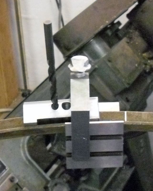

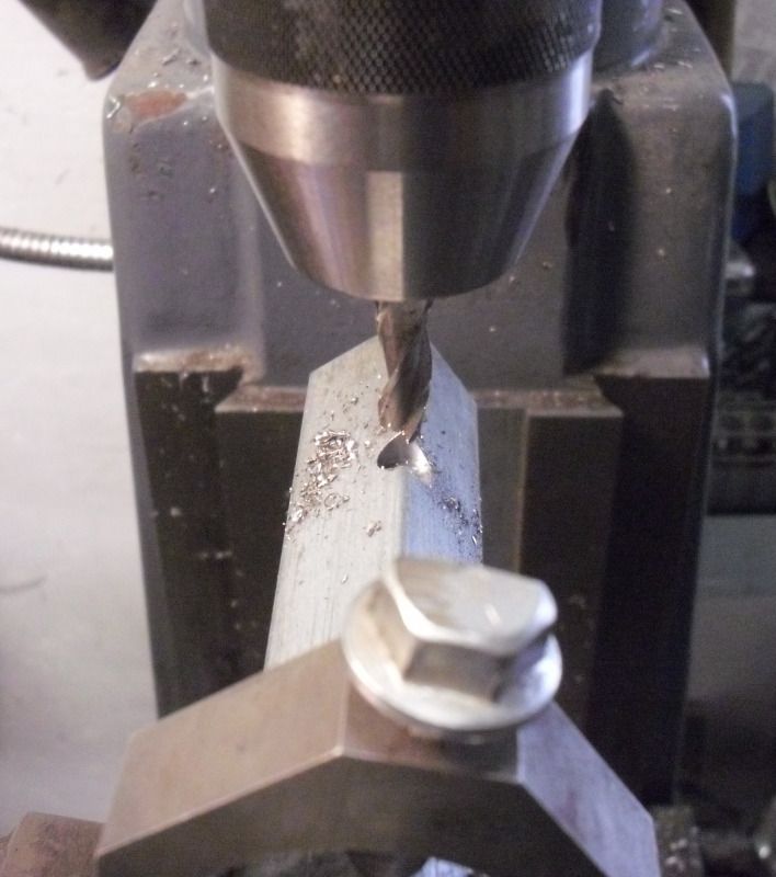

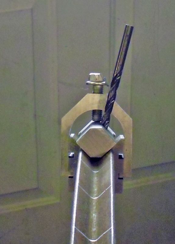

I'm building a little drill jig to guide the drill bit when I drill my spoke holes in the rim. I am using some square stock. I held it in a V-block in my angle vise to drill the guide holes. I am compromising a little on the jig. For the big wheel the angle is about 2 degrees more than needed and for the small wheel it is about 2 degrees less  than needed. There should be enough play in everything to make up the difference. Here I am centering the stock below the spindle of my mill.
http://img.photobucket.com/albums/v652/Powderkeg3418/Penny%20Farthing/PennyFarthing158.jpgPenny Farthing Bicycle
To drill the hole I need a flat spot so the hole will start accurately. I mill a small flat, then center drill and drill it.
http://img.photobucket.com/albums/v652/Powderkeg3418/Penny%20Farthing/PennyFarthing159.jpgPenny Farthing Bicycle
I then mill a little bit of relief in the middle of the guide. This way it can clamp down squarely and not rock. I do this on two sides.
http://img.photobucket.com/albums/v652/Powderkeg3418/Penny%20Farthing/PennyFarthing160.jpgPenny Farthing Bicycle
Here it is clamped to the rim. I can peek down the hole and align the guide with my mark then clamp it into place. The holes should all be crooked by the same amount:o)
http://img.photobucket.com/albums/v652/Powderkeg3418/Penny%20Farthing/PennyFarthing161.jpgPenny Farthing Bicycle
