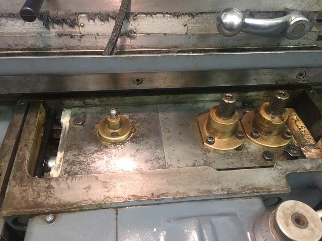

Front of the table. The lever to the right with the arrow behind has yet to reveal it's function, just like that flat screw sticking out of the dust cover..
Beneath the table

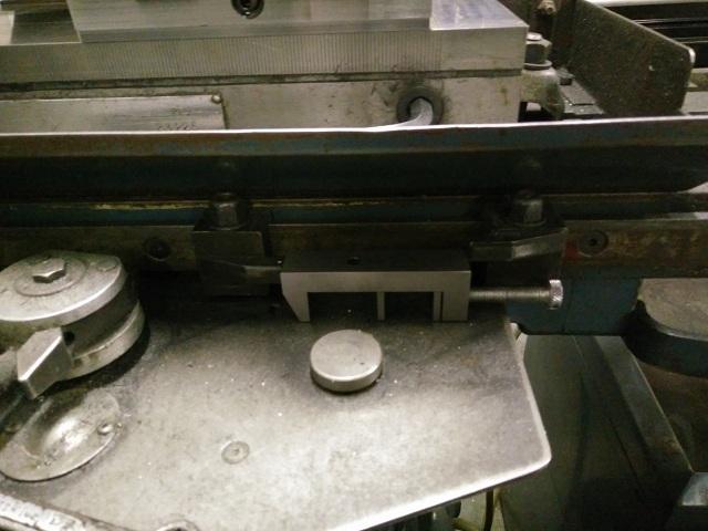

Locking of Y-axis, and end stops for feed. I assume the square headed bolts are the ones that have to be loosened to allow me to swing the table
A bit more concerning was the Z-axis. The end stop brackets are missing, and even worse, the Z-axis movement lock was also engaged - god knows how long it has been like that. It sure didn't make any difference to the force required to turn the Z-axis handle...

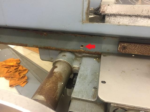

Afterwards I began to clean and inspect the table. I had noticed a strange looking M8 screw with two washers sticking out of the rubber way-cover of the Y axis, so I removed the cover to see what it was..
It seems to be the adjusting screw for the slack in the ways, which has had a shim mounted behind it. Not really shocking on a near 40 year old machine..

Newt up was the vertical spindle quill, which had bothered me from day one. As it was, there were no handles for moving the quill, the fine feed didn't work at all and the retracting spring was not engaged.
I don't have an instruction manual, so I just started at one point and began disassembling things..
Removed the retention washer and the dial scale
Slowly I seemed to get to the core of things. I also removed the bearing nut and the bearing, but ended in a hole cut in the casing and was not able to pull the shaft out this way..
To access the shaft from the back, I tried to tilt the head, but with no success :bang:
Then I decided to try disassembling the main shaft, so started removing things
Had to pull this of the shaft
Afterwards I found out that what I had just pulled of, contained the spring mechanism
Without beeing able to make progress on that side, I started on the other. But before I could pull anything of the shaft, I had to grind down the nasty edges from when people have used the quill with a simple screwdriver
Then it was just a matter of loosening a set screw and pulling it of
A new rusty shaft revealed itself
Removed the mountig bolts
And took it of
Still wanting to remove the main shaft, I tried to get the key out, but it sat in a key way which was perfectly sized for it, seeming to have a slight press fit. I tried heating the shaft with a heat gun, and cooling the key with some snow from outdoors, but no success
After several attempts, uncluding wise grips and hammers, the key looked quite bad
I reckoned I wasn't going to use it any more when looking that bad, so I figured I'd be a bit untraditional..
After having messed up bearing surfaces on previous projects, I was carefull to where I placed the grounding
Welded some spots and let it cool
A bit more welding and some minutes later, it loosened :beer:
It seems to also have rusted in it's key way, which obviously didn't make it any easier to remove..
I then tried to pull the shaft out, but soon figured it was stuck by the tooth rack on the back of the quill, so I lowered the quill as much as I dared, without having it fall out, and pulled the shaft out :)
The only thing left inside the bore now, is the worm-gear for the fine feed
The disassembled parts
I figured I wasn't going to be able to get the fine feed shaft out without removing the head from the machine, so I started repairing things instead. The spring mechanism was first out, and as you can see, the part which is supposed to transfer the forces to the shaft, was laying too far to the left
So I made some aluminium shims, and pryed them into place
I ended up using three shims before I was satisfied with the result
Here's the counterpart where the spring is supposed to hold
After having had some tea and some time to think, i finally understood how the fine feed is engaged. It's all in the mechanism on the shaft of the rapid feed handle
This shaft transferrs the forces from the rapid feed handle to the shaft. But if it is pushed inwards, the claw mechanism engages to the worm gear from the fine feed. So all in all, I had only needed to disassemble these few parts, clean them of rust and dirt, and put them back together again :poke:
Here you see the worm-gear counterpart
When I get a new key, I'll be able to assemble the whole lot again. That is, if I remember where all the pieces go :lol:
