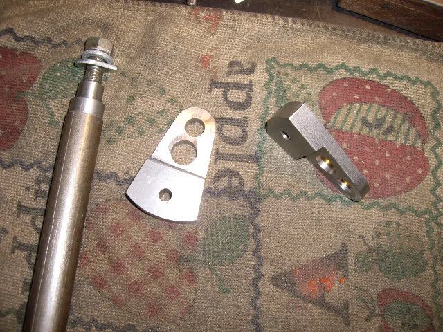

Well, my good friend and mentor George, who finished his appreticeship before I was born, stopped by yesterday, and we had a nice chat, considering whether to start fresh on the crank cheeks, or do something.  I figured out I looked up the right drill to precede the reamer, but pulled the wrong one out of the index, and that was why the crankpin hole was nasty and oversized.  As usual, George was practical and decisive, and told me, were it him, he'd put the block back in the vise, square it up nice an do a minimum boring with a boring head, since there is plenty of room between the finished bored holes at 0.382, and the crank pin o.d. of 0.562, and I decided if it was good enough for George, who was I to question it.
http://i894.photobucket.com/albums/ac150/madjackghengis/IMGP0763.jpga nine cylinder radial engine, plans by "ageless engines"
After boring, cutting the cheeks down to size on my shaper, breathing in the glorious fumes of dark, sulferated, lard cutting oil.
http://i894.photobucket.com/albums/ac150/madjackghengis/IMGP0764.jpga nine cylinder radial engine, plans by "ageless engines"
Making smoke, and hot blue chips flying, you've got to love a shaper :clap:
http://i894.photobucket.com/albums/ac150/madjackghengis/IMGP0762.jpga nine cylinder radial engine, plans by "ageless engines"
cutting the other side, centering the holes.
http://i894.photobucket.com/albums/ac150/madjackghengis/IMGP0767.jpga nine cylinder radial engine, plans by "ageless engines"
Partially finished cheeks, ready for more operations
http://i894.photobucket.com/albums/ac150/madjackghengis/IMGP0766.jpga nine cylinder radial engine, plans by "ageless engines"
Another view of the cheeks, showing the steps.

cutting the retangular blocks to put a taper on both sides, lightening the crankpin end, and leaving the counter weight end heavy
http://i894.photobucket.com/albums/ac150/madjackghengis/IMGP0768.jpga nine cylinder radial engine, plans by "ageless engines"
another picture with the cheeks in the shaper vise and the sweet aroma of black sulferated lard cutting oil smoke
http://i894.photobucket.com/albums/ac150/madjackghengis/IMGP0772.jpga nine cylinder radial engine, plans by "ageless engines"
having made a stub arbor for them, turning the radius on the counter weights on the lathe
http://i894.photobucket.com/albums/ac150/madjackghengis/IMGP0776.jpga nine cylinder radial engine, plans by "ageless engines"
Cheeks finished, with the radius on the crank pin end rough ground, and then finished with a hand file to a good looking contour
http://i894.photobucket.com/albums/ac150/madjackghengis/IMGP0778.jpga nine cylinder radial engine, plans by "ageless engines"
the cheeks with the stub arbor used for the radius
http://i894.photobucket.com/albums/ac150/madjackghengis/IMGP0780.jpga nine cylinder radial engine, plans by "ageless engines"
The front cheek with the prop shaft pressed in place with half a thousandth press fit, and loctite 609
http://i894.photobucket.com/albums/ac150/madjackghengis/IMGP0782.jpga nine cylinder radial engine, plans by "ageless engines"
another shot, and showing the rear cheek, waiting for its shaft to be made and fit.  Once the shaft is finished, assembled, the rear bearing turned, then disassembled, then on to the master connecting rod.  Hopefully I can get the two shafts finished, and all oil passages drilled, and start on that rod soon.  Good day all, mad jack :beer: :coffee:
