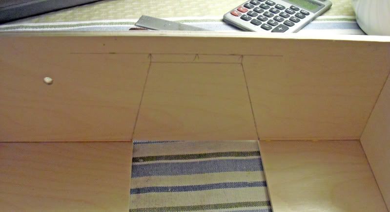

Offline Powder Keg
  • Posts: 932
  • Machinist Extraordinaire
Re: Hand Cranked Organ winter project
« Reply #55 on: April 03, 2011, 11:47:18 PM »
I spent a while longer double checking the changes I made. I would like this to work good when done. The pieces were cut out of 1/8" and 1/4" plywood that is finished on both sides. I had to special order it. No one in town carries this kind of stuff. There were a couple of holes that I drilled before I glued things together, per the instructions. I then began gluing the pressure box together. The hump in the middle still needs to be cut out and glued in. These dimensions were missing in the plans. I'll just measure what I have and make them to fit. I have some small bits that still need cut out and fitted. I'll work on it after work tomorrow. I'm hooked again :zap: :ddb: :zap:
http://img.photobucket.com/albums/v652/Powderkeg3418/Hand%20cranked%20organ/Pressurebox001.jpgHand Cranked Organ winter project
Here you can see where I marked where the hump will be.
http://img.photobucket.com/albums/v652/Powderkeg3418/Hand%20cranked%20organ/Pressurebox002.jpgHand Cranked Organ winter project
More later :ddb: :ddb: :ddb:

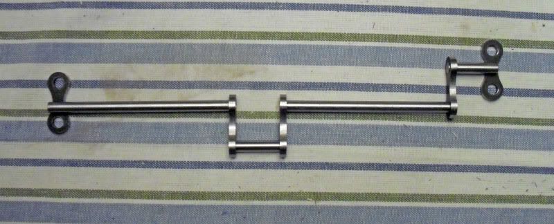

« Reply #58 on: April 05, 2011, 12:15:42 AM »
Tonight I cut out the rest of the pieces for the crankshaft. I need to make the drive roller. Then I can silver solder all the pieces together.
http://img.photobucket.com/albums/v652/Powderkeg3418/Hand%20cranked%20organ/Crankshaft002.jpgHand Cranked Organ winter project
Wes :wave:

Tonight I made a little crank holder. I need to hold things straight while I silver solder the pieces of the crank together. We don't want a wonky crank. LOL
I also cut out a couple of little blocks of wood that will be the bearings for the crank shaft. I'll get a couple pictures when I get them a little farther along. No one wants to look at pictures of little blocks of wood do they? Well, some here might. :lol: :lol: :lol:

I started to solder stuff together today. It started good and ended bad.
http://img.photobucket.com/albums/v652/Powderkeg3418/Hand%20cranked%20organ/Handcrank003.jpgHand Cranked Organ winter project
http://img.photobucket.com/albums/v652/Powderkeg3418/Hand%20cranked%20organ/Handcrank004.jpgHand Cranked Organ winter project
Looks like I need some more practice. Good thing I machined a couple extra crank arms while I was up to it.
Wes:o(

« Reply #69 on: April 16, 2011, 03:59:03 PM »
Second time was a go\o/
http://img.photobucket.com/albums/v652/Powderkeg3418/Hand%20cranked%20organ/Handcrank005.jpgHand Cranked Organ winter project
Now I need to drill a hole in the bushing and cross drill it for a setscrew.
