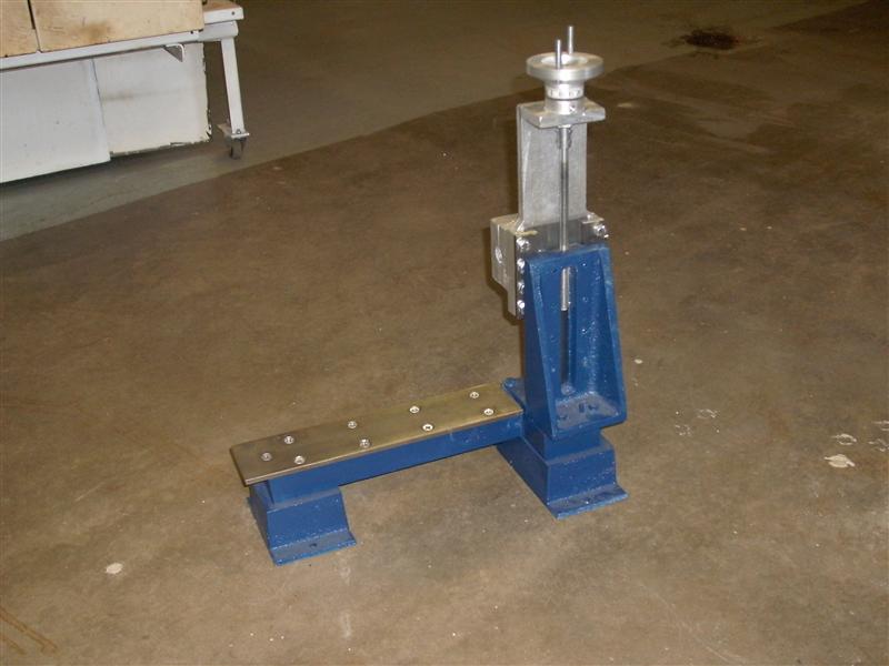

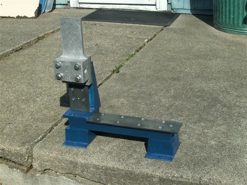

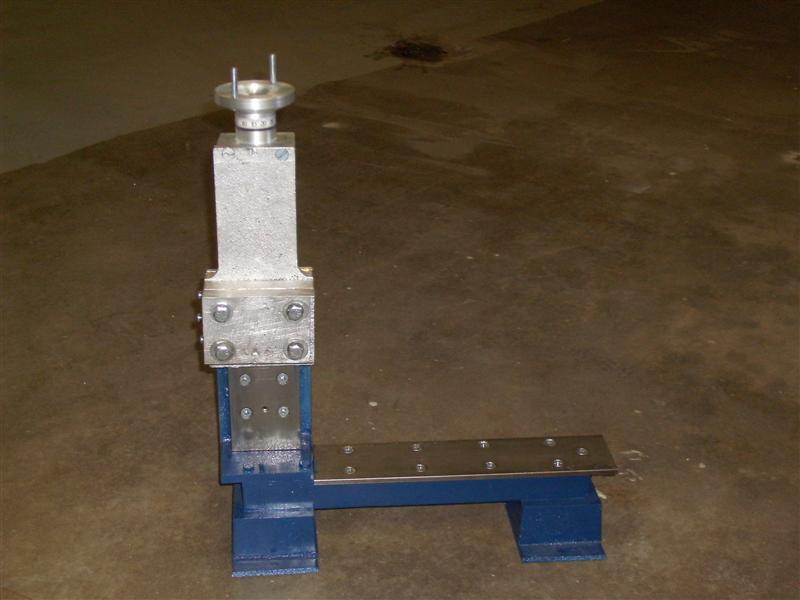

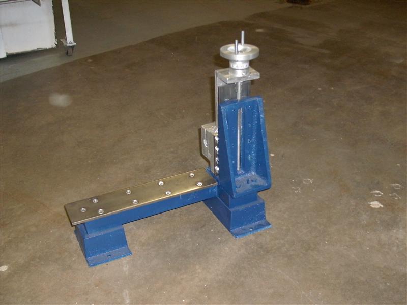

« Reply #53 on: March 31, 2010, 06:20:50 PM »
I made good progress today. I got the spindle slide mounted and fitted today. Nice and tight with no play in any direction with smooth travel up and down.
Time to make some more castings now.

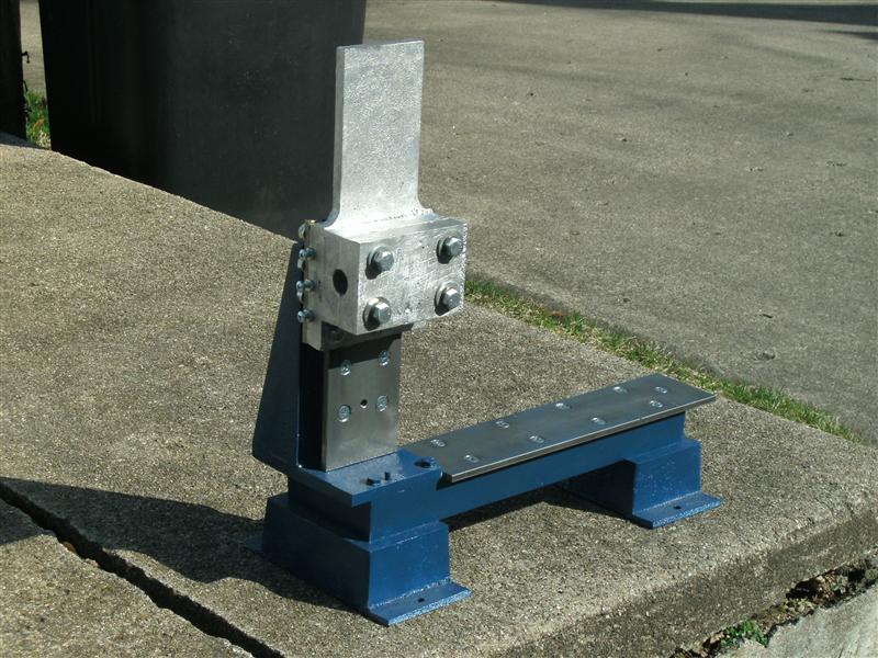

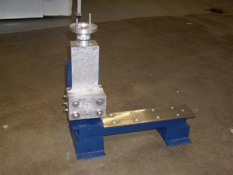

Mill update 04 09
« Reply #55 on: April 09, 2010, 04:20:38 PM »
I finished the feed for the spindle slide today. Kind of a major milestone since I will now start working on the table.  Everything fits nice and tight and the feed screw moves the spindle slide without any binding.

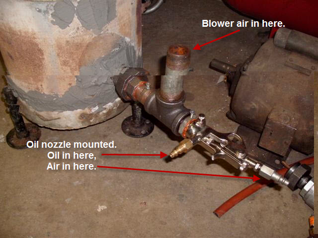

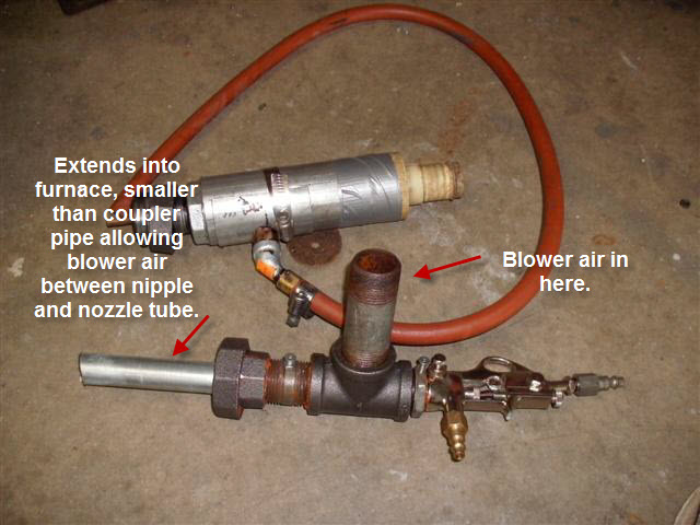

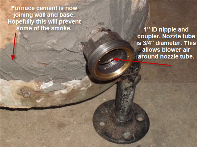

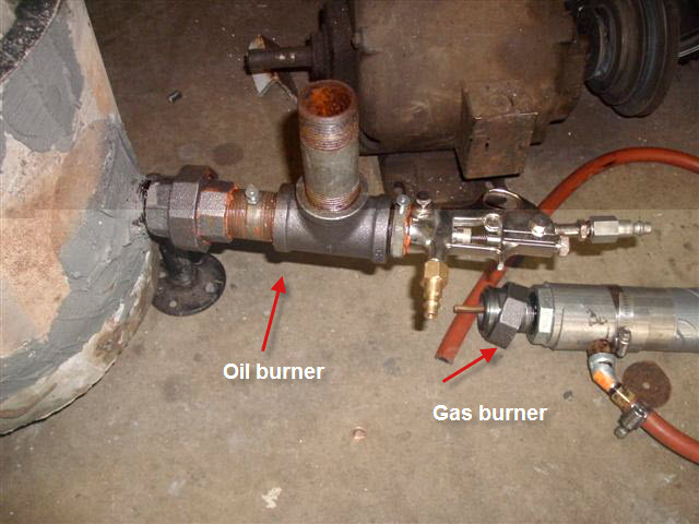

« Reply #61 on: April 11, 2010, 03:43:22 PM »
Here are the photos of the oil burner Mad Jack.

Re: My latest project. Gingery horizontal mill
« Reply #63 on: April 12, 2010, 10:28:53 AM »
Mad Jack,
I suggest building a pressure tank for the oil, no preheat needed that way. Also, once the furnace has reached a good temp you can shut the air pressure off the air line and just let the tank pressure feed oil out the burner. I run mine at 40 to 50PSI and it works well. I always leave a pound or two of air pressure on the air feed line to keep the oil from backing up in the gun.
When lighting, I put an oily paper rag or towel in the furnace, light it with a butane torch, turn the air pressure to about 30 on the air inlet and use the fine spray adjustment on the gun to start feeding the oil mist. Close the furnace and allow it to get hot. Once the unit is hot enough to keep the flame going well you can turn the air blower on and put the crucible in and start feeding metal.
One caution, anytime you open the furnace wear a face shield. The oil fire tends to flare up when the furnace gets opened. Lost an eyebrow or two finding that out myself.
