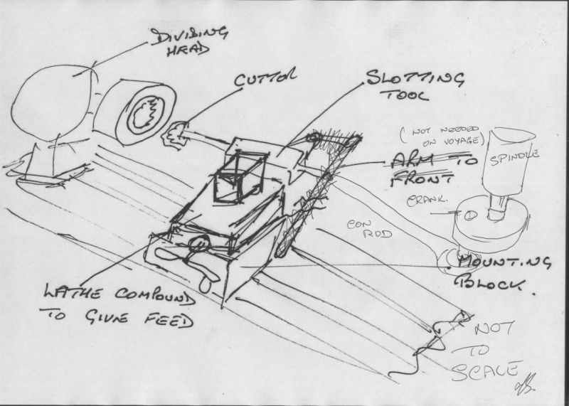

As I have already explained to John in private and everyone else now, plus having to come up with reasons for not using what has been suggested. I have a lot of thinking time on my hands at the moment, but not a lot of machine time, so even though your ideas are good, I have come up with my own. The main problem was getting the cutter made, and John has solved that for me.
My way of thinking.
WHY make life difficult for myself when I have most of the items available at my disposal? It also keeps the costs well down.
The first, accurate indexing. I have my dividing head to do that,
Putting an accurate cut on. I have the compound slide off the lathe to do that. Plus if I really wanted super accuracy, I can just plug the compound read head into the mill display, and I could, if I wanted to, be working to the nearest 0.00005" (or even more accurately if I decide I want to swing the compound round a little).
So what else needs to be done. The slotter, which has to be made anyway.
Then a support block for the compound to mount it onto the mill square and at the correct height.
Much easier to make than some sort of indexing bits for the lathe.
Can you think of anything I have forgotten?
Does the well know phrase or saying spring to mind - KISS.

John,
Slight alteration to your C- o - D drawing to save your arms.  :med:
John S.

Re: Cutting internal gear teeth
« Reply #45 on: October 07, 2009, 06:43:52 PM »
John,
That is definitely a good idea. AFTER the system has been proven to work manually.
It would only be one step away to fit a windscreen wiper motor fitted with an arm, to push and pull the slotting tool handle, then a ratchet onto the cut feed and you are almost there. But that is getting much too complicated for where I want to be.
After a little more brain time I have hit a problem :bang:
The slotting head would have to have total control of the rotation of the ram, with no play allowed at all, and would be a little difficult to do.
However, I do have a few precision linear slides that could do the job for me. I will have to measure them up, to see which would be best size wise.

« Reply #46 on: October 07, 2009, 06:56:55 PM »
John,
I have often wondered why most people follow the same paths ?
Like stepper motor mounting, everyone stands them off on 4 pillars which has to be the most inapt way, was everyone a watchmaker in earlier lives ?
Same with slotting heads, always round rams and bushes and a silly pin to stop rotation, why bushes anyway they don't run at 10,000 rpm.
What about a length of square silver steel in a brass block with vee's machined in and clamp bolts to set preload.
this way the whole of the 4 sides are load bearing AND guide the bar.
1" round bar in a 4" housing has a surface area of 12.56 square inches but a location of minute proportions on the index pin.
A 1" square bar has a surface area of 16 square inches and every one of those locates it.
John S.

« Reply #49 on: November 06, 2009, 05:37:54 PM »
Ok this is just an idea to get you thinking who knows where it will lead too
When I was using the small arbour press to test out the leather hole punches I looked at it and though square ram,  :scratch: if you turned it on its side, clamp it to a verticle slide put the tool at the other end you could use it to shape out internal gear teeth.
Here's a press this one may be a bit big but you can get smaller ones.
http://www.mscjlindustrial.co.uk/CGI/INSRIT?PMRQIT=BIJT3-33710M&origin=VIRTUAL:VIRTUAL_CAT&PMAKA=BIJT3-33710M&returnurl=&partnerURL=http://catalogs.shoplocal.com/jlindustrial/index.aspx%6Fpagename=listpage%50circularid=15737%50storeid=1039181%50uniqueid=%50fsid=%50jsessionid=%50pagenumber=1%50deptid=%50title=%50keyword=press%50returnurl=
Her's a C-0-C of the idea
http://i431.photobucket.com/albums/qq32/sbwhart/Modmodder/100_2765.jpgCutting internal gear teeth
You may have to cut the press up a bit to get it fitted but they are dirt cheep, I bet you could fix them to a lathe as a key way slotter.
:proj: :proj: :proj: :proj:
Have fun chewing this one
