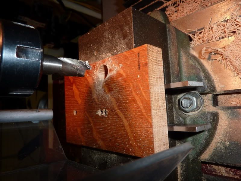

Hi all,
Tonight went  pretty well .. in the end!
I made a start on the base with some brown stuff.
http://img.photobucket.com/albums/v287/NickG24/Rocking%20Engine/2009-09-1819-32-29_0001.jpgModified Rocking Engine
It creates funny swarf … faster to saw than that 2” steel bar though!
http://img.photobucket.com/albums/v287/NickG24/Rocking%20Engine/2009-09-1819-38-24_0002.jpgModified Rocking Engine
Milling it square and to size
http://img.photobucket.com/albums/v287/NickG24/Rocking%20Engine/2009-09-1819-44-16_0003.jpgModified Rocking Engine
The sizes I designed it only just fit in the milling vice with the jaws removed … just!
http://img.photobucket.com/albums/v287/NickG24/Rocking%20Engine/2009-09-1819-58-05_0004.jpgModified Rocking Engine
Funny stuff this brown stuff
http://img.photobucket.com/albums/v287/NickG24/Rocking%20Engine/2009-09-1820-01-22_0005.jpgModified Rocking Engine
Drilling the holes … in the wrong place ... grrrrr! The brown stuff must have known I was taking the mick and got its own back … bloomin awful stuff!
http://img.photobucket.com/albums/v287/NickG24/Rocking%20Engine/2009-09-1820-21-26_0006.jpgModified Rocking Engine
Just before I chucked it at the wall I decided I could turn up a plug out of the small off cut of wood I kept .. knew it would come in handy! Turned it for a knock in fit.
Putting the chamfer on with the countersink … this worked pretty well.
http://img.photobucket.com/albums/v287/NickG24/Rocking%20Engine/2009-09-1820-43-29_0008.jpgModified Rocking Engine
Counterboring the underneath for the nuts to hold it down.
http://img.photobucket.com/albums/v287/NickG24/Rocking%20Engine/2009-09-1820-59-33_0009.jpgModified Rocking Engine
The finished base, pretty happy with it. You can see the plug but I even turned it the right way to get the grain going same way! Actually, it’s a really nice bit of wood, machines really well! Didn’t split or anything once.
http://img.photobucket.com/albums/v287/NickG24/Rocking%20Engine/2009-09-1821-15-27_0010.jpgModified Rocking Engine

ps, forgot to put anything to judge scale on again, sorry!
Don't know what those funny patterns are on wood, it almost looks like filler on the photo, sure it can't be though. I thought it was when I sanded it as I used a bosch vibrating 'mouse' sander, but looking at the first photos, the pattern is there before I sanded it. It's strange, like some bits are really close grained. Looks a bit daft in the pictures now.
Nick

« Reply #56 on: September 18, 2009, 07:59:27 PM »
That's an Oak grain pattern Nick. I'm quite fond of oak as wood goes... :thumbup:

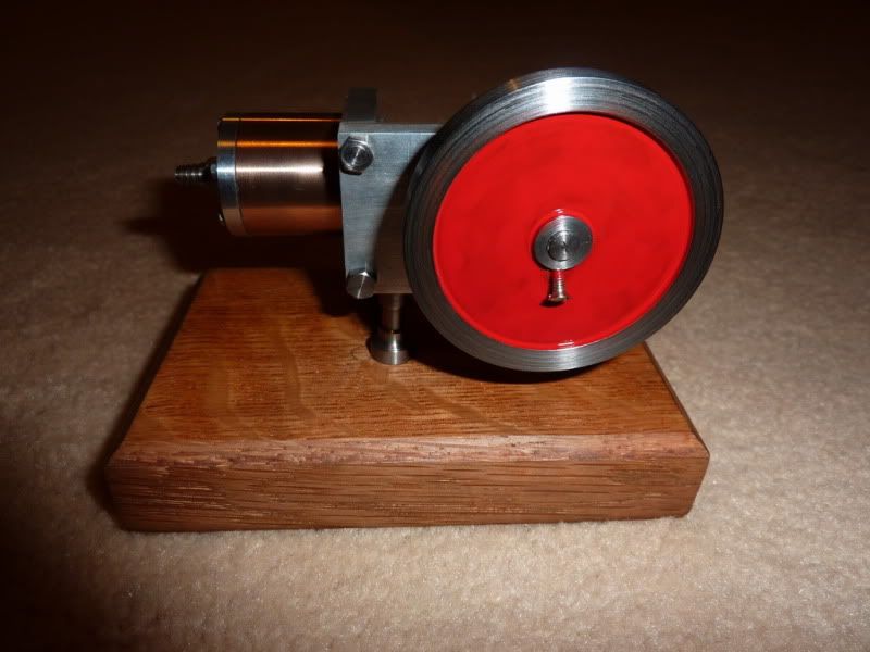

Trial fit on the engine:
http://img.photobucket.com/albums/v287/NickG24/Rocking%20Engine/2009-09-1923-52-55_0006.jpgModified Rocking Engine
I actually quite like the look of it without the holes but still think I'll put them in. Also unsure whether to paint the inner bits red, that has become a bit of a trade mark of mine!!
Nearly there!

Ouch Nick, finishing for the day sounded like a good idea....hope your thumbs ok, sounds 'orrible....
Engines looking great.... :clap:

Looking very good Nick  :thumbup: - pretty much ready to run
Well, you've now got the blood and the sweat covered; I hope the tears will be of joy !
Cheers, Arnold

Hi all,
This is the final installation of my rocking engine, barring a better video once I get some sort of air supply sorted. I'm telling you up front, the video is rubbish so you don't get your hopes up! I still have a headache from being the human compressor!
I turned the recess on the other side of the flywheel, I was going to grind the proper tool up as in John's thread but I thought I'd leave that for another time since I already had the 2 tools and packing pieces that I needed to hand.
I then decided I would drill the lightening holes, in attempt to get it done quickly, I thought I'd try to plunge them with a slot drill  ... that was a mistake! I think the cutter was blunt and tried to run off, then the flywheel moved  :doh:, don't really know what I was thinking but I didn't fancy centre drilling then gradually opening 6 holes up to 3/8". I remember last time it was a bit of a pain, I just did it on the bench drill but with the centre web being quite thin it was snatching a lot.
http://img.photobucket.com/albums/v287/NickG24/Rocking%20Engine/2009-09-2022-00-32_0001.jpgModified Rocking Engine
So abandoned that idea, just wish I hadn’t bothered wasting time marking it out etc. Luckily I was able to take a small skim to get rid of the nasty marks from the nasty slot drill!
Next I mounted it on a mandrel in the lathe to skim the OD … it was pretty concentric anyway but I coouldn’t seem to shift the phosphate coating or whatever it was just with emery cloth. As John said, don’t try machining the whole thing like this, it’s not rigid enough.  Just enough to take a very light skim really. I found a bit of 3/16” silver steel so just put a 2ba thread on one end as I knew I had a nut and washer. Gripped it tight in the lathe chuck and tightened the nut on so it squished the flywheel against the chuck jaws.
http://img.photobucket.com/albums/v287/NickG24/Rocking%20Engine/2009-09-2022-32-29_0002.jpgModified Rocking Engine
All that was left was to drill and tap an angled hole 8ba to fasten it onto the crankshaft. I still need a decent screw …for the flywheel that is!  :lol: I then painted the recess red!
I tried to bling it all a bit but am not very good at that / don’t have the right stuff.  The aluminium from the shelf brackets I got over excited about … it’s pretty naff material, too soft. It won’t even polish very well, see the finish compared to the high strength stuff on the cylinder cover!
Just lots of pics to follow now, it’s a bit of overkill but it shows it compared with my CAD model.
http://img.photobucket.com/albums/v287/NickG24/Rocking%20Engine/2009-09-2102-14-03_0006.jpgModified Rocking Engine
http://img.photobucket.com/albums/v287/NickG24/Rocking%20Engine/2009-09-2102-14-17_0007.jpgModified Rocking Engine
http://img.photobucket.com/albums/v287/NickG24/Rocking%20Engine/2009-09-2120-31-16_0001.jpgModified Rocking Engine
http://img.photobucket.com/albums/v287/NickG24/Rocking%20Engine/2009-09-2120-33-18_0002.jpgModified Rocking Engine
http://img.photobucket.com/albums/v287/NickG24/Rocking%20Engine/2009-09-2120-33-39_0003.jpgModified Rocking Engine
http://img.photobucket.com/albums/v287/NickG24/Rocking%20Engine/2009-09-2120-33-55_0004.jpgModified Rocking Engine
http://img.photobucket.com/albums/v287/NickG24/Rocking%20Engine/2009-09-2120-34-09_0005.jpgModified Rocking Engine
http://img.photobucket.com/albums/v287/NickG24/Rocking%20Engine/2009-09-2120-34-37_0006.jpgModified Rocking Engine
http://img.photobucket.com/albums/v287/NickG24/Rocking%20Engine/2009-09-2120-35-12_0007.jpgModified Rocking Engine
http://img.photobucket.com/albums/v287/NickG24/Rocking%20Engine/Assembly3.jpgModified Rocking Engine
http://img.photobucket.com/albums/v287/NickG24/Rocking%20Engine/Assembly2.jpgModified Rocking Engine
http://img.photobucket.com/albums/v287/NickG24/Rocking%20Engine/Assembly1.jpgModified Rocking Engine
Now for the video .. sorry about this, it’s the best I could do for now short of taking the car tyre compressor into the car and shooting a video in there, or busting a gut!
http://img.photobucket.com/albums/v287/NickG24/Rocking%20Engine/_0009.jpgModified Rocking Engine
I’m quite happy with it, there are a few mistakes but it’s turned out pretty much how I expected, just glad it runs!
Now I will make sure all the drawings are correct incase anybody else wants to have a go ..probably not as it’s way over the top for a rocker but it’s one for the internet archive anyway!
My next project is going to be the restoration of my 3 ½” gauge ‘mabel’ locomotive (same design as Stew’s) so probably no machining for a while. Unless I decide I need a break and if that happens I’ll be making a QCTP with 4 holders … according to my project plan!  :lol: But as you have all seen how well I stick to plans, don’t take my word for it!  :proj:
Thanks for all the replies, support and advice  :mmr:
Nick
