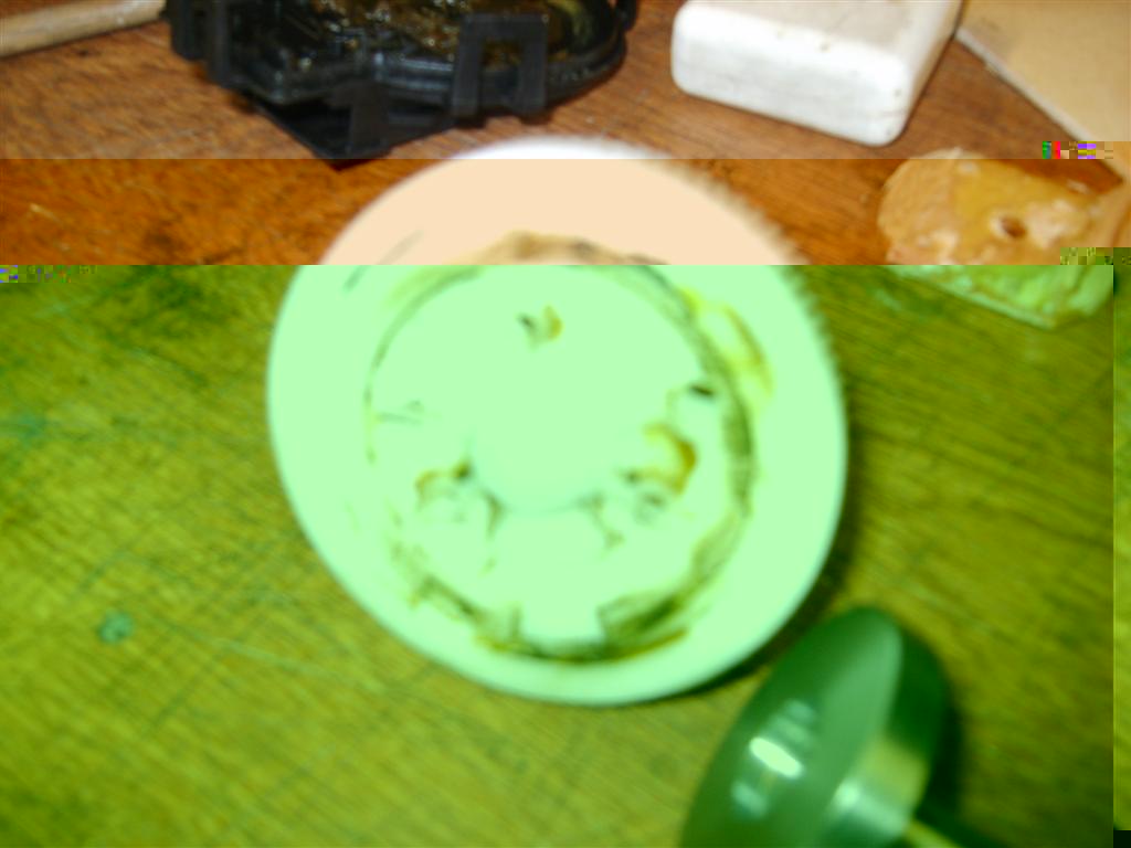

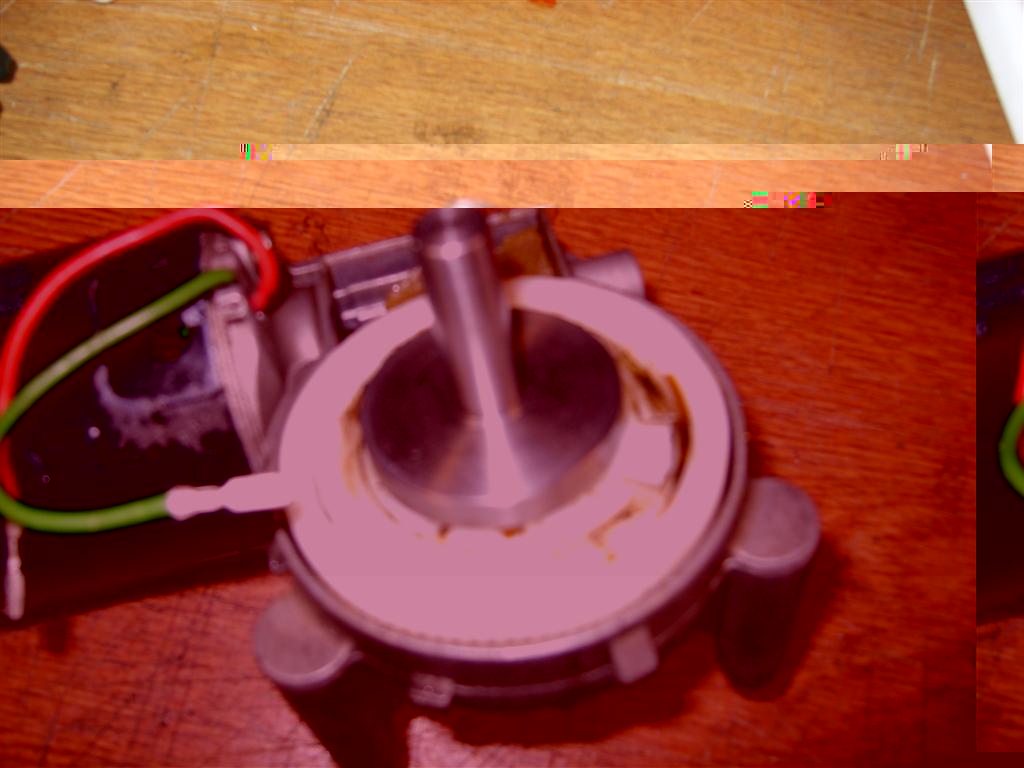

Ok guys,
Some progress today in the garage..after a bit of diy in the house ( we're redecorating...oh boy what a chore that is
So,

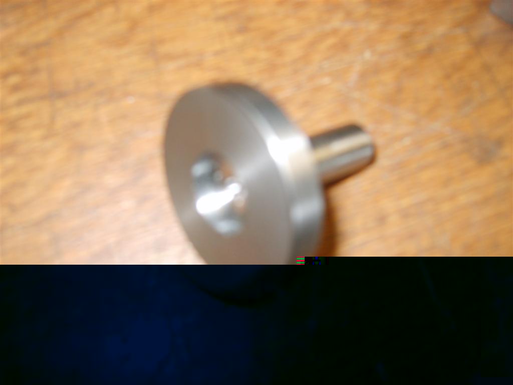

After deciding how to progress this, I made up the shaft for the motor coupling that the driving dog is going to slide on...
Here's some snaps...

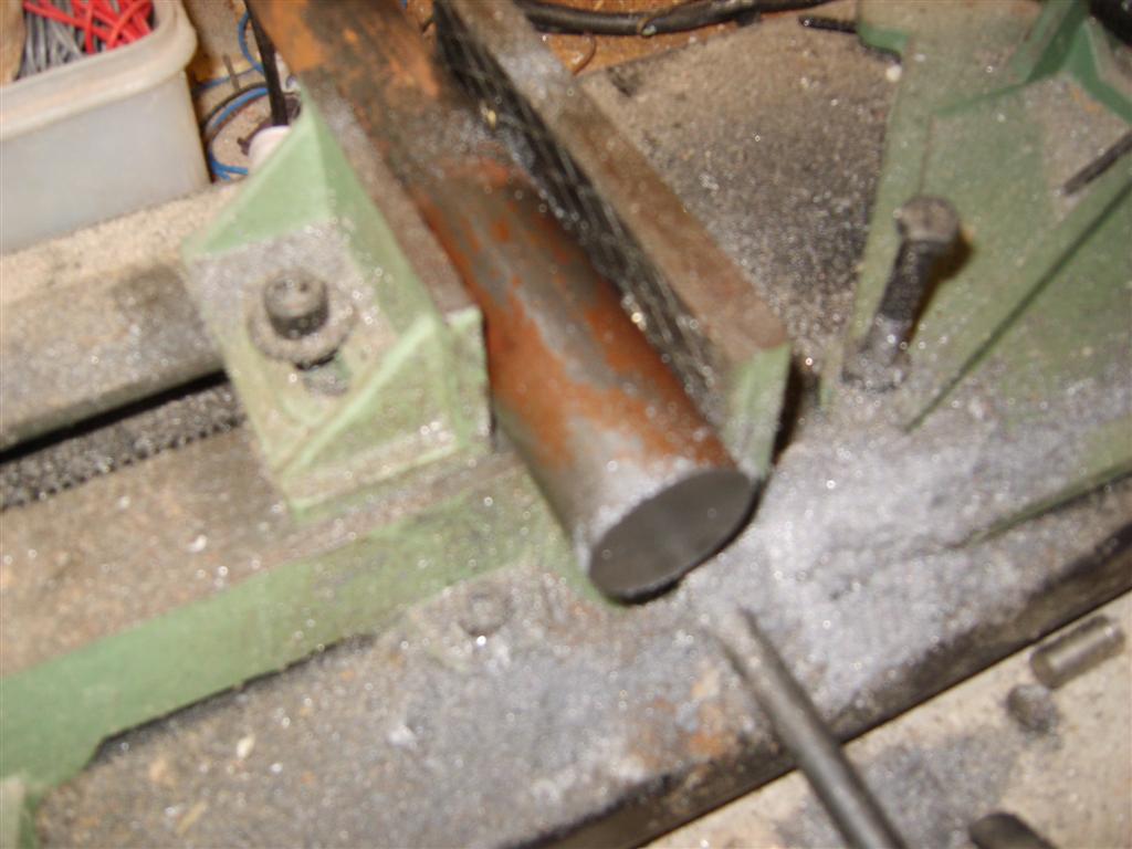

I cut a piece of EN1 about 40mm long using my trusty bandsaw...Saves a lot of un-necessary grief..
After making a lot of swarf, I have made the shaft that will attach to the worm gear..The idea being that the driving part of the dog clutch will slide on the shaft...
  • Posts: 2568
Re: Chester Conquest mill power feed
« Reply #32 on: July 18, 2009, 12:52:01 PM »
I need to cut a keyway for a 3mm key to locate the driving dog..the dog clutch I intend to make from some 38mm 6082 ally bar that I have,but that's something for tomorrow...more pictures...

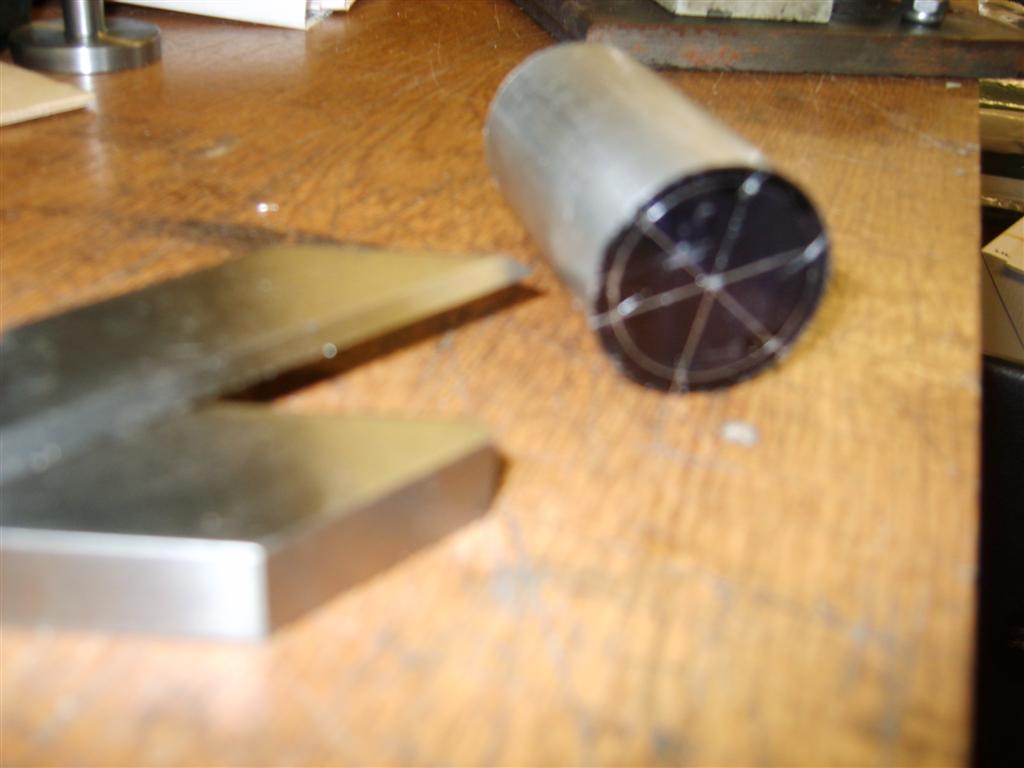

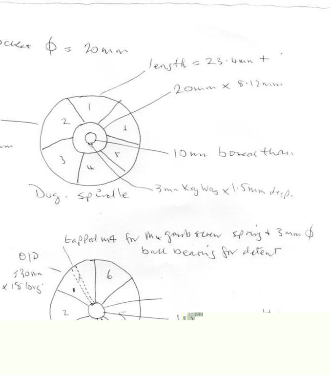

Ok, A little more progress albeit slow...more diy done today...SWMBO is laying the law down
I sketched up a few dimensions on how I thought the dog clutch was going to look...excuse the scrawl, I know it looks like something a 3 year old had drawn but I'm not into CAD drawing and it would take longer to do than machine the parts...
Also a picture of a piece of Ally bar 60mm long and 32 dia marked out for the dog's ears...cutting them will be interesting as I've never done this before...I found it easier to use the centre finder to draw the radial lines on the end...
Any advice chaps before I waste mor metal?

Wrong John,
This isn't a machining forum, it just looks like it. It is a project forum, which is slightly different.
Your sketches are fine as they are, except you need to upgrade the the now web famous Bogstandard C-o-C (Crap-o-Cad) system.
The upgrade consists of black felt tip rather than ball pen or pencil, it makes it easier for people to see, and for the deluxe system, colours can be introduced when you have mastered the basic version.
Bogs

« Reply #37 on: July 19, 2009, 01:55:25 PM »
John,
Take a 10mm milling cutter and run it straight through the work off set by 5mm. (so the outside of the cutter runs through the centre)
Turn work 120 deg and do the same again,
Turn another 120 deg and same again
You will now find your dog matches the part on the miller.... :thumbup:

Darren,
I thought I was reasonably versed in machining but this is somewhat of a challenge...A faint heart and all that..I'm not put off but a little confused by the statement you made...
Here's what I think....
I have six radial lines, if I align the outer edge of a cutter with line 1 and cut thru to centre, next mill thru line 3 and so on...Right?
Thing is I'm having to do this twice...so accuracy is the requirement of the day..I'll make the first then machine the second to match..
Good so far on this then ?

John,
I think the way you are trying to do it would be quite difficult.
The way I have suggested you only have three straight cuts to make, each at 120deg.
It's very simple to do once you understand the results it will give. Accurate every time.
I'm not sure how else to explain the method, anyone else wanna have a go?

Darren,
I just read in this month's MEW....
The penny has dropped I think..
If I centre the piece directly in line with the axis of the cutter, then offset by 1/2 of the cutters dia...then just mill thru'...Correct ?
Offline Darren
  • Posts: 3795
  • N/Wales
« Reply #41 on: July 19, 2009, 03:09:25 PM »
Bingo, that's the one.... :thumbup:
