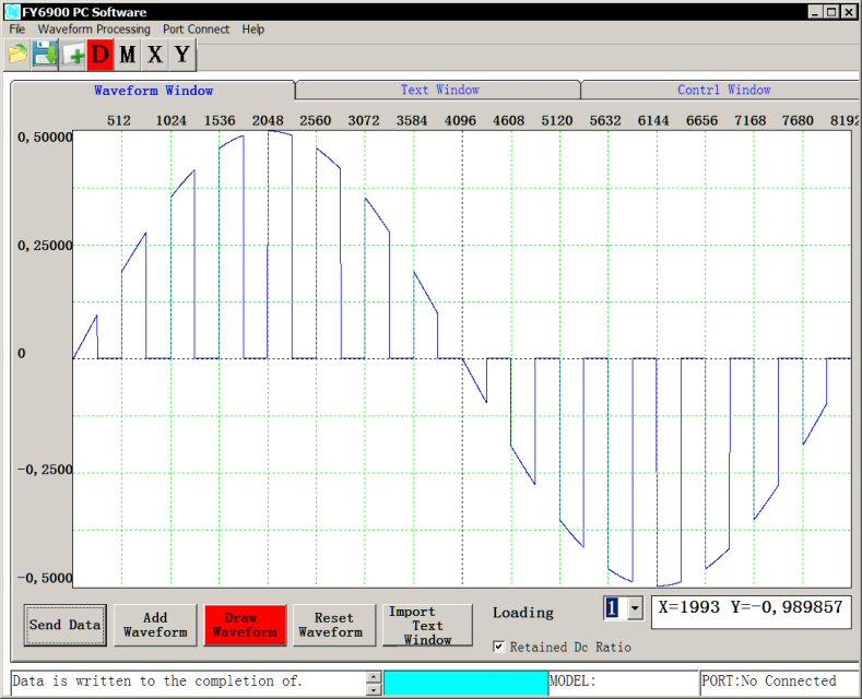

At least in my case, once I draw some waveforms, and click "send data" -button, it transfers just fine to the function generator(haven't tested how the shapes look on the scope yet, though).
Its waveform editor doesn't have any tools to edit waveforms in precise way - it's just for freehand drawing.
And, what's most fascinating, when I save that waveform to .FY -file, and open it in the program - it isn't same anymore. It's just garble. Possible reason for that is, that the program saves all 8192 decimal values using commas.  When I open that .FY -file in text editor, and replace commas with dots(or periods or whatever), and save it, open it again in the program, the waveform appears just like I drew it earlier...
What comes to the program's main window, there is a button for opening files. But when trying to open FY -files, it always crashes with a message "Run-time error '6': Overflow".

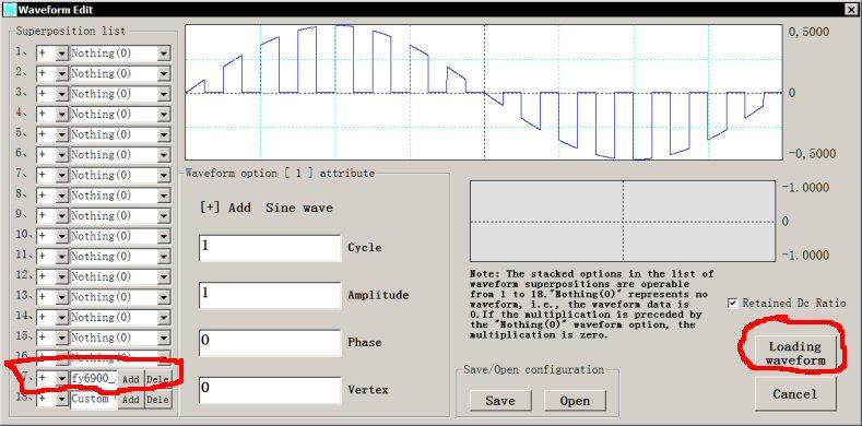

Is there any ways to open/import data to this program? Yes there is, by first selecting waveform window. then selecting a waveform file from the left side, and clicking "Add waveform" -button and, then "Loading waveform" -button:
And there we have another trap - Cycle and Amplitude values - if one uses dot, instead of comma, when entering the values, it crashes with message "Run-Time error '13': Type mismatch".
Personally I just avoid entering anything in those fields, as I haven't yet found them to be useful anyway.

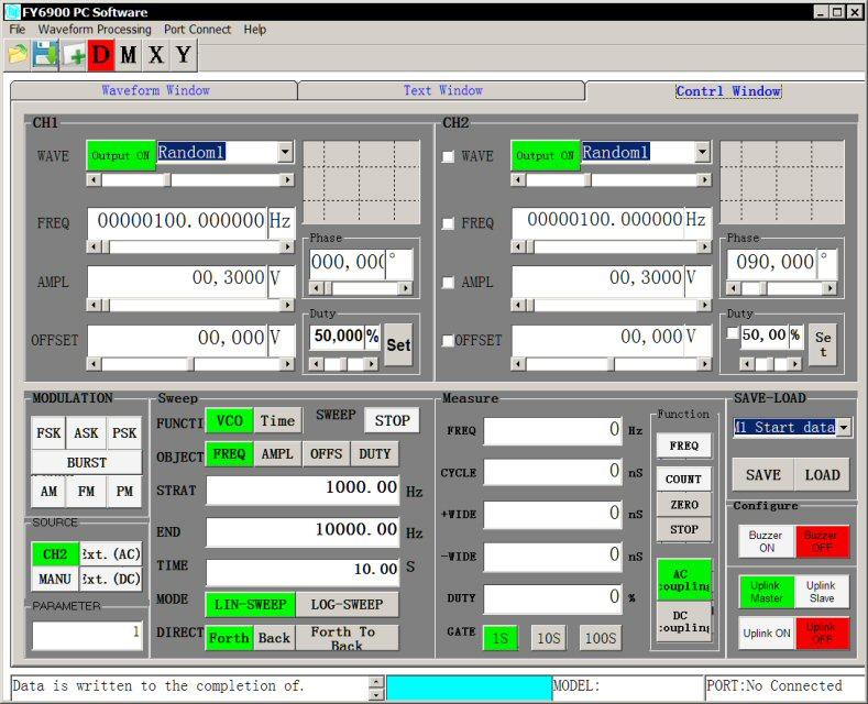

Control window, where other functions can be adjusted, haven't looked much into it yet, as all that I have so far needed/used, can be done with the device itself:

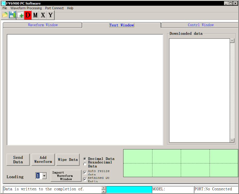

Another way to insert data is text window, where one can paste copied values, as far as number of them doesn't exceed the 8192 limit, and then click 'Import waveform Window' button, so that the waveform shows in the waveform window(Text_window.jpg).
So, to create and/or edit waveforms is preferably done by using other program(s).

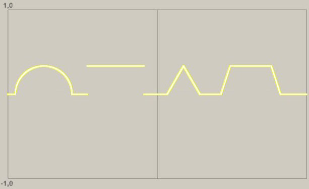

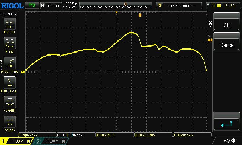

I've been testing yet another way to make waveforms - by using 2D point cloud(well not much of a cloud, as it's a flat one), made of some random silhouette picture:
But when trying to use more regular shapes, like these(Rhino_points.jpg):

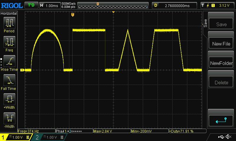

there is some odd factor that makes the vertical, or Y-values 'exaggerated', to look like this:
I've used Rhinoceros to make the point cloud, and tried to scale that shape down vertically, but it doesn't seem to have any effect to the end result.
Perhaps it has to do with ratio between horizontal (X) sampling(8192 points) and vertical (where Y has a range between 1.0 and -1.0, using 16 digits), not sure at this point.

This is about one of my noob 'aha' -moments. As I mentioned in previous post, that the  waveform which I made has exaggerated Y-values, when looked on the scope - it's just an example of subjective (the way I want it to be) vs objective view(the way it is, no matter what my take on it is).
Anyway, it's similar to looking at, say 1Khz sine wave on the scope, and scaling scopes x and y values(correct terms escape me) to whatever one chooses - there are at least two variables involved, which dictate how it shows on the scope.
So, after all, maybe there is some chance to create arbitrary waveforms, by using methods mentioned earlier for this device.
« Last Edit: October 23, 2023, 05:48:16 PM by sorveltaja »
  • Posts: 1321
 :thumbup: From a fellow Rhino user, what format do you export the Rhino data in ? Try a full size pulse (approx x2 the signal height you are trying to display) and see if they keep their proportions now.  As you say it appears to be a scaling issue with the software loading the FY6900, perhaps taking the highest point as reference, my guess.
I don't remember exact details, but I used just a .txt file format to export the data. Depending on what other application/program is (to which that data is imported/fed or whatever), there is usually a need to replace commas with points(or remove quotation marks), so .txt file format may - and usually will have countless formats in itself.
There are, again, countless options to transfer data between programs. And when one is testing things, there are no readily made or automated solutions, so the needed conversion is tested manually to see what works. That's what I did by using text editors like Excel, Openoffice, or even Notepad.
But yeah, when there are quite a few things involved/to consider(softwares and hardware(like a scope)), there is always possibility to misunderstand the results at some point(as I've already demonstrated).
