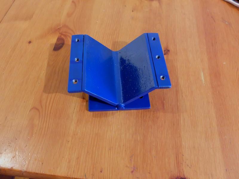

« on: February 23, 2022, 05:55:26 PM »
Today I welded up a base for a clamping fixture for the new lathe out of some rusty steel cutoffs that happened to be lying near the bandsaw in the far shed.
It will bolt down to the carriage boring table and is sized to accommodate the cylinders and pistons I've been casting. Looks like it will actually handle round stock up to 5" dia. I have yet to make the top clamping bar(s) which will bolt into the threaded holes.
I think it will be useful around the drill press and mill, as well.

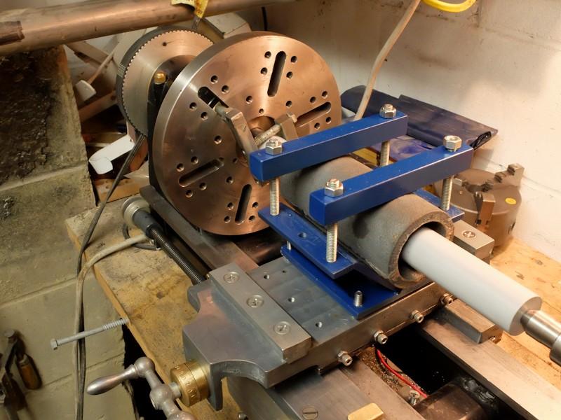

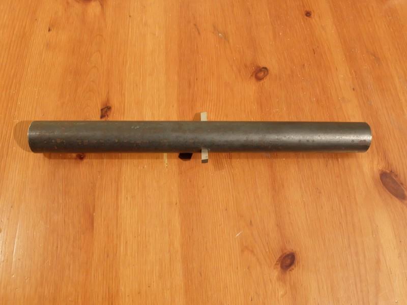

« Reply #1 on: February 26, 2022, 06:37:18 PM »

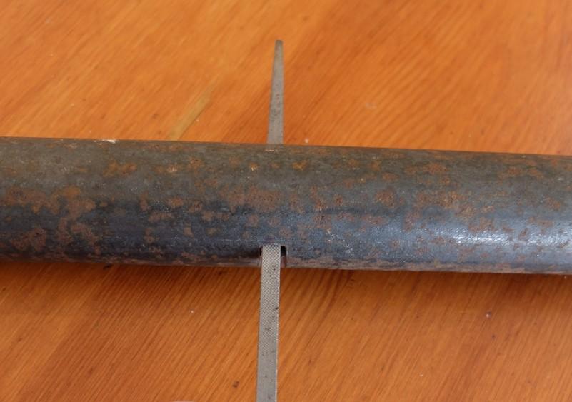

Next thing I need is s sturdy boring bar. I found a piece of hot rolled 1-1/4" rod and cut off a 13" length. This boring bar  will be run between centers and needs a cutter right in the middle. Often shop made bars feature a round tool slot, so it can be simply drilled. But this limits the tool to only round cutters -- often drill rod hardened and ground.
Instead I'm going to use a 1/4" lathe tool -- that way I can use either HSS, brazed carbide or even a 1/4" insert holder. But this requires a square hole. I don't have broaches, so I have to square the hole by hand.
I did consider slotting the bar with a 1/4" end mill, then brazing a piece back in to form a square slot. But it is just too cold today to go out to the shop and work with the mill. We've had about a foot of new snow, and after plowing today, I just wanted to sit indoors and do this via hand work.
I drilled a 1/4" hole in the bar, 1/8" off-center by first filing a narrow flat, setting the bar in the vice, and using just a steel rule scratching a mark 3/4" in from one of the vise jaws. The hole is off center so that the lathe tool will have its cutting face on center. Since this bar has the tool in the middle and since the lathe tool can be inserted in the bar from either direction, this boring bar is not "handed". That makes it simpler to lay out.

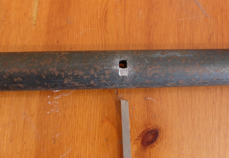

« Reply #2 on: February 26, 2022, 06:40:16 PM »
Then it was just a matter of slowly hand working the round hole into a square. I usually try to get the corners going first with a triangular file:

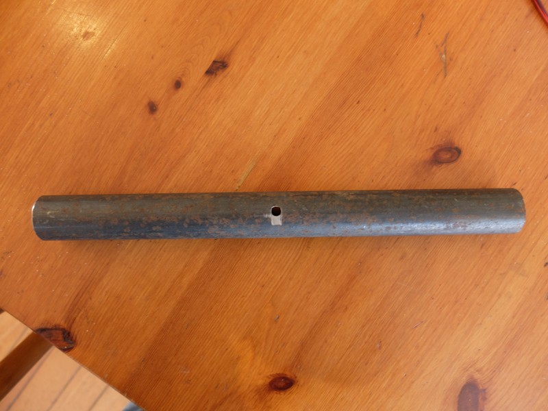

« Reply #3 on: February 26, 2022, 06:42:31 PM »
Gettin' there..... I use an HSS lathe tool as a gauge.

« Reply #4 on: February 26, 2022, 06:47:20 PM »
Lookin pretty square. At this point I gently tap the lathe tool into the unfinished hole. The sharp factory edges of the tool raise a burr in the hole, which helps mark where material needs to be removed. At this stage I also usually switch to a very small chisel. I do some cleanup with the file. too. It's mostly just a lot of try-and-fit.

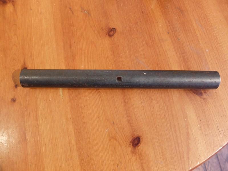

« Reply #5 on: February 26, 2022, 06:50:09 PM »
Finally the tool fits. Not the fastest way to make a square through hole, but it works well enough, and doesn't require a machine shop full of tools, just patience.

« Reply #10 on: February 28, 2022, 03:28:20 PM »
Bob I hope there are some problems with it, so he can troubleshoot them!   :dremel:

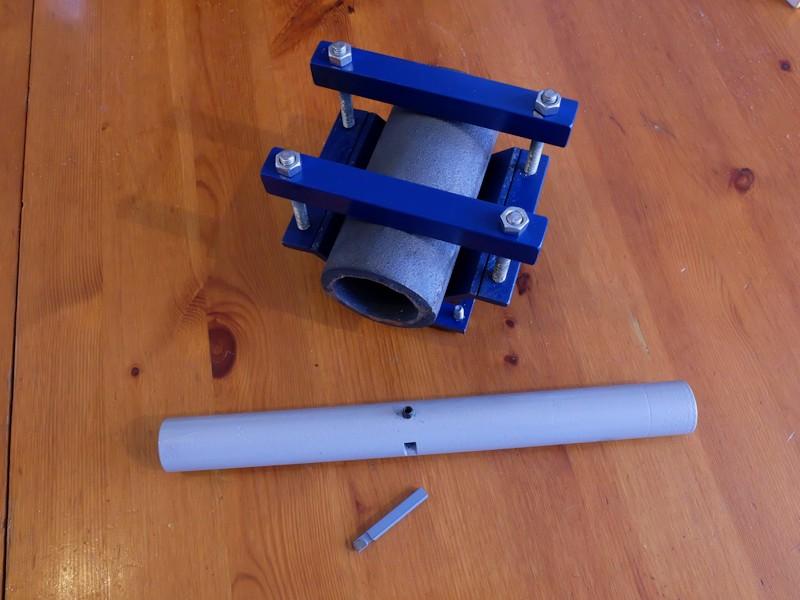

More boring progress here:
Cutter set screw added to the bar.
Hold-down bars for fixture made.
And leveling/height adjustment jack screws added to the bottom.

  • Posts: 6941
Re: Boring News
« Reply #12 on: February 28, 2022, 05:37:49 PM »
Here is the boring bar and boring fixture set in place on the new lathe's boring table.

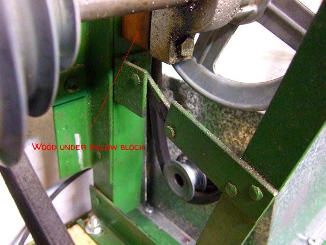

I agree about the usefulness of wood in metal working, once common, now largely forgotten. One use I put it to on my Gingery lathe was under the pillow blocks for the motor reduction jackshaft. Hardwood, once it gets a fair amount of oil on it, lasts well, is reasonable stable in varying humidity and even has been used for bearings, -- in boats, Lignum Vitae has in the past has been used for propellor shaft bearings. I've heard of hand turning type lathe's bearings made of wood, too.
But in my case it was used under pillow blocks to allow a small amount of adjustment for aligning the sleeve bearings. Wood can be compressed a little by the fastening bolts, and also acts like a spring washer to retain the bolt and nut. It's worked well on that lathe for 20 years.

My boring table fixture needs one more operation -- I need to put a vee-notch in the bottom of the cross bars where they contact the cylinder, to give it a better grip. Well I also want to put a center drill hole down into the middle of the base Vee. This will allow aligning the jig with a center drill in the chuck of the drill press. If I clamp the jig down to the table while the bit is in the hole, the Vee will be centered, and any stock I put in the jig can then be drilled on-center, without center-finding.
I think I will get a lot of use out of this fixture.

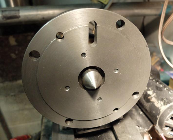

I had removed the faceplate in order to machine a backing plate for a new 6" 4-jaw chuck. Now to convert back to boring a cylinder with the new boring table setup, I needed to turn the boring bar between centers for cleaning up a cylinder. Between centers is the most accurate way, and also it allows the longest travel for the work table -- important when doing larger work on a relatively short lathe, like a benchtop model.
That means removing the chuck and backing plate and re-mounting the faceplate to accommodate a Morse taper center and driving dog. Well I don't particularly like the faceplate I have, the slots are too short for convenience, it's hard to bolt through the hub flange since it is so large, etc.
So I thought, why not just remove the 6" 4-jaw chuck and use the backing plate to drive the lathe dog. It's much easier to remove or mount the chuck because the bolts are regular hex head, and near the edge of the backing plate. All I needed to drive a lathe dog was a slot in the plate. So, off to the mill, mount a 3/8" slot drill, and simply done.
I like this new driver capability a lot. In fact I'm also considering putting a second register on the same backing plate to allow mounting the 5" 3-jaw chuck. Then I'll have a true multipurpose backing plate, and it will be a lot easier mounting chucks than turning bolts in the restricted area of the spindle flange in front of the headstock. This is a common problem with most of the small Sieg-tyle mini lathes.
