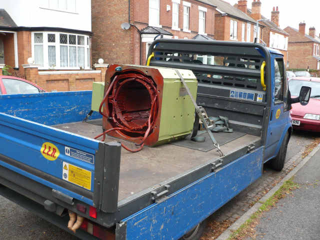

This is the one off my lathe, the one on my mill is twice this size. I couldn't get far enough back to take a pic of it.
http://i202.photobucket.com/albums/aa102/bogstandard_photos/biggest.jpgBeaver milling machine
When I turn either on, half of the country's light go dim.

The other bit was in the lathe  :thumbup:
No seriously my customers have this tendency to send bits round on the 'offchance' I can do something with them even though they know the size of the machinery.
The actual job was the brushring.
One of the blocks securing the brushes got snapped off, you can see the broken one in the middle on the bench so a new one had to be fabricated to hold the brush wand.
John S.
