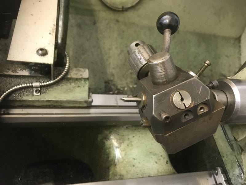

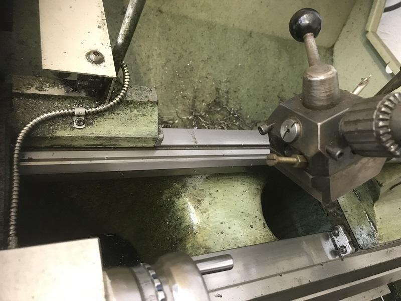

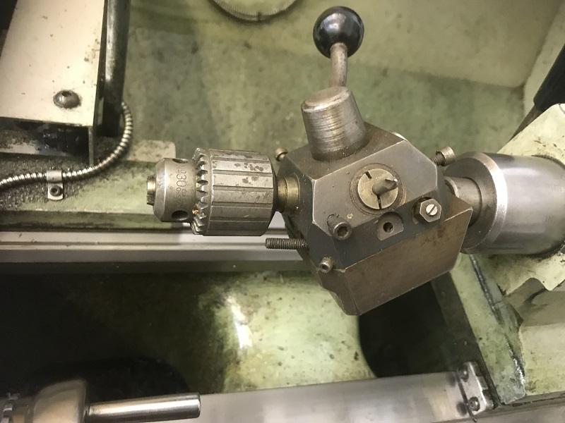

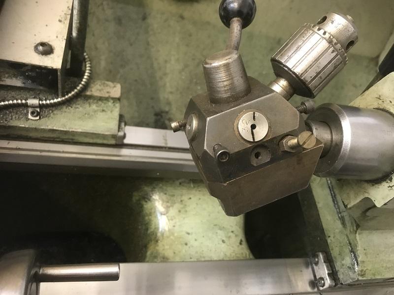

  • Posts: 9137
Re: Tailstock Turret toolholder ?
« Reply #5 on: July 04, 2021, 03:05:13 PM »
Found it - it was filed under 'small chucks - various' ! and turns out to be MT2 with an adaptor.
Can't for the life of me remember where I got it - might well have been at an SM&EE deceased effects auction but that's just a hunch - have some pictures:
