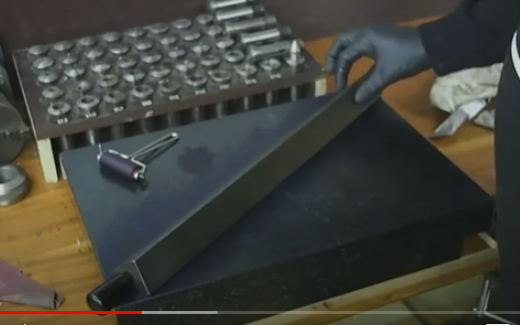

How do I get one of these triangular straight edges?
« on: April 06, 2021, 09:45:05 PM »
Or, rather, where?  Do they still make 'em?  Probably ridiculous to make oneself?

I found one in a second-hand tool dealer just north of Paris, un-scraped! extremely cheap! How about a piece of darabar? Not ridiculous at all to make one if you have a mill. When I bought mine, I thought about milling a 45° on one corner, I didn't need to as the dovetails that I will be using it on are 60°.
Cheers, Matthew

Thanks Matthew.
Unfortunately, my only milling machine is the mini mill.  I plan to use it to true up my mini lathe.

I tried to make one of those by milling 3 sides of a round cast iron bar. It bent like a banana.
I would look to getting one cast. It's not a difficult shape for casting.

And then scrape it in, using my 12"x18" surface plate for reference?

With a bit of effort you could slice that from square cast iron stock on a band saw, and hand file to an approximation before scraping as it's not a huge area.
Leave it a while after sawing to relax it's internal stresses before filing. Wet and dry on a bit of plate glass in decreasing coarseness's will get you even closer.
OK it's a lot of work but eminently doable with limited machining capabilities.

I made a short one a few years ago from a piece of old cast iron, that bent as i milled it.
So i did a little stress relief, heated it to 600c let it soak 2 hours lowered it to 500c let it soak 2 hours and so on
Was fine after that

Sawing is a great way to start!  Definitely roast it as hot as you can manage before you start!
