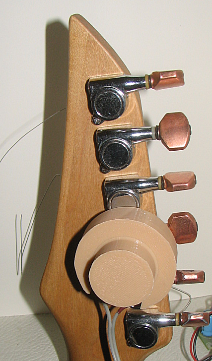

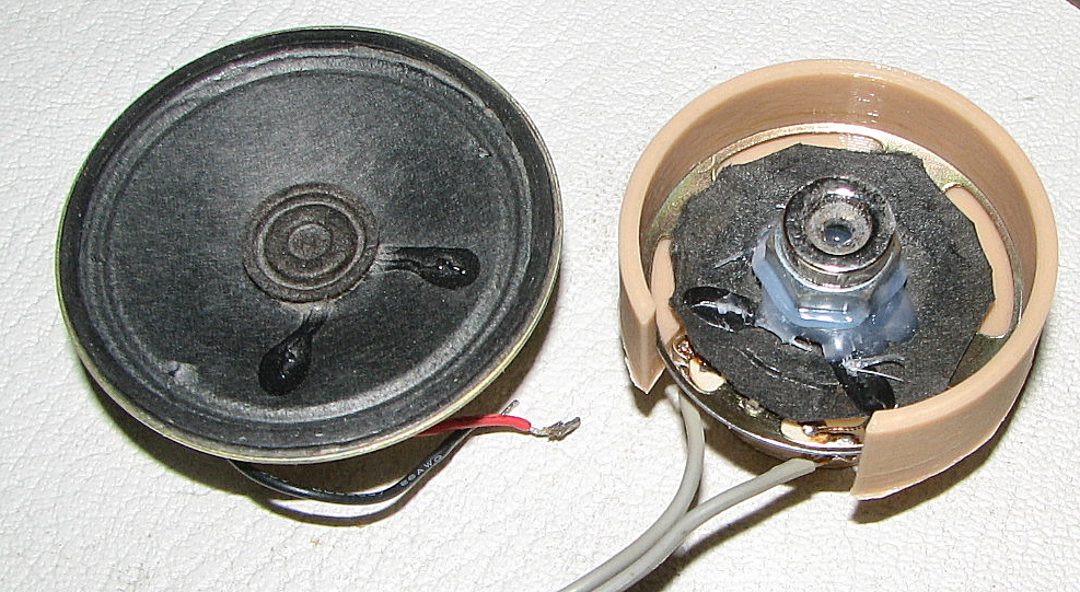

When I was adjusting the hexaphonic pickups in one of the previous project, I used a small speaker(8 ohms, 0.25watts) to make the strings vibrate, one by one.
That same speaker at this moment, on the right side:
Although not necessary, I reduced it's outer diameter a bit. Also the printed parts might not be necessary at all. Then I glued M8 nut to the center with hot glue. Next I added a neodymium magnet to it, so that it sticks nicely to one of the tuning machines:

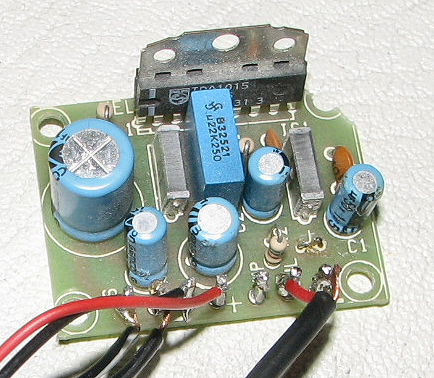

Amplifier used is a Velleman's 2.5 watt one, that I had laying around:
For this purpose, 2.5 watts is way too much, and I ended using that amp at 3 volts, instead of 9-15 volts. Otherwise nasty rattlings appear, when it clips/establishes feedback loop.
Also I have no desire to fry that speaker.
In the end, I have tested that 'exciter' on the guitar, and yes, it seems to have something in it. Actually at the lower voltage supply level, the feedback is more pleasant.

What comes to vibrating element, tactile transducer could be better, than the 8ohm/0,25W speaker, that I have used so far. Haven't yet looked, what the local suppliers have to offer.

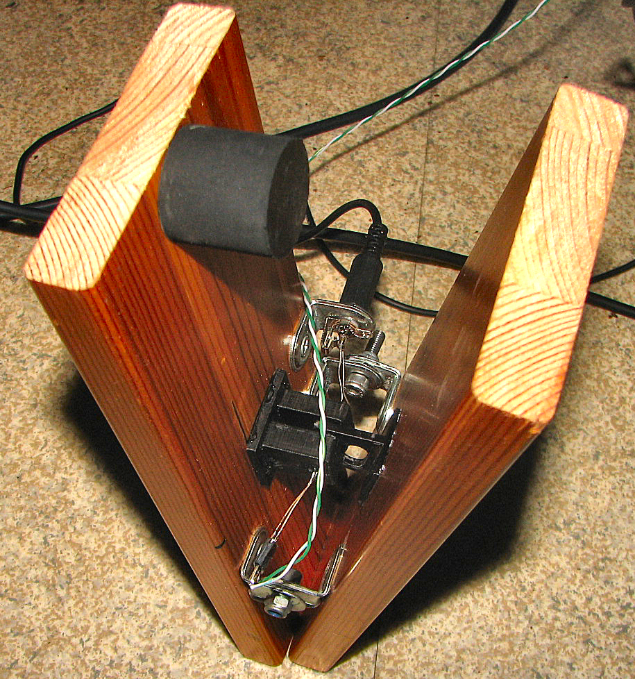

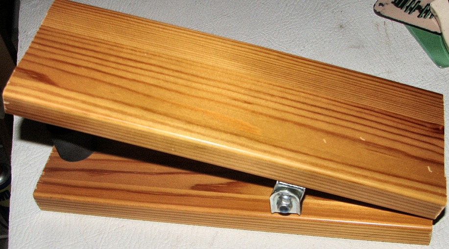

A simple test pedal:
It uses pairs of angle-irons, and M5 screws with locking nuts, to keep it from moving too freely.
Next thing is to test, how the led-ldr optoisolators could be attached to it, and also what kind of moving aperture could be used.
Super tone control uses dual ganged pot for frequency, so two pairs of led-ldr's are needed.
One might wonder, why not use ordinary pots instead of optoisolators. Good ones(used in wah-wah, and such pedals), that can stand the mechanical wear, tend to be rather pricey.

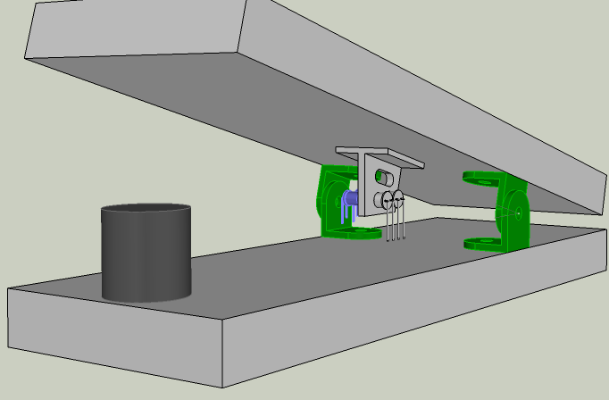

Anyways, after some drawing, this is perhaps the next step:
Obviously, the range of the action depends, how far or close the optoisolator and moving aperture are from the pedal's pivot point.

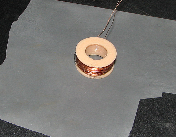

First test coil:
Coil has 0.2mm wire, and to get approximately 8 ohms, about 15 meters of it was used. To get more practical view, I modeled the coil to fit to that size of bobbin.
Finished coil has resistance of ~9 ohms.
That coil was used to test, how it works with 12x3 round neomagnet, that is glued behind the guitar's headstock. It showed signs of life, so next step is to concentrate to the 'tactile' part.
Basically it's like a solenoid, that is controlled by audio signal. The moving part (in this case neomagnet), while vibrating, needs to have something, that prevents it from rattling against the bobbin. Some kind of diaphragm. For that, I'm going to test the 1mm thick rubber sheet, that is under the coil in the above pic.
To get back to previous setup with a small speaker, it's probably the easiest, non-intrusive way to get acoustic feedback from the strings. At first I aimed to clean, undistorted signal to feed the exciter(speaker), but it would require a lot more power, and perhaps (too) big exciter.
So far, conclusion is, that small speaker works because the amp distorts heavily, creating overtones and harmonics. That particular amp was/is used with 3 volts, that is way below its 'normal' value. It alone produces plenty of distortion.
And no, it's not necessarily suitable for battery use, as it draws 60-70mA at 3 volts.

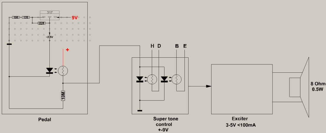

Time for an update. Finding usable range for the led/ldr-optoisolators(which control the frequency of the super tone control) isn't as easy as I thought.
Main problem is perhaps, that the freq. control for the stc was originally a dual 10k pot, and the ldr's, that I have, have resistance range from about 100 ohms to over 30M.
I guess that's the reason, why the effective range is so tiny, 10k vs 30M. I tested different resistor values in paraller with ldr, but it didn't have the effect, that I was looking for.
Next thing was to try the voltage divider. It's a bit better, but still the usable range is quite narrow. I'm not exactly sure, what other factors are involved.
But anyways, a block diagram of the current setup:
On the left is the pedal section, having 317-based adjustable regulator, that gives ~2.5V output. It controls the stc's optoisolators. Reason for that extra optoisolator, is that instead of six wires, only one coaxial cable is needed for the pedal connection.
As the usable range of the optoisolators is narrow, very little current is needed to drive the pedal's led(~20uA). I have no idea, why that is, but 9V battery could well be enough for it.
317's, that I have, seem to keep the voltage level constant, until the supply voltage drops below 5V.
On the right side is the 2.5W amp. I happened to find 8ohm 0.5W speaker, while going through the shelves. It works better than the 8ohm 0.25W one, that I used before. It's not much larger, but has more mass in it. Conclusion: the size of the speaker isn't critical. But small ones (~50mm dia.) are cheap, and appear to fit in the headstock, without sticking out too much.
Also the amplifier can be about anything, as long as the speaker can handle it. It really doesn't take tens of watts to make the guitar's strings 'sing'.
In the end, what comes to narrow range of the optoisos, there might be a workaround in a mechanical form.
When the pedal is moved up an down to block/unblock the led's light, the ratio of the movement... yeah, sounds easy, but we'll see, as I have a nasty habit making simple things complicated

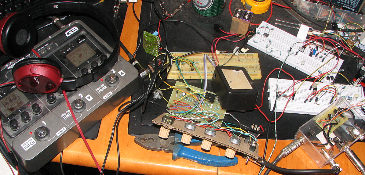

I took another look at the pedal's ldr. I removed the 10M resistor, that was in previous block diagram. Then tested again with parallel resistor, and now it worked, as expected.
About 360k seems to be usable value in this case. I really need to make clearer block diagram of the current setup, to make sense of what I'm doing.
This is the whole mess:
and the pedal:
It appears to work, but there is a 'bump' in the frequency response, when rocking the pedal up and down, making it difficult to dial in certain frequencies, so it's not as linear, like on the wah pedals.
That is about the only bug so far. Yeah, I've tested the actual wah pedal(Dunlop Crybaby) in place of super tone control, but it has rather limited frequency range for this purpose.
But babbling aside. First results using the pedal. I used another guitar, that has a commercial tremolo, which has a 'dive bomb' range, to see, what's the overall response:
http://www.elisanet.fi/kz1706/sustainer/Sustainer_pedal_test.mp3
There are many factors, that affect the end result. Just adjusting the super tone control settings offers plenty of options for fine tuning.
« Last Edit: December 31, 2022, 07:08:58 PM by vtsteam »
