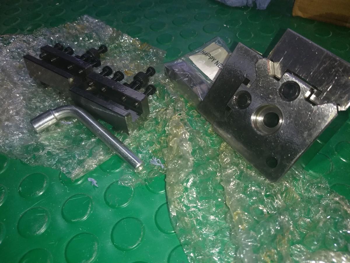

Any recommendations for a QCTP for said Warco 180?
There are any number of T37 Dickson type ones advertised but I suspect they do not have the 18mm diameter counterbore in the base to accept the 180's machined in boss on the tool slide.
Obviously one answer is to get one of these and machine the recess, but it would be nice to not have to do this particularly if the base is really hardened it might prove a bit of a job on the Warco!
Obviously Warco do one, but it's out of stock and not sure I like the design anyway.

The tool post is only case hardened on mine as are the holders , it's of Chinees origin .

Hi, the clones-in-the-style-of-Dickson-for-Myford work well on the WM180 but do indeed need machining at the base to fit that annoying boss. I managed that on my 180, but it wasn't easy going. Same as Chipenter's, it was case hardened so got easier once I got through the skin, but the inside of the bore was rough and very hard to cut. However, I only had to do that job once and I am really happy with the toolpost now.
I also have one sold by Warco as suited for the WM180, ready machined for the boss etc, and I really dislike it. Not sure if it is the same as the one they offer now. It seemed to me to move a lot when tightened up, and the vertical adjustment on the holders was poor. It hides in my Cupboard of Shame with the other mistaken purchases.

I have ended up getting a QCTP from a firm in India that I came across whilst searching. They don't obviously specify for the Warco 180 but when I inquired replied quite quickly and included an mp4 video from a Scottish customer that convinced me it was worth a shot. It arrived today, exactly as specified, fits the Warco 180 and seems to be just what I needed. Have only had time to slot in a parting tool and cur a brass disc but no problems thus far. Toolpost with 4 Holders came in at £107 all in, Fedex from India.
