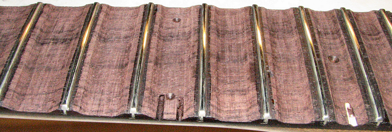

On the other hand, it has a quite good neck(maple and rosewood), but uneven frets are what makes it not so pleasant to play. So it is a perfect candidate to practice fretwork techniques, like leveling and crowning.
But first comes the scalloping, even though I'm not sure what the outcome will be. Although there are lots of videos about it in the Youtube, I'm going to find my way to do it.

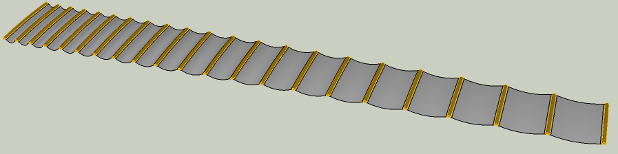

What is the fretboard scalloping anyways? Basically it's just removing wood from the fretboard. Ordinary one:
And same after scalloping:
What has kept me from doing it in the past, is that the depth of the wood removal needs to be somewhat shallow, and consistent through the whole fretboard. That way the neck's rigidity shouldn't be weakened too much.
Some testing, by filing about 1mm from the fretboard surface:

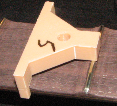

Different filing jigs were already tried, this being the latest:
It was printed, as machining that kind of piece would require enormous amount of work. Next to the file, there is a groove for the fret, that acts as a guide, so that the frets themself don't get filed.
On the opposite side is just a flat surface, that rubs over the fretboards surface, once the file doesn't 'bite' anymore. Different sizes/forms need to be printed, as the scalloping goes on.
Of course I could use Dremel to make the wood removal faster, but it would require way too complex jigs. Besides, I don't fancy having any kind of wood dust floating around in the air.
Next thing to do, is to use the above filing jig for rest of the fretboard.

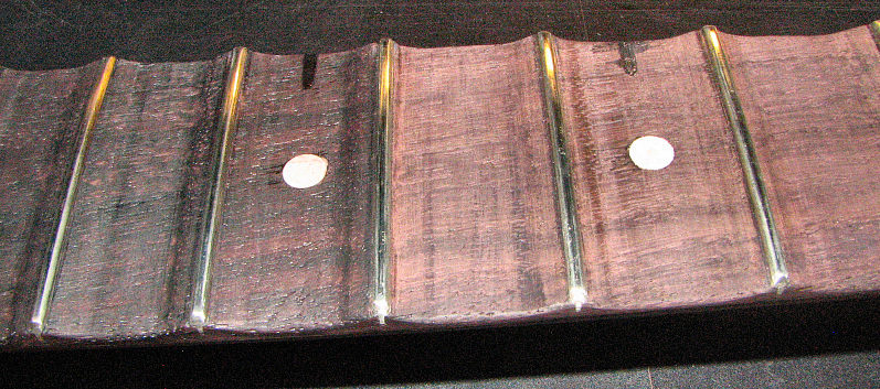

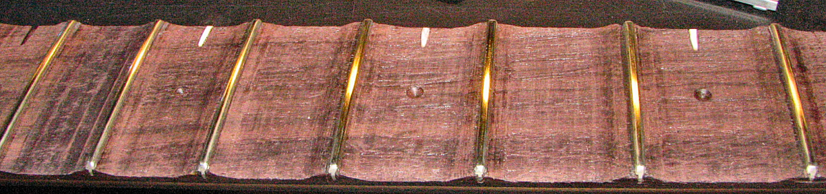

Project goes on. More filing:
Side markers are falling out, but I don't need them anyway.
Plan is to remove 0,5mm more by filing, and after that, plenty of sanding. It actually feels good to use some elbow grease, after previous electronics projects.

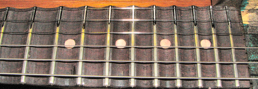

Again, more filing. Arched scallops would look better. Instead the result is more like 'U-channels'. That is fine by me, as the filing fixtures seem to work well:
Bit of rounding on the areas near to the frets, which might not be necessary, but to get completely rid of that awful, glossy finish(lacquer/varnish perhaps), that the fretboard had in its previous life.
Fret markers needs to be redone, maybe using bigger, Fender-style dots. They have to be shallow, as there isn't much of wood left, and I don't like to hit the truss rod with a drill bit. But we'll see.
To go ahead of myself, if all goes well, I'm going to dye the fretboard as black as I can, and finally, apply several layers of matte lacquer to it.
Before that, after the scalloping is done, resulting fretwork dictates, if it's worth the effort.

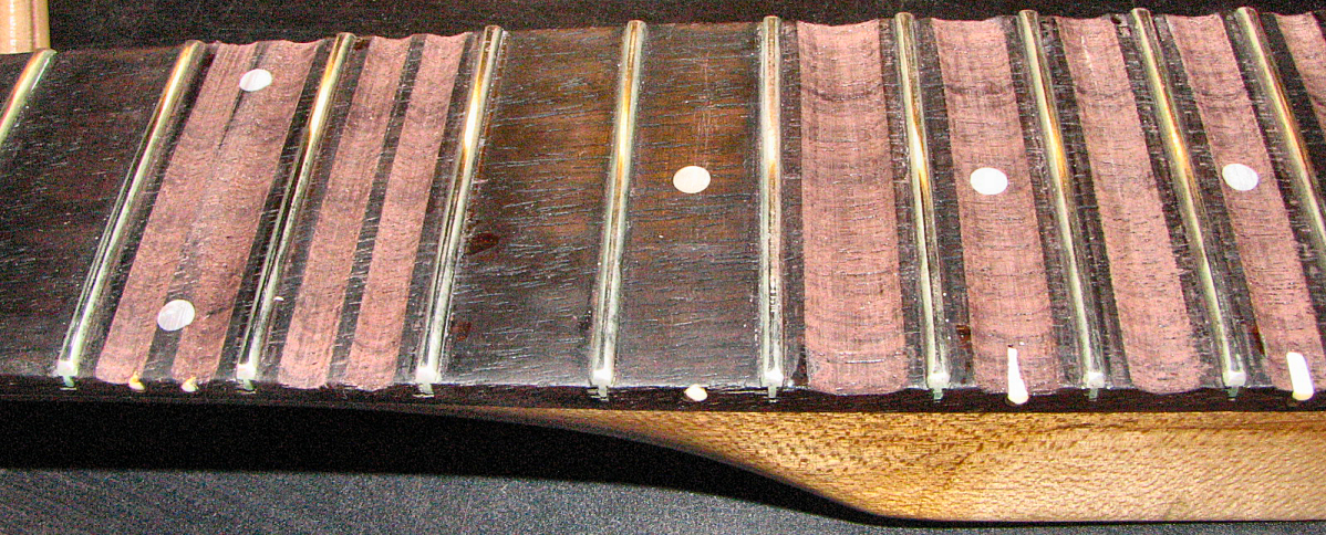

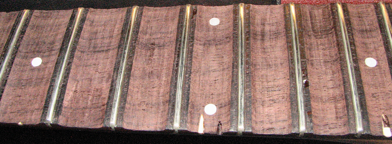

Most of the rough filing is done, so it's time for rounding the areas around the frets a bit. At this point, some of the right sides of the frets are rounded, but barely visible in the picture:

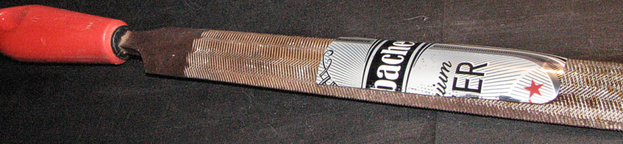

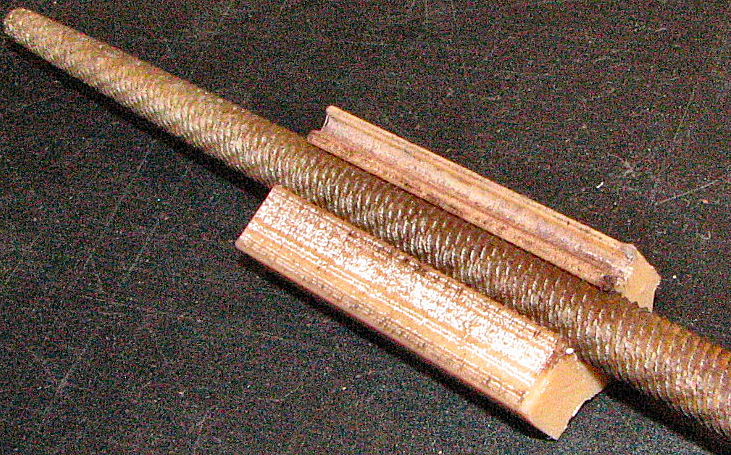

Instead of using printed filing fixture, a lot more simpler solution was at hand:
The aluminum piece is attached to the file with double-sided carpet tape. Seems to work quite well, although one has to be very careful, to not to scratch the frets.
Obviously, the 'fret betweens' that get narrower, when going though the fretboad, need again another arrangement, but fret not. If it isn't easily achieved by filing, then slowly, by sanding.

Mark, thanks. While sanding the fretboard after filing, the finest grit was 240. As this is just an experiment, trying to remove all the file marks isn't that much needed. Maybe later, if necessary.
Side marker holes were filled with rosewood dust and instant glue(cyanoacrylate). Then holes for the 6mm fret markers were made, by using printed jigs like this:
Fret markers are turned out of maple, as I already had some leftover bits at hand. They were glued with the same instant glue.
Instead of dyeing the fretboard black, as was mentioned earlier, perhaps the acetone treatment could do. Comparison:
I wouldn't use acetone for fretboards, that have any sort of plastic parts in them, though.

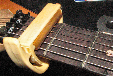

Today the guitar was prepared for the fretwork. To start hunting the buzzing frets, capo was attached to the first fret, as the saddle has a different radius, than the fretboard(actually, in this case, frets):
Then lowering the bridge, as low as needed, to bring out the string buzz on different frets. So far, it's not as bad, as I expected. I like super low action, so it's crucial to get them(frets) leveled anyway.
First impressions of using the scalloped fretboard(no fretwork done yet): It definitely isn't everyone's cup of tea, but even at this early point, I like it.
Some pros and cons noticed(personal preference):
+ string bending fingers don't rub against the fretboard
+ makes the upper fretboard somehow more 'accessible', allowing easier, crazy bendings also
- might take some practice to get used to
- fingers could 'dig' deeper between the strings more easily, when compared to the ordinary fretboard

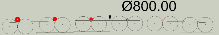

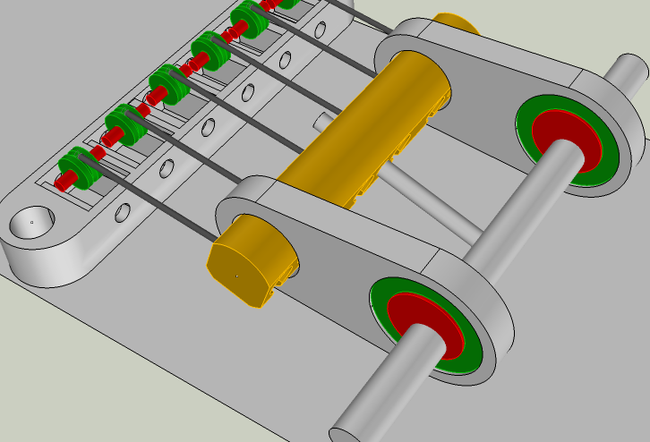

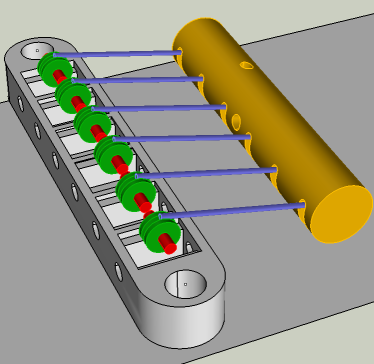

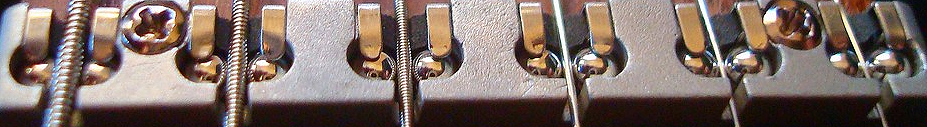

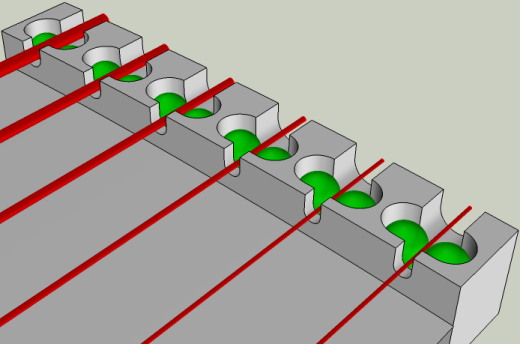

What comes to the roller nut, today some drawing, based on photos of the original one, like this:
What I've found out so far, by looking at the Fender's installation manual, that there is a retainer cage to keep the balls from falling out, when changing the string(s).
Black/dark parts above the balls are rubber dampers, to mute the string vibrations between the nut and tuning machines.
Somewhat confusing is, that in the manual, the balls are called as ball bearings. The way I see it, the balls should act as linear bearings, moving back and forth, when the string tension varies(by string bending, or by using a whammy bar).
Simplified version of the roller nut:
Ball pairs are aligned so, that the strings(in red) follow the fretboard's 400mm radius:
I have already printed the above model, but it'll have to wait, until the ordered 3mm bearing balls arrive.

Offline WeldingRod
  • Posts: 401
It looks like the balls are fixed; just hard, smooth surfaces.  And cool looking ;-)

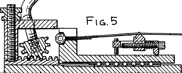

Yes, brilliant and simple concept. From what I've been reading on the net about users experiences, they are largely positive.
When taking a closer look, of how the locking tuning machines work, they probably have their uses, but it's just a screw through the string post, to clamp the string. Similar 'locking' action could be achieved by winding the string so, that it 'locks' itself to prevent slipping.

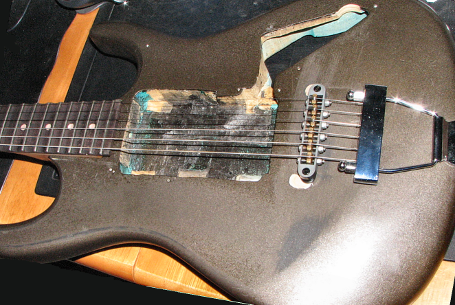

In the meantime, also the flat mounted tremolos were looked at. One, that stands out from the crowd, is the Stetsbar tremolo. It's operating principle seems to be rather simple:
It appears to have linear ball bearings in it, as the bridge and string retainers move back an forth. Most critical part, though, is the spring tensioning system, that returns the bridge to its exact position, after the tremolo bar is used.
The way the springs work, isn't so obvious to me at this point, even when looking at the patent pictures. Reading the details in the patent text makes me yawn, as it's always formal, instead of being informative.
But after all, that's what leaves plenty of room for experimenting.

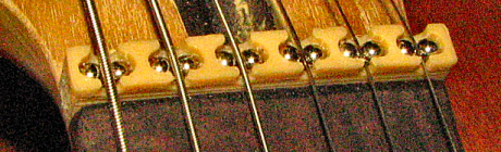

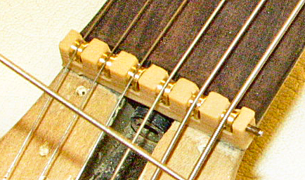

First test version of the roller nut:
It uses 3mm bearing balls. To prevent them from falling out, while fiddling, I tried different offsets, to find the press-fit tightness. To get them out again, one has to destroy the nut, though.
I haven't removed wood from the end of the fretboard yet. To be absolutely sure, that the roller nut is worth it, first I'm going to make the tuning machine's posts as 'play-free', as I can.
After that follows abusive string bending session(s). Bridge has already rollers in it, so there shouldn't be too sticky points for the strings, but we'll see.
« Last Edit: December 31, 2022, 05:54:22 PM by vtsteam »
Offline sorveltaja
  • Posts: 684
The roller nut was tested, and results are not as good as I expected. Strings get still out of tune after bendings. Reason for that may well be the type of strings that I use: coated ones.

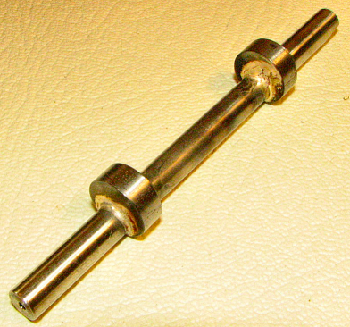

But enough of that. I think that using real rollers instead of static bearing balls could be a better bet in this case, and therefore forthcoming subject for testing.

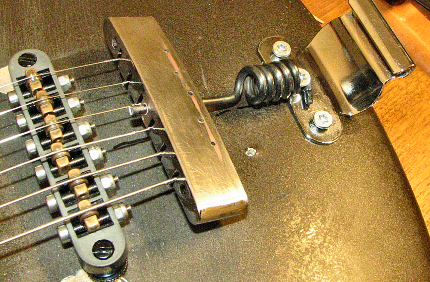

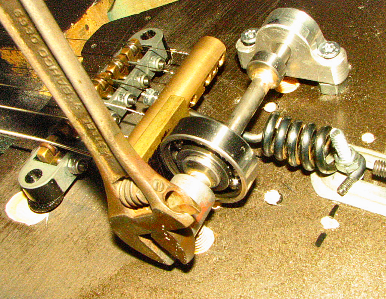

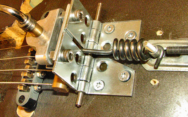

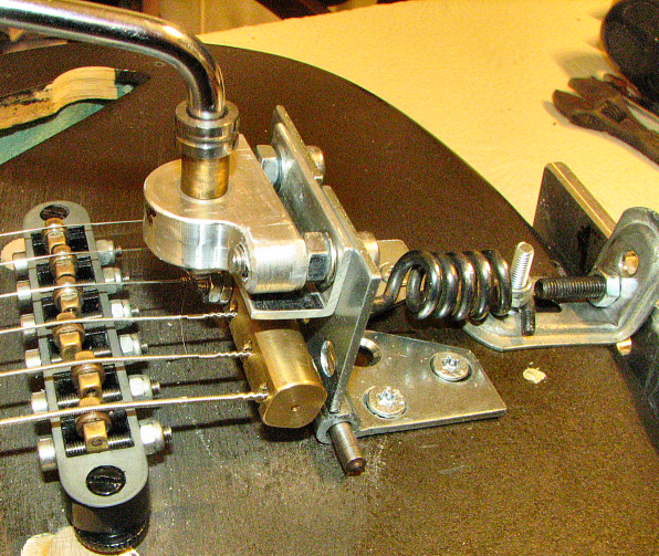

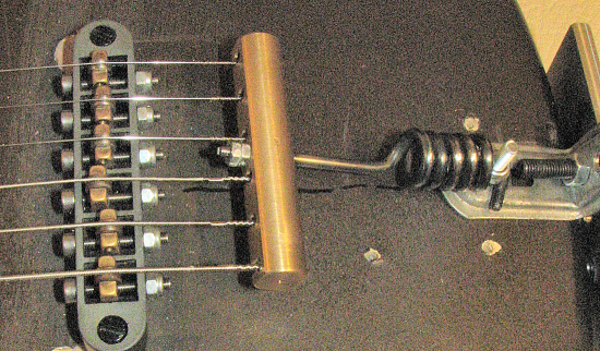

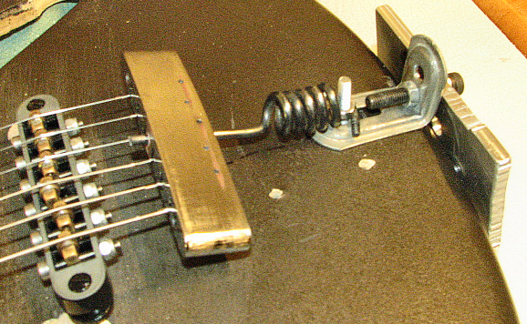

Ongoing, 'tongue in cheek' -test subject is this:
So, it's basically a part of a tremolo, thrown together from the parts, that were at hand. Exception is the spring, that had to be made.
At first, I tried the Strat-style tremolo springs, but even six of them together hadn't enough tension, to get the strings tuned for a standard tuning.
Next I looked for online spring tension calculator, only to find out, that it produces plenty of values of different variables, that I have no idea about.
Numbers aside, it was again time for parking the ball in the dark.
Strat-style springs, that I have, are made of 1.4mm spring wire. To have a single spring to take care of the combined strings tension, it needed to be stout, so 3mm wire/round bar was used.
Surprisingly, with the spring on above pic, the 'sweet spot' is a lot closer. In practice, when tuning the strings, they don't go higher than G(when using 'A' tuning fork).
As it's intentionally a 'floating' system, perhaps adding an adjustment screw to pull the springs' opposite end away from the bridge to 'compensate'.
In the end, if nothing else, this is an attempt to find the pitfalls, that many of the tremolo designers must have stumbled upon.

Now the (possible)tremolo design has the end adjustment, allowing it to be tuned to the standard tuning:
Next thing is to find out, how to attach a tremolo bar, that moves the string retainer back and forth. If it goes well, then the lumpy one is replaced with something like this:
Round 12mm brass bar will be used for that. Bit of machining for a change.
Even at this early point, that floating string retainer has already a Floyd Rose-ish(or other floating system) feel in it, which makes the string bendings/vibratos very easy. For me, at least, that alone is a jolly good thing.
What comes to binding, when bending the strings(especially non-wound ones(G-B-E)), it is definitely located at this roller nut. When the string goes out of tune(flat) after bending, pushing down the portion of string, that is between the nut and tuning machines, brings it back to tune.

Strings have now a new retainer:
When thinking of what kind of tremolo bar mechanism could be used, probably some sort of linkage is needed anyways. To make one, that fits under the spring and retainer, it would require a whole lot of machining.
Easier way, I guess, would be to silver solder some steel/brass bits and pieces together.
Before entering the tremolo stuff, the nut needed to be sorted out:
It's using brass rollers with printed body. At first, the strings got out of tune, when bending, but finally, after plenty of string stretching/retuning, it got better.
The way the strings are currently wound around the tuning machines' posts, isn't best possible, as they get tuned and loosened dozens of times, while testing.
« Last Edit: December 31, 2022, 06:01:47 PM by vtsteam »
Offline sorveltaja
  • Posts: 684
While waiting for the ordered silver solder to arrive, some fiddling with different tremolo ideas, bits and pieces:
So, using two hinges ganged together, to provide even pressure to the string retainer, could be an option. As it is in the above pictures, it doesn't work that well, as the hinges tend to press the retainer down, and detuning the strings, when the tremolo bar is released.
Inserting a suitable thickness metal piece between the retainer and hinges makes it a bit better, without the need of retuning the strings after pressing down the tremolo bar.
Even better way would be to attach something like 'connecting rod', that converts the hinges' rotary motion to linear one.
Currently the tremolo is 'one way' only, decreasing the tension of the strings. When proper linkage mechanism is added, it should be possible to make it to act both directions.
Adding the tremolo is also an attempt to test the spring, that I made. There is nothing special about it; I used a mini butane torch to heat the 3mm wire, when winding it around the 8mm axle.
No further heat treatment. I'm not quite sure about the material, but it's harder than mild steel, maybe closer to piano wire.
I'm surprised, that it works as a spring, having enough tension to keep the strings in tune. After all, sometimes the guesstimating seems to work.
« Last Edit: December 31, 2022, 06:06:39 PM by vtsteam »

Today some silver soldering:
So, the second test version of the tremolo uses two 12mm eccentrics to move the string retainer.
First test setup, again, using bits and pieces at hand:
I have only one 12mm ball bearing, but when pushing the wrench, there is rather smooth movement, although the ends of the eccentric rod doesn't have too much of bearings yet.
Needless to say, perhaps, that there should be a pair of bearings, to get all the strings 'tremoloed' at the same time.
The above ball bearing is a bit too big for the purpose, as it has 28mm outer diameter.
To add linkages, or "connecting rods" between ball bearings and string retainer, this is, what I have in mind:
Green parts are 12x18x4 ball bearings, that I ordered. In the mean time, I might do some simulations with similar size slide bearings.
