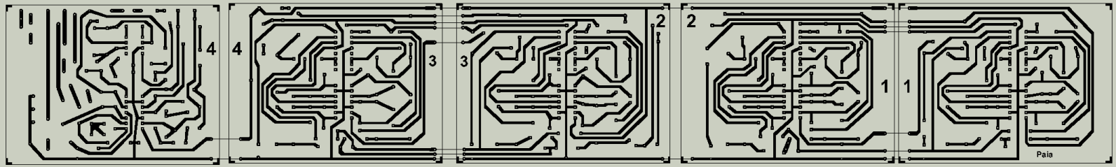

Oh boy, what a job to do! Time flies, when you're having fun(or so they say). Now the vocoder pcb should match the schematic:
Next step is to verify, how well they match... only one way to find that out. Yes, by building it.
But now it's good time to take a break of it, although some traces perhaps need to be beefed up. For now, I'll leave it there.
I'll start building the phase shifter, by redrawing its pcb, as it has too thin traces, overly big pads, and some too tight spots, for my liking. I've already added letters to the bottom(like in the original pcb), to make building more straightforward:
That is the updated version of the original pcb, found at http://www.generalguitargadgets.com/effects-projects/extras/epfm-book/
Then salvaging all the reusable parts from the old phase shifter, printing 'housings' for led/ldr -pairs, and so on.

The vocoder pcb's are almost populated:
Between the boards is a two-sided, printed 'clip', that holds them nice and tight together. It could well be a permanent holder(probably needs to be extended on both ends, to have holes for screws).
Also it takes the strain off the to-be-soldered connecting wires, making the boards a lot easier to handle together, when the outboard wiring mayhem hassle begins.
Once all wiring is done, and all goes as expected, plan is to stack two pairs of the boards, to make the whole pcb footprint narrower. When all 5 boards are placed one after another, the cumulative width is just too excessive, being about 550mm.
« Last Edit: October 01, 2022, 06:42:22 PM by vtsteam »

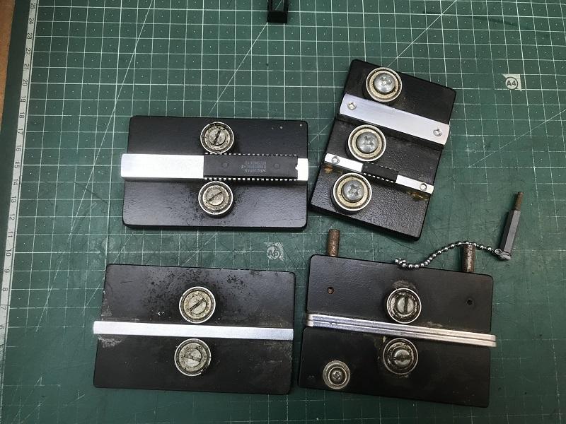

When I played with ICs I used to grip the end of the package and press the legs onto the bench thereby straightening all of legs on one side. The alternative is to make a carrier that you press the IC into, package first, which closes the legs. You can then use it to position the IC over socket and then press it in. I'm enjoying this build and understand exactly why you want to build it rather than buy a ready made product that doesn't have the flexibility that you can add to yours. In addition, the satisfaction you'll fell when it's finished can't be bought.

I still have some IC 'leg straighteners' consisting of a jig and some bearing races that progressively form the legs to the correct spacing for a socket. I'll take a picture later when I'm in the workshop.
  • Posts: 9161
Re: Extending the soundscape of a hexaphonic guitar pickup
« Reply #42 on: July 28, 2020, 08:20:25 AM »
Picture as promised (of the IC leg straighteners)

Thanks for the replies, guys. Awemawson, that's an interesting idea of the leg straightener. Haven't seen those before. Shouldn't be too hard to make one.
Another way could be like this, that has printed/machined block with a 'pocket' to fit the IC in:
Then the legs are pressed, using vice:
That block might not be necessary, but it limits the legs from bending too much. It seems to work quite well, at least on 14 and 16 pin ones, and the IC's pop nicely into sockets.

Today was spent mostly by drawing new layouts for buffers(the 'clarifier' mod for the vocoder):
First is the old layout. Second is the new one, divided to two separate boards. Both have only one input, and 8 outputs. I thought that it would be more handy to gather the outputs together, so headers will be used. There are no ground connections in the buffer boards, as was mentioned by the builder of the mod.
As can be seen, there are no other components than quad op-amps and a few jumpers, so I didn't bother to breadboard it. If the IC's are fine, it just should work.
« Last Edit: December 31, 2022, 04:40:38 PM by vtsteam »
