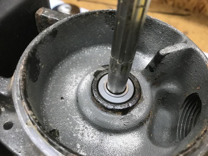

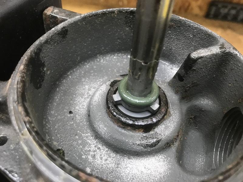

It describes the precise failure mode that you have, Andrew. A torque transmission seal where, at some time or other, the seal faces have bound together and, when the pump has been restarted, the stiction has been sufficient to unwind the spring a few turns thereby causing its failure.
« Reply #26 on: March 19, 2020, 11:05:14 AM »

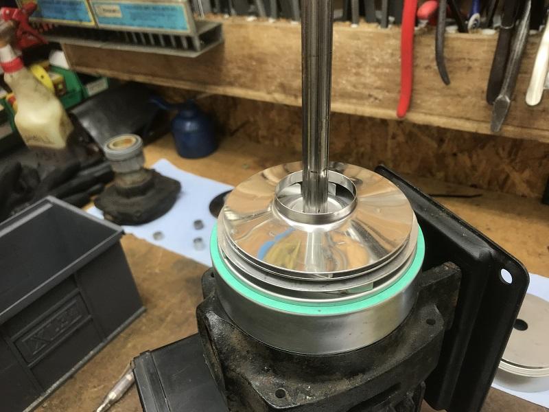

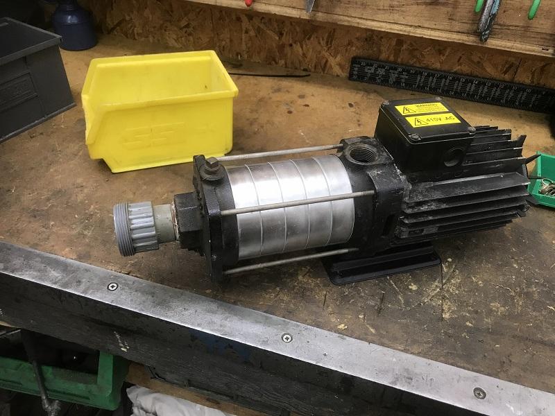

Yes Seadog and reading that article it seems using the spring is the later version, and the spare I've been supplied is the earlier one where there is positive drive from those pressed steel cups.

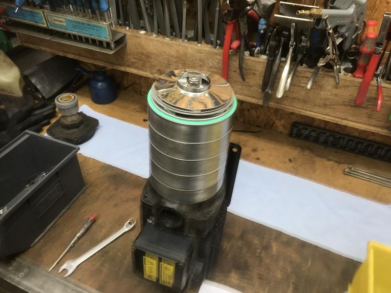

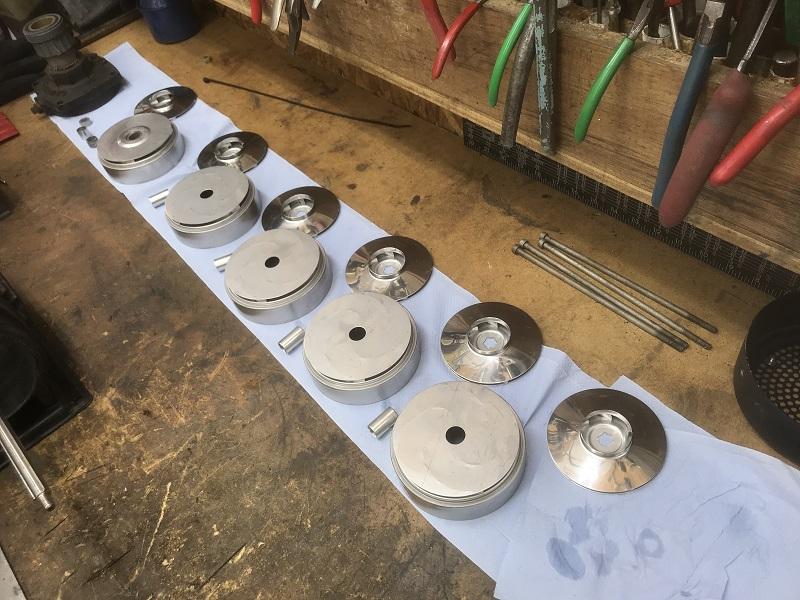

Well the kit seems to be compatible, anyway for better of for worse the pump is now back together - hoo-blooming-ray it's been a long time coming. I won't be able to test it's sealing abilities until the pump is re-installed, and that can't happen until the last of the plumbing arrives hopefully by the end of this week.
I assembled the O rings and seals with copious amounts of washing up liquid as a lubricant so no doubt it will froth a bit to begin with. But before that I finished the clean up of the internal components, and I must say they've shone up very well, far better than I expected  :thumbup:

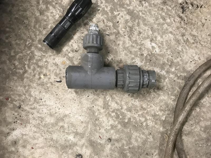

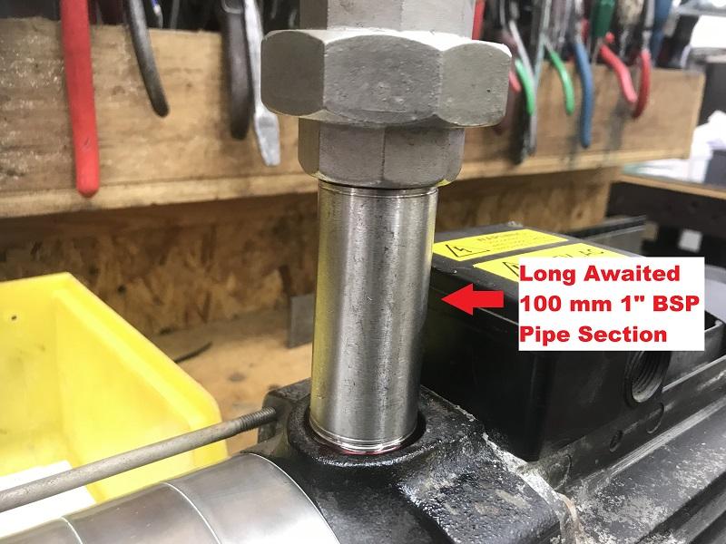

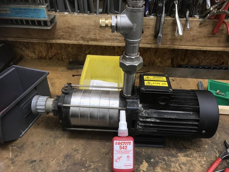

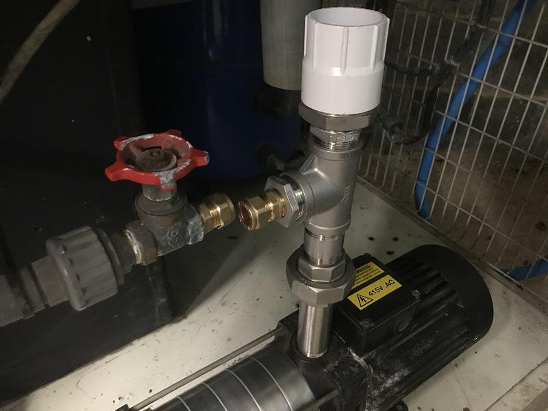

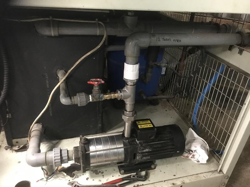

So hoo blooming ray the long expected 100 mm length of 1" BSP threaded stainless pipe arrived today. Supposedly from Southern Ireland but it was wrapped in the usual 'I've come from China' packaging. - I reasoned that it must have been packed well over the 72 hours the virus can survive for so it was 'probably' safe.
This allowed me at last to do a dry assembly trial fit as I need to arrange the 15 mm pressure control back feed to the tank via the gate valve at 35.5 mm off the base. Once that was proven possible I was able to slice off the remaining bit of vertical plastic pipe with some confidence that I can bond onto the stub and still be able to get the pipes assembled. In practice the 15 mm pipe has ended up about 5 mm too low, but I think that there is sufficient flexibility in the system to accommodate that.
The Christmas Tree of plumbing has been assembled on the bench with Loctite 542 and once that is fully cured I can trim the last bit of the plastic stub and  solvent glue that on.

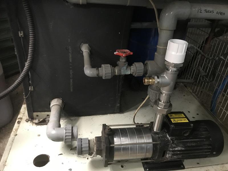

The Loctite 542 having cured I was able to re-assemble the pump plumbing in the chiller and make the solvent weld joint to the original plastic pipe. This itself needs to cure for 24 hours before I can fully tighten the various other joints and finally re-connect the motor and run a test.
I hope to heck that that seal works after all this faffing about  :bugeye:

John the seal is laced with washing up liquid at the moment and I will initially put just a bit of water in the tank and turn the pump by hand using it's cooling flange before any power is applied.
First thing is to slowly fill the tank and watch for static leaks, and to that end I've just resurrected a hose pipe point not too far away (O ring seals totally crunchy after a few years in direct sunlight), and I've reconnected the motors wires and bolted it's flange down.
So if I can persuade her tomorrow it'll be wife on the tap and me with hose in the tank 20 yards away yelling STOP  :bugeye:

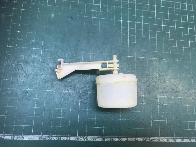

As I filled the tank the float for the water top up inlet valve, that I had noticed was on the base of the tank, floated up and I ws able to recover it - it looks as though it should just snap back into place but that's the least of my problems at the moment.

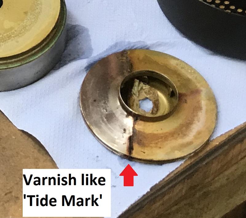

I understand that the sealed unit compressor / coolers have an oil charge and a gas charge within the envelope.
When I re-built the Grundfos pump there was a tide mark of 'something' that had dried to a hard varnish like substance (indeed I think that's what did for it's seal & spring) and I'm just getting this nagging doubt whether the immersed bit of plumbing in the water tank from the compressor unit has sprung a leak, released the oil into the water which over the years evaporated leaving the varnish tide mark.
This would of course explain the demise of the compressor (no oil) but if this is the case I'm surprised that it did actually chill the water and I was not aware of masses of  bubbling in the tank from an alleged leak.
. . . this is forensic engineering !!!!

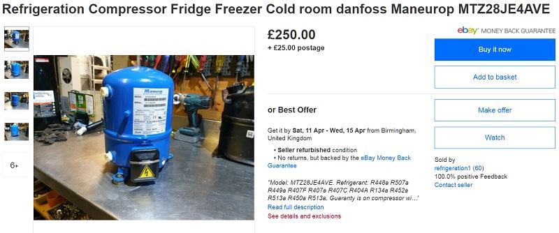

Russ, I don’t think sourcing a replacement equivalent unit would be too much of an issue apart from the cost. They seem to be north of £1500 new, and dubious used ones pop up starting at £250 /£750 mark though none are identical.
Before committing anything like that sort of money I some how need to get a bit of confidence that the rest of the furnace equipment is reasonably sound. I do remember that when the furnace driver was delivered I was able to connect it to one of the furnace bodies and get the electronics to ping and determine the resonant frequency. At the time I had no chiller and no high power 3 phase supply in fact I was running off a Transwave static converter off a 13 amp socket!  Obviously I couldn’t go any further without a massive power source.
