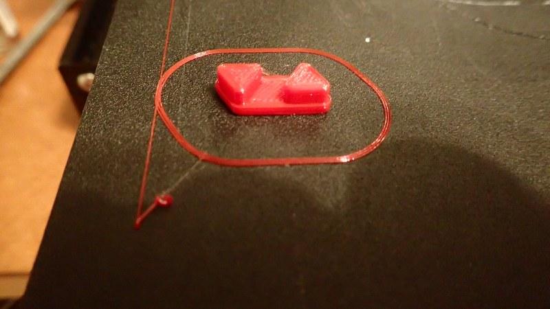

On one ocasion extruder nozzle was too low when I used PETG (but only for skirt) and I can confirm that it REALLY sticks to it. Previous prints with PLA were fine and I did not check the bed level. Still, not sure why the bed was on correct level before and then too close on next print. Same location, same homing, only bed temperature raised from 50->80C.
But also at 80C even when first layer is extruded close to 50% of nozzle diameter (I.E. gap between nozzle and bed is 0,20 mm and nozzle d is 0,40 mm) it sticks to bed uncomfortably hard.
I must say that I had practically non used bed before PETG, I only had used sample PLA filamet prior to experiment and used standard setting with very minor modifications.

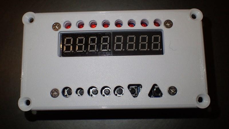

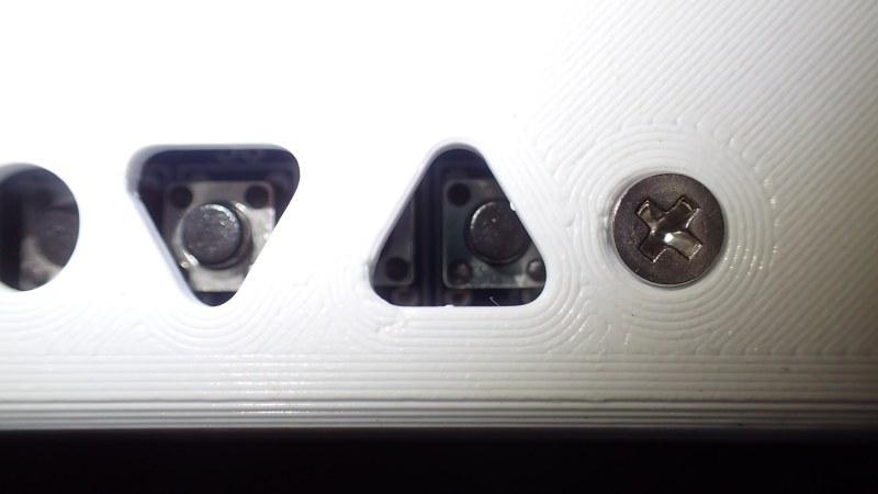

I needed to print / slice /adjust flex filament buttons several times. Still I don't have good parameters for this Ninja flexible filament, it seems to be pretty temperamental and took some tries. Finally gave up blue tape and used Ender Pro-bed, just wiped clean with IPA, raised bed temperature to 45C just before first layer (rest of print at 40C) and first layer was printed pretty "flat". Extruder temp was 228C, layers may not be fused extra well together, but I was getting allready some oozing and stringing.
Last hurdle was to adjust height  0,85 mm shorter, or buttons would not "click" reliably.
Round button holes on the panel line up pretty good with the PCB swiches, but extreme arrow button nearly misses the switch. Paralax error on the picture lies more than any politician.
