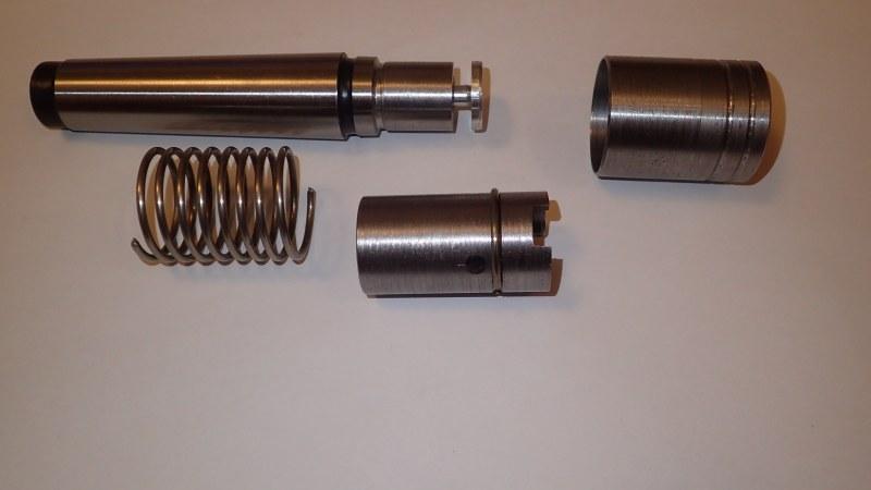

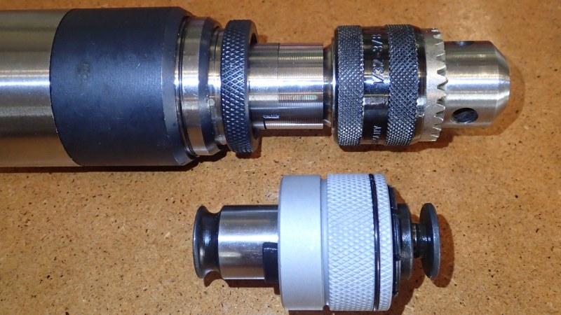

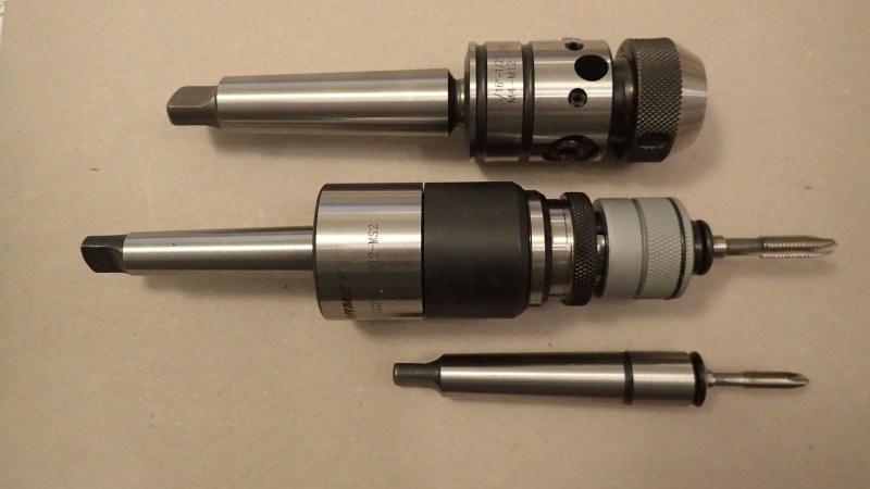

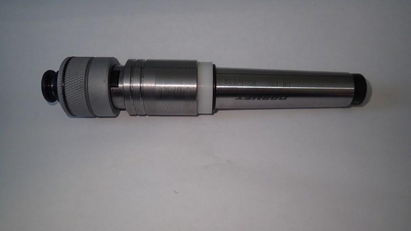

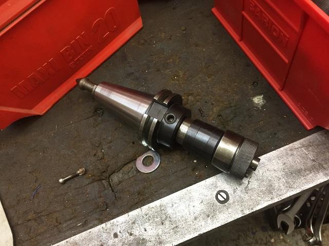

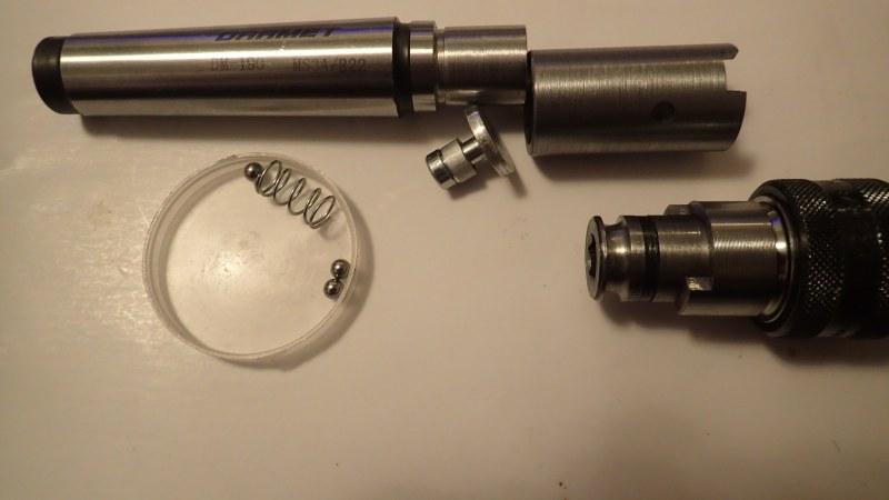

I have some 19 mm arbor size tapping adapters and chuck. The chuck has some spring load float out. Problem is that the tap hangs out pretty far.
The quick connect does not appear too complicated. I disassembled MT2 (in picture) chuck and the quick connect coupling looks pretty simple to make.
I checked ebay...looks like Britons have it pretty easy, but many shops have jacked up P&P to Finland to over 30€.
1: Any good DIY pointers? I'm thinking a simple standard ball coupling - linear or twist lock.
2: Maybe I have missed a proper search word for chuck only...I find only very expensive ones.

Pekka,

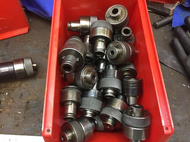

I have only ever bought them second hand on eBay where often sellers hope for a fortune but bargains CAN be had. New ones demand a Kings ransom !
There are two styles (straight and torque limiting) the later being adjustable with a pin spanner. and come in a range of sizes besides your 19 mm from very small  to quite large, and of course each range comes in a variety of tap shank and square sizes.
I see no reason why a spring loaded ball attachment wouldn't work well so long as you incorporate the side float.
They are brilliant devices, and I use them all the time on my CNC mill except when space limitations preclude them as they are bulky. In those circumstances I use a standard holder (with end float) as although I'm set up for rigid tapping, I never entirely trust it !

I also saw a QC collet with drill chuck taper. Seems usefull, but pretty expensive for what it is. Maybe another project. I happen to have two extra chucks that has thread mount.
Re: Short QC Biltz type tapping chuck

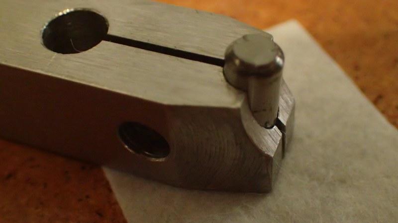

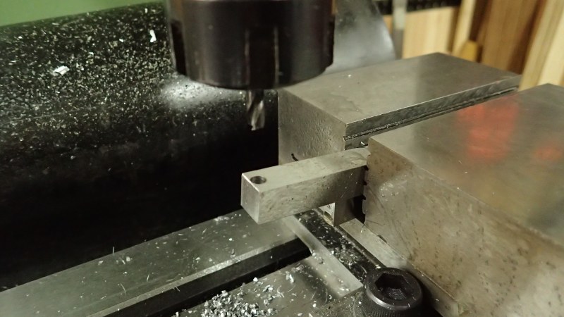

I checked some products, could not find what I needed...then checked my stock and tools. Looks like only tool I need is an 5 mm (r 2,5 mm) profiling tool or grooving tool. Apparently not the most usual insert/holder dimenssion - not exremely rare, but not the most common either.
I have ONE 5 mm solid carbide cutter I could chop and braze on a shank. Is this a idea?
« Reply #6 on: February 05, 2019, 04:48:51 PM »
Seems a shame to sacrifice a carbide mill.
Have you no bits of silver steel that you could turn a 5 mm end on, mill off half and then harden ?

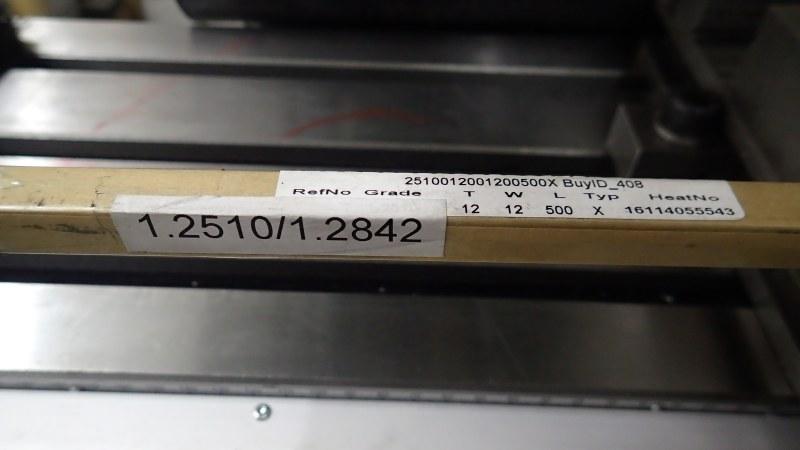

« Reply #7 on: February 06, 2019, 02:37:10 AM »
Could try that, but that means swapping the material softer (like 42CrMo, I probably have one rusty bar marked with blue tape - my way of marking known materials).
Maybe I could plunge mill 5 mm hole (pocket) 10 mm deep to end of flat steel, mill extras of and braze silver steel plug there. Sort of make pocket for cuting bit - I have to draw it into scale....if I put that "rod" upright, it would have perfectly round projection (cutting face)....should be long enough to allow clearances 20 mm OD turn piece to plunge cut....Might even work good enough if tilted forward few degrees - projection error probably still would good enough. Can't take too agressive cut with this sort of form tool.

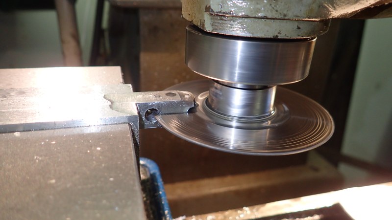

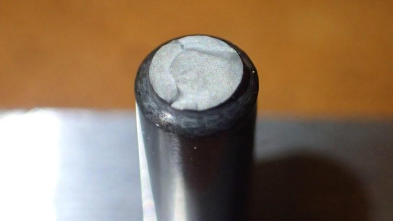

« Reply #8 on: February 10, 2019, 07:27:51 AM »

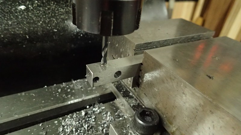

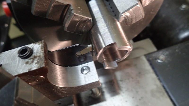

Took few shotrcuts with this tool and so far good progress (very litle time innvested).
But weird thing happened: I was cutting off 10 mm long piece of the 5 mm dia carbide and it just snapped.
I had the round tngsten carbide mill shank rotating on the lathe few hundred rpm and decided to cut it with cout out blade. 3M 1 mm wide cubtron ussually cuts anything clean, but it was a little hesitant on this one. Suddenly the TC rod just snapped.
Last picture is mock up where the TC rod is form tool, but need to decide how to grind it. I was thinkking of using diamond hone manually, but that rounded edge set the idea back a little.
« Reply #9 on: February 10, 2019, 08:11:14 AM »
Thermal stress probably.
We used to make containers out of milk bottles that way. Fill with oil to the level you need the break, then plunge a red hot poker in the oil. The hot surface layer of the oil snapped the glass bottle at the right place as it was much hotter than the body of the bottle.

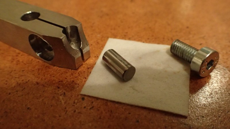

« Reply #12 on: February 10, 2019, 12:29:10 PM »

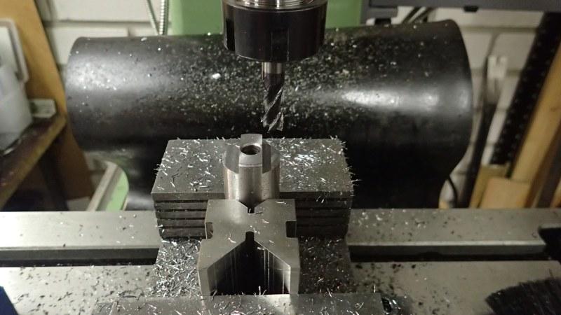

form tool and test

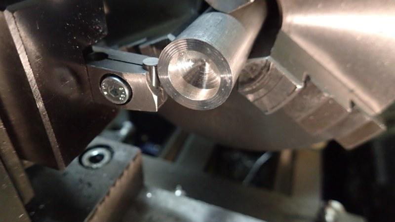

« Reply #13 on: February 10, 2019, 12:39:59 PM »

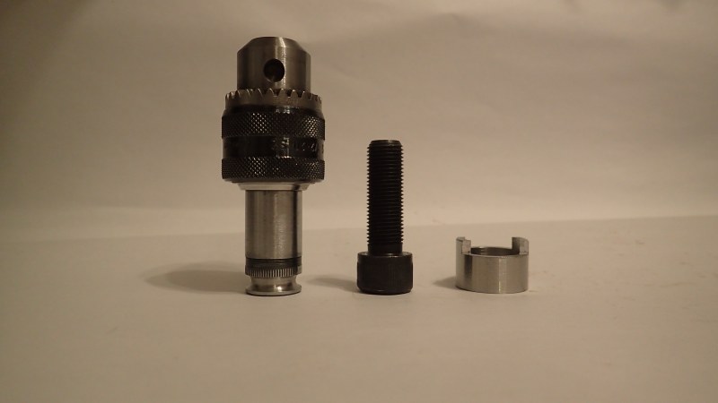

And some results. QC drill chuck mounts and releases.
First step.

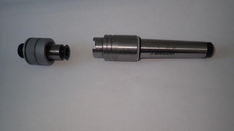

« Reply #14 on: February 12, 2019, 03:39:04 AM »
Next thing would be to make a short QC holder for these adapters.
I think I have figured out how this ball-lock works - appears that the balls are used to pretension the adapter "out" to keep adapter seated.
The original holder has some extensive travel in/out. Shorter holder has less space for it and when used manually on mill/drill pinole on drilling mode (against the spring pressure).
I think that a little provision for spring cushioned travel inwards would be a good thing. Or maybe a thick O-ring?
Any pointers here?

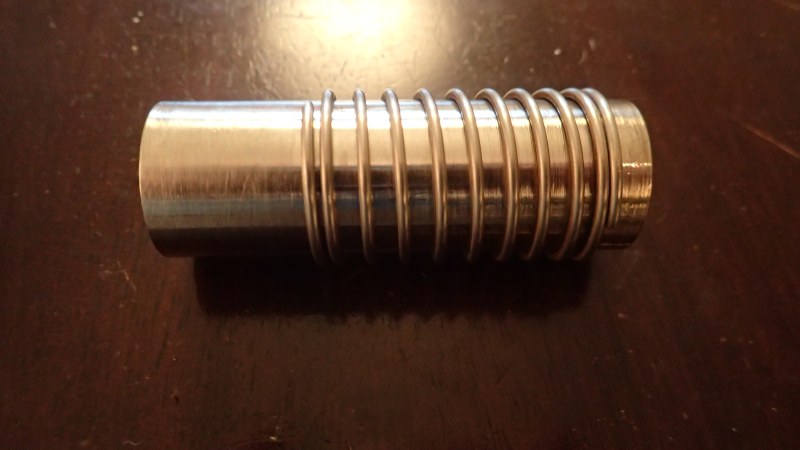

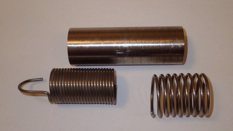

Got few hours on this one. I'm having trouble locating a fitting spring for ball lock. I need a spring that fits over 25 mm tube. I don't need too much force, just to press 5 mm balls into contact. Stroke is about 5 mm and there is 15-20 mm of lengt available.
Thinking of making a spring, because I can't locate this size compression spring locally.
Found this video:
Will piano wire work?
I have always thought that spring needs heat threating after winding.

It did not go "As seen on TV" at all.
1: Only "musical wire" I found was 6m of 0,5 mm piano wire. Way too thin for this one.
2: Mandrel calculator or table (could not find metric) is good, found this one:
https://www.daycounter.com/Calculators/Springs/
Anyway decided to try this and produced four "springs", none of the succesfull on any application. But good learning experince.
Now I attacked to one pull string to make it larger and transform it to compression spring. Nearly correct size.....just OD should be ID and it is of wrong sex.

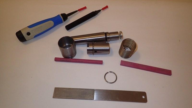

All starts with a wrong type spring that has right wire size, but is bit too small: OD25 mm, ID21 mm over a 28 mm OD pipe. Whole set into 290C oven for an hour.
After taking it off OD grew to 29,5 mm and ID 25,4 mm. Interesting.
Little deburring and parts start to look ready to assemble.

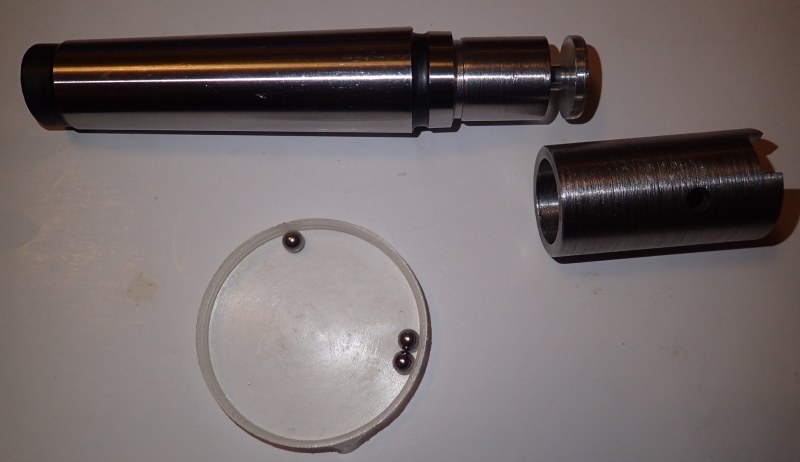

Turned a simple bushing to keep the spring from doing springy stuff and to locate the sliding /locking outer bushing in check. Simple job made out of acetal (POM) and then it was time pres the locking bushing into MT arbor.
It works better than I expected, spring forces are good and ejection of the QC-holder is positive but not with terminal velocity.
Nice excercise and learned bit more about the springs.
