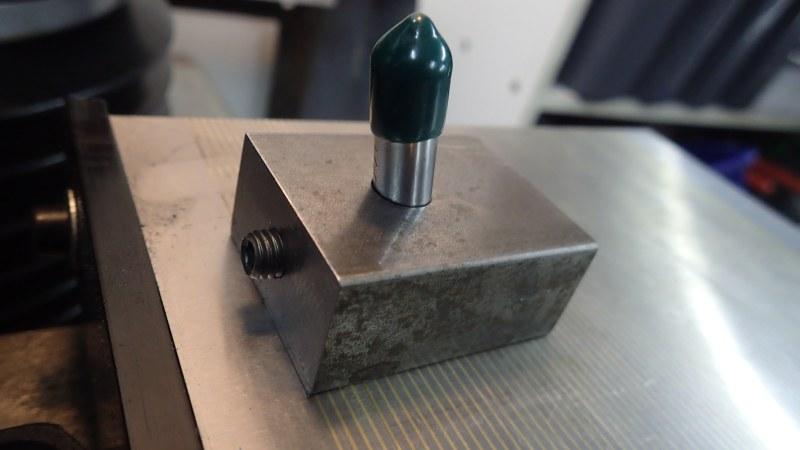

Need an idea how to true accurately grinding wheel on vintage TCG.
Immediate need is very simple holder that will be mounted on table T-slot or magnetic chuck.
Any pitfalls? Any advice?

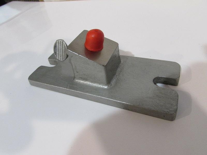

Mine seems identical to the photo below that I found on ebay, but the ebay one is a stupid price and in the USA. I seem to remember mine came from Cromwell but it was literally 25 years ago  :bugeye:
Simple enough to make
« Last Edit: January 29, 2019, 12:08:48 PM by awemawson »
Re: Truing diamond holder for TCG for surface grinding
« Reply #2 on: January 29, 2019, 07:17:07 AM »
That looks simple enough. The thumb-screw it to turn the diamond and prevent one sided wear?
« Reply #3 on: January 29, 2019, 07:43:17 AM »
Well it just holds the shank of the diamond - I suppose being a thumb screw makes rotation easier. Before I had that gizmo I just had a block of steel with a suitable hole drilled in it, with a locking grub screw - I think it's still floating about in my grinding cupboard even after all those years  :med:

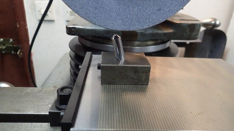

  I use a simple diamond holder.. Must also have angle/radius dresser in your kit...
First step to true the wheel. Gobbled up this one.
« Reply #6 on: January 30, 2019, 04:27:52 PM »
It'll do fine  :thumbup:

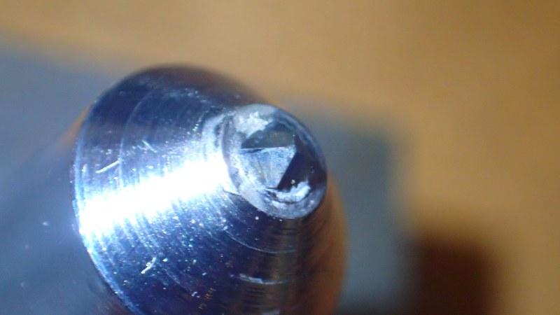

And it has worked - in several ocassions.
I was thinkking of "stocking up" few truing inserts and took a picture of the I have to assess the wear of it. Not much wear, clearly used, but still usable. However, it does not look like a "diamond". It was cheap, butt description said "diamond truing" etc.
No problem, because it seems to work on "blue" wheel.
BUT: Is there a prefered type of these or any ebayspecial will do?
Thank you

If it's harder than the stone then it'll work. No need to use the Crown Jewels  :thumbup:
« Reply #9 on: February 10, 2019, 09:27:23 AM »
Yea-but. No-but. :lol:
This is fine for this aluminium oxide - tested. But I have silicon oxide and harder wheels. Thinkking ahead - you know :)
Offline WeldingRod
  • Posts: 401
« Reply #10 on: February 10, 2019, 04:05:01 PM »
The black diamonds are actually better for this than the clear ones.
Kind of hard to tell what the element is.  If it looks natural, you've got a real diamond, and it will true anything.  Of it looks actively sharp, you might see if it conducts electricity.  Carbide does, diamond is sorta, maybe, if its doped... but mostly not.
