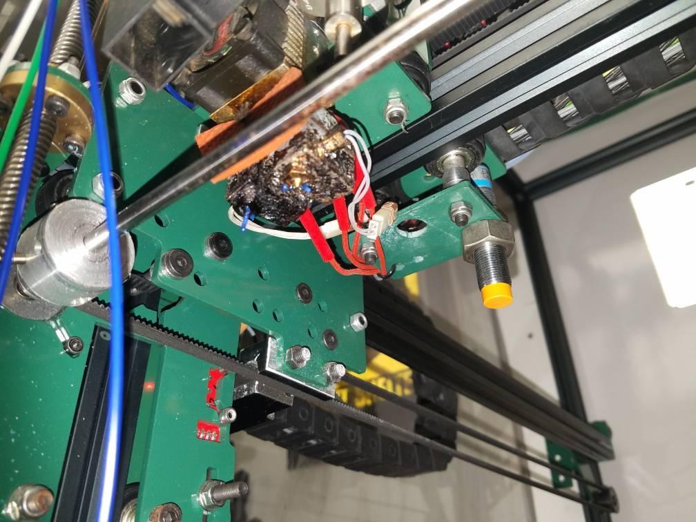

Offline WeldingRod

Here's the bottom plate of the print carriage

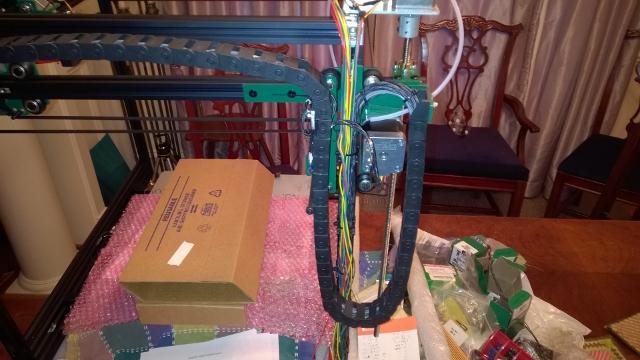

Once your bot is running properly, overnight prints aren't a big deal.  You might want to add a filament run-out sensor; my last epic print took about 48 hours and spanned three rolls of filament.  If it runs out and the bed hasn't cooled, you can just stop it, pull the SD card, lower the head till it just touches the last extrusion, and delete everything from the gcode file before that layer height, then tell it to print.  That way you keep the zero point!
Cable chains are CRUCIAL to long term printing; glad to see you fitting them!  You have to be sure those dratted wires don't get caught!  Yes, straight chains are MUCH easier to thread.  Use fine stranded wire in them, BTW!
I run mine in the same orientation you are using.
I highly reccomend having a spring loaded build plate.  That way if you crash into it it can move away and maybe not booger up stuff too bad.  Ask me how I know...   https://madmodder.net/Smileys/default/confused0068.gif
My brain and power supply lives in the left corner of the base frame.  You can slip a piece of fiberglass in on top of the base cross bar and screw it down to create a cavity that is partially isolated from the hot cavity.
Mine has feet screwed into the bottom of the Z rails that raise it a bit.
I think I've posted pictures of the Z before, but here's a fresh one.  I had the X and Z cable chains as one continous chain, but connected backwards at the X/Z junction so they bent the other way.  The flip happens at the one with the "X" on the side.  The end of the Z chain is a leftover plate that I bent to shape.  I might have had a few laying around ;-)
