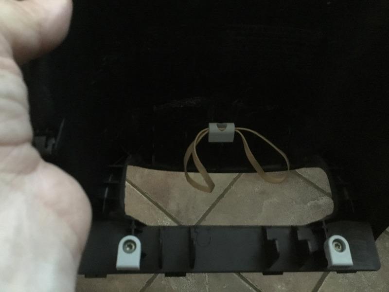

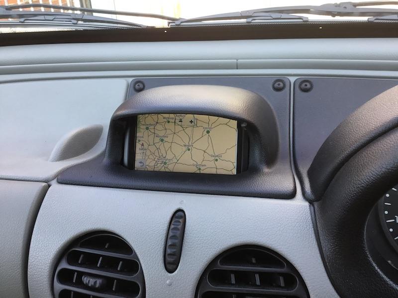

Another dash cam mount, and making the GPS less obtrusive.  The last couple of long-ish trips out have been a pain with GPS and dash cam suckers falling off.  Todays job was sit down and design some bits to sort them out.  The in built car radio packed in ages ago so we bought a replacement, but it left the display on the dash that annoyed me.  Hmmm some plastic butchery removed the display, opened out the moulding and fit some printed clips to rubber mount the GPS.  It's not pretty, but a lot more useful than the broken radio display it replaced and not obvious it's a GPS.

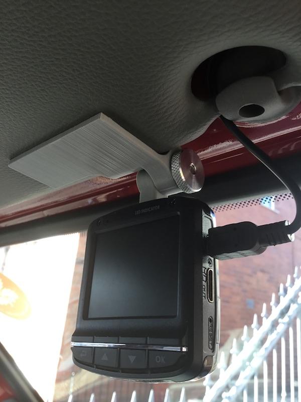

Attention then turned to the dash cam.  We have previous experience here with PLA roof lining clips going soft in the heat (PETG is a good solution), so this time I had to come up with a better idea.  My other half has opted to wear her sunglasses in the passenger seat, so that means I have the sun visor to play with.  It's set far enough back that it shouldn't get much sun and the clip is designed to slide into the map sleave on the rear.  A 20mm stainless bolt was used for locking the adjustment and a turned and knurled nut locks it tight.  Being set back it doesn't obscure the view, and no sucker on the glass.  I also had fun with strimmer line using it to thread through the car body work so I could pull the power cable through, all you now see is a short cable coming out above the mirror.  Looks a lot neater especially as this car is pretty basic and no interior lining to jam the cable behind.

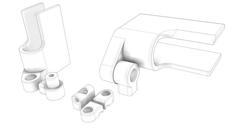

I have added the CAD and STL file to GrabCAD if anyone is interested for the sun visor mount.
https://grabcad.com/library/dash-cam-visor-mount-1

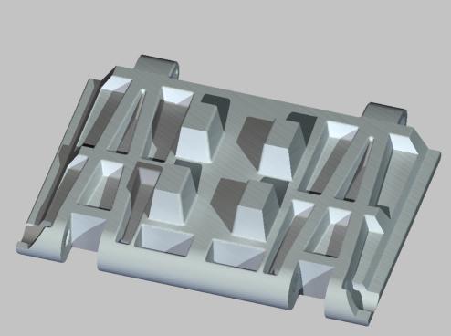

As you said in your last post most of what has been produced, outside of manufacturing industry which may have money to spend, is absolutele rubbish, with no purpose than to satisfy the operator's sense of achievement.
I am beginning to feel my way towards making some items which will be useful to me. My first priority is to make the track plates for the Ruston Excavator I have started. There are about 66 of these plates which are just crying out to be 3D printed. I think I have solved the strength and abrasion resistance by choice of filament and settings, but as yet I have not been able to consistently 3D print them. (A holiday in hospital did not help)

Jerry, nice start...  more information on your printer and filament you use, what temperature, layer height do you print at.  Some of those details look quite fine if this is a small item.  Consider bridging between small parts of your print and cut them away afterwards, as small detail can get dragged about if it is still warm.  Another thing to consider about bridging between detail, the bridge acts as a continuous path and so reduces stringing as it should all be in the bridge.  Just make the bridge a fraction wider than your nozzle diameter, so maybe 0.45mm.
