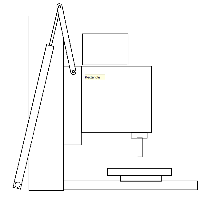

Having now seen your drawing what I don't understand is the linkage between the end of the cylinder rod and the vertical slide! Unless I'm missing something obvious the link will always end up in line with the cylinder rod if all three points are supported by bearings allowing free rotation.

The linkage is because the shortest height of the cylinder is larger than the attachment point distance to base. The overall length of the cylinder without extension is about 4" greater than the top of the z axis column slide at its lowest position. This is the part I have some concerns about as I don't want any bending stresses on the cylinder.

In which case why not make the linkage fixed solid to your z-axis and offset so that the cylinder is always parallel with the slide?

That was my first thought, just a hanger off of the z axis head plate. But I wasn't sure how the turning moment would affect the head movement as it is applying a clockwise moment exacerbating the large turning moment caused by the head. It may be that I can align the base of the cylinder close enough that the effect will be of no consequence. Using the linkage the force will exert a slight counterclockwise moment.

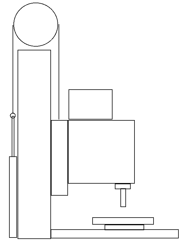

Having thought about it a bit more I think the following ticks all of the boxes. The bending forces on the column are minimised and there is little additional mass to accelerate. A single 32mm cylinder should do the job. It looks a bit crude but the functionality should be excellent.
Best Regards
picclock

Looks better but...... the Z-axis on my CNC (which is based on an Alexander engraving machine) lifts the knee and X-Y table via a 2505 ball screw and I don't have anything to take any weight off. Are you sure you'll need to do anything? Much heavier machines (e.g Bridgeport size) lift the knee and table without cylinders, counterbalances or gas struts. The other thing to consider is that, unless you spend a fortune on zero backlash ball screws, balancing the weight of the head will mean that you may see more problems with a counterbalance than without. Just my opinion - I'm happy to be proved wrong.

You second drawing is similar to a design I saw that I wanted to emulate for my mill. He had hid his inside the column.
I will see if I can find the link.

The mill head weighs around 40kg. Downforce needed for drilling/milling is a lot less than this 10kg tops and likely zero or -ve for side milling I would guess. By counterbalancing the head the bending forces on either side of the column are nearly equal. This should result in reduced flexing for different head heights. I'm quite tempted to balance the head such that it is driven down by the motor. Because of the simplicity of the setup and ease of adjustment it will be easy to see if any benefits accrue from this.
@brass_machine
It crossed my mind to do that but I'm happy to leave it outside like this. Its  easy to belt drive the ballscrew from a motor behind the head.
@Philf
The issue with these "benchtop" mills is their lack of rigidity. With larger industrial machines you are not going to see much deflection when the knee is in a different position. With a column mill the bending forces and flexing which occur due to the head weight are significant. This will go a long way to eliminating this.
