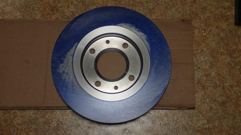

I have worn Mahr 800*600 mm granite plate. Thinking of using that one to scrape disc brake rotor relatively flat, then sprincle that with diamond flour and lap the offending granite plate bit more flat.

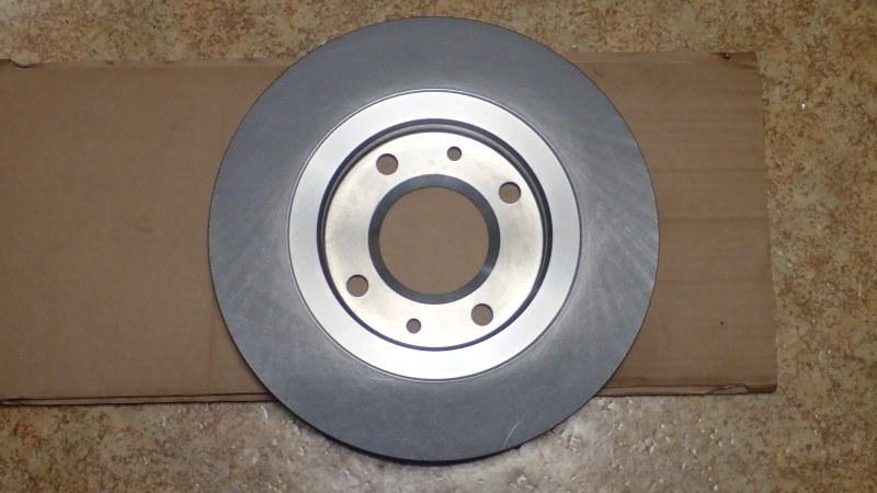

Last summer I almost made a try, got some diamond dust and started finding a appropriate lapping plate for granite lapping. I would not bother if I only had to lap one surface plate, but my long time intention is to make some measurement jigs and tools from granite.
I thought that cheapest semi ready lapping plate might be a car disc brake rotor. Bought one last summer and it got put away.
So I digged it out od storage yesterday and took it inside to warm up (it is unseasonaly warm here, -12C).

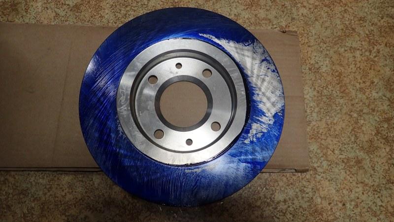

Blued and lapped 10 minutes today. Looks like a little more lapping and then it might be a starting point.
