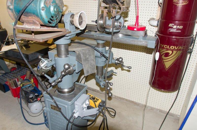

I finally have Cincinnati No. 2 Tool & Cutter Grinder somewhat operational and done some first grinding.
Next step is dust removal. I tried normal wet and dry vacuum cleaner and manually holding the nozzle, seemed to work somewhat but if will not be real and final solution for several reasons. I have 2,2 kW fan for high flow/low pressure system it has 160 mm dia inlet, and nearly 400 mm impeller. Blows socks off and makes a lot of noise.

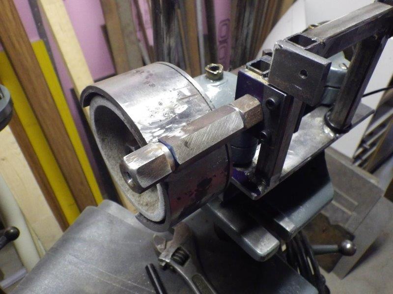

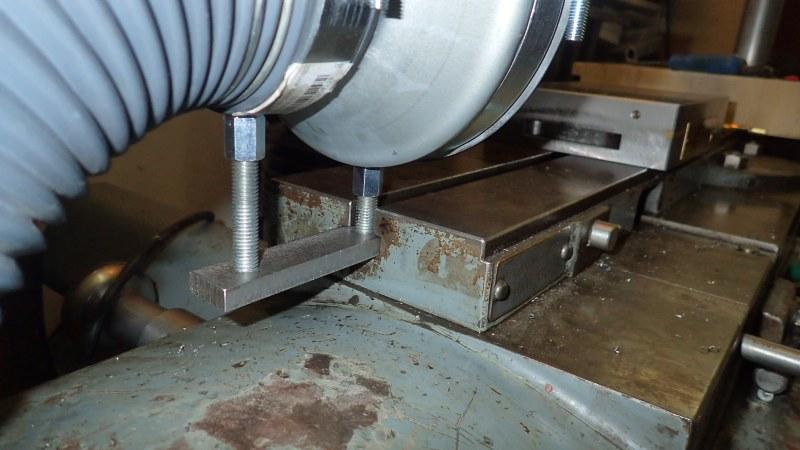

Attached is a pdf extract from my uncles notebook on dust exhaust etc. He worked at Kiekens in NL in the 50's-70's.
The Deckel S1 manual has other examples of dust collection: http://cncmanual.com/deckel-s1-universal-tool-and-cutter-grinder-operating-manual/
My 1900's Cincinnati Universal grinder came with no wheel guards. I made one using a 3" pipe with segment cut out, hammered into appropriate radius. Once it gets a front plate I will be adding a dust port attached to a cyclone and used central vacuum.

That chute looks like is stationary to wheel head, i.e. table moves under it, that would place it closer to debris shower, but might interfere with magnetic table and other small stuff I have on the table. Data looks interesting, if I got it right...125 mm duct and 6,5 m3/min ref. that to wood working chip/dust fan and we are close to 2kW beast. No doubt that would do it!

125mm is the wheel diameter (schijf diam). Vin is the expected speed of the airflow. The angle of the chute opening and its length determines the efficiency of airflow. A fairly short chute is more efficient.
With the flex hose (slang) hanging from above you could mount the chute on the table.

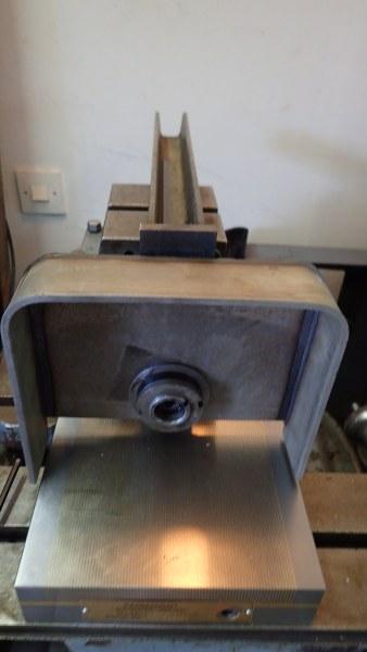

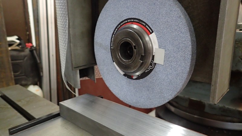

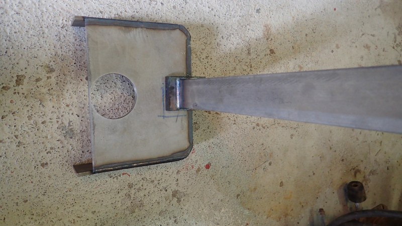

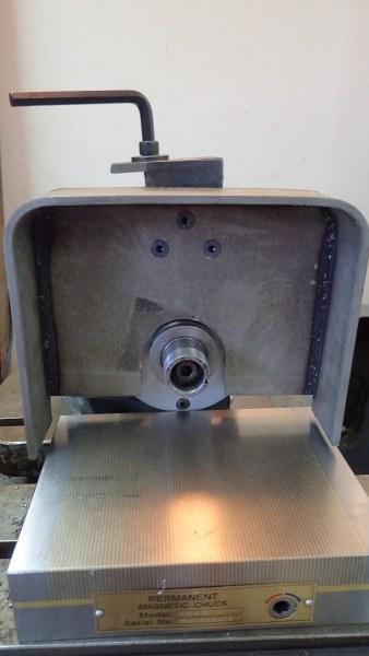

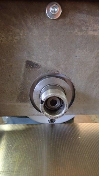

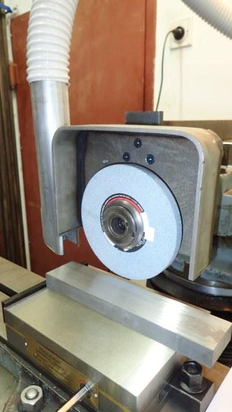

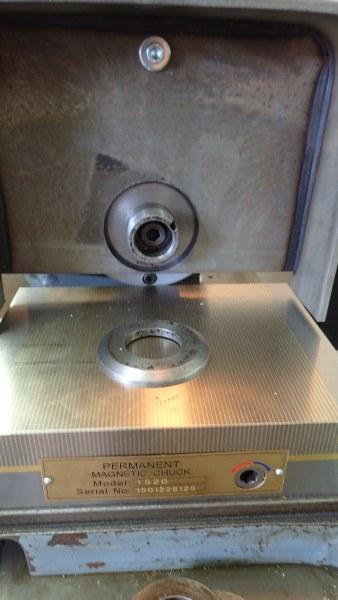

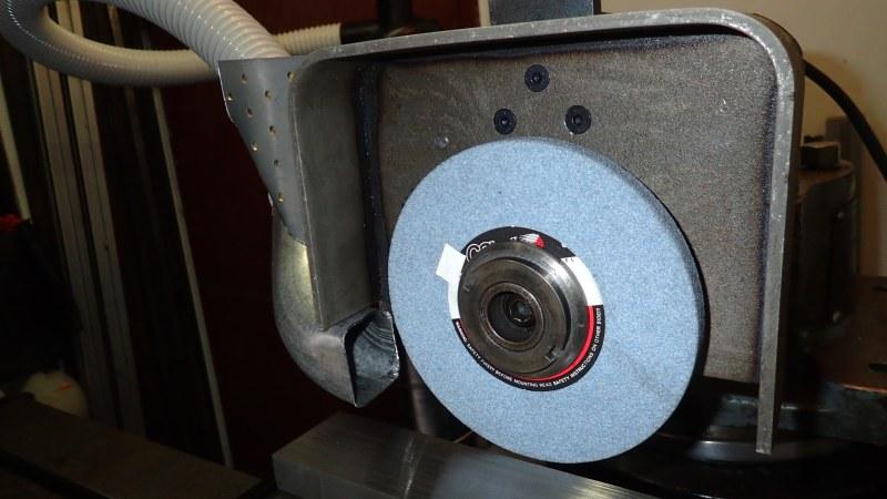

And after cleaning my garage, followed up this work - wheel guard for surface grinding
Most importat feature is that the larges wheel will fit in comfortably. I designed the parts around that assumption. However some material was bit marginal on width (plenty thick!) and I changed the design on the fly....when welding had one dimenssion +20 mm on wrong way...left whole less margin for mounting :hammer:
Therefore I need to revise the order I put parts together. Pretty much just draw a c-c for the wheel on guard and that determined where I made about 50 mm hole with hole saw - size had to be big enough to clear the wheel mount but such that I could use one pair of mount to centre the guard to spindle axis AND then use that location to mark and fix the mounting.
Got pretty close, drilled and taped M6 hole + ample clearance hole on the guard to make it possble to fix the location. Clamped parts in situ and then drilled, tapped, and countersunk the parts.
Looks fine - time to open the centering hole to allow mounting the guard without any need to remove the wheel.
I have three alternative places for suction. Going to check one 100 mm dia with cheap dust extractor to see if that size is ok or I need to find the space to fit one 2.2 kW fan that is scary noisy and probably very much of overkill.

Went garage and failed to do next two steps :thumbup:

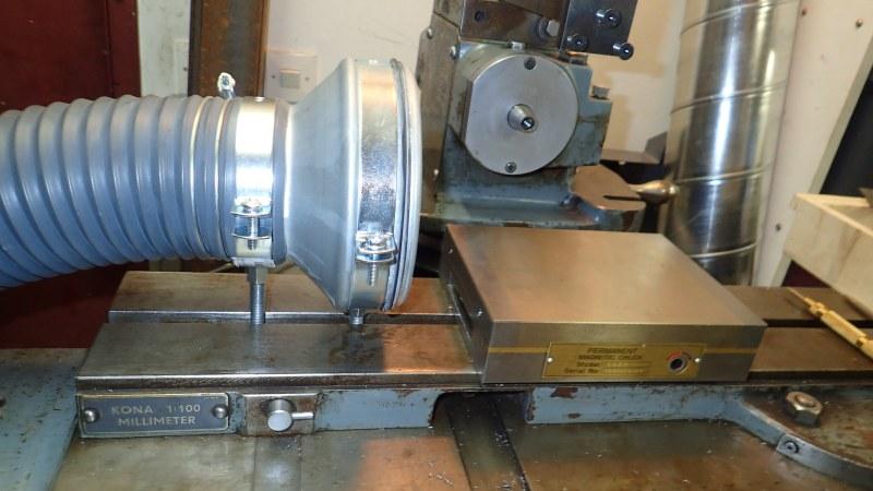

1: This guard needs a detachable front cover. I have two design nin my mind. I can't deside if it should be hinged on the the top (stays open when swung way back onto spar) OR detachable, pins and finger screws. Tried to find 3 mm steel plate and had no apropriate piece, need to put that on my shopping list.
2: I have to deside over dust control, I have a plan B (50 mm pipe for flexible hose front of the guard), plan C (50 mm pipe at the back side of this guard, exiting axially to spindle (most compact, and propably least efficient).

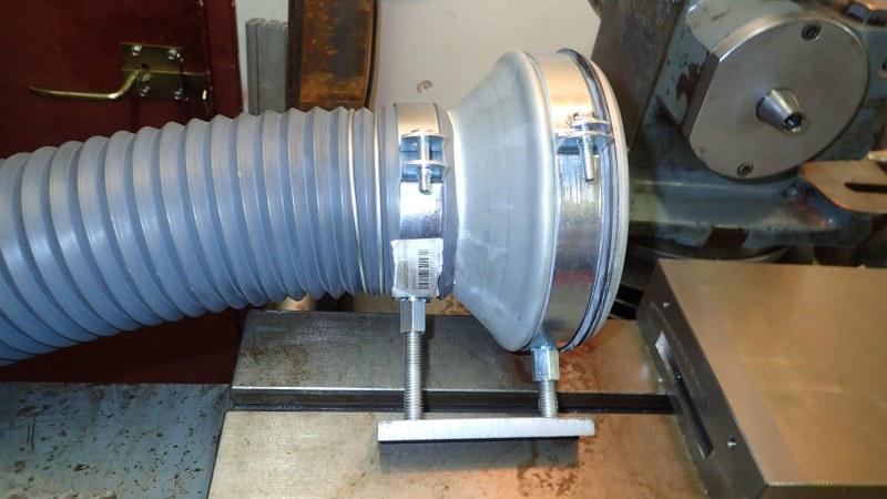

Plan A is to attach a chute with 100 mm flexible hose near table and near guard. There I have considered two options
A1: Fixing to grinding spindle mount. Overarm and hanging down. Plus that it can be placed near the guard (gringind wheel) and will probably provide good dust removal and easy hose routing. Minus from needing an articulated arm or other means of adjustment. Fixed mounting is going inerfere with magnetic chuck or piece eventually.
A2: Fixed to table. Plus is simple mounting and it can't interefe with magnetic chuck or clams under grinding inadvertdly. Minus is that when grinding the long pice it will be at the other end of the table....
One mounting method might not be eneough....I am nutating between these two.....thinking which one would be the first I need. Probably will try the A2 first, because it is easiest and gets me working fastest.

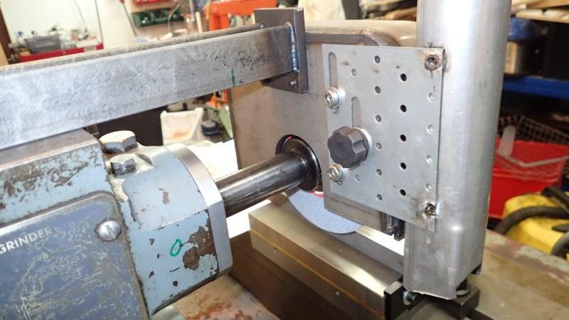

A2, something like this?
Re: Dust control for TCG and surface grinder
« Reply #9 on: July 28, 2018, 03:31:58 PM »
Went on one 50:th Birthday and got some time after it.
I stared the parts and I thought that I got pretty good idea how to mount the duct on table most easy way. M10 threaded rod and flat bar milled to dimenssions and threaded M10.
I was thinkking of using a M8 knob to attach it, but cam might be nice to make for a change.

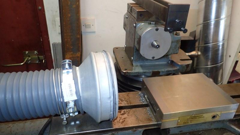

Tested this 100 mm hose and 160 mm funnel with saw dust extractor.
On positive note:
+ the extraction is good enoug i.e. fan pulls most of the grinding dust away.
+ no sparks escapes
However:
- a little of dust escapes and deposits pretty far....I wiped the surfaces and found some black dust more than meter back
- noise of wood chip fan completely overwhelms the grinder
If I continue using this fan, I need an all metal separator can and have to put some filter element on exhaust, the standard clothe bag is not very efficient.
I am going to test with a small, but better design and location nozzle, because I have a cyclon separator for it and shop vack is smaller. I am going to see how it is different to larger air volume system.
Now my main concern is to prevent dust from spreading everywhere....completely separate room is not possibility and curtains would take up some real estate even when pushed out of way.
I wonder how much it would help to put a self (and fire resistant board) at the  side of the grinding machine. I could move some stuff around and not to loose too much space.

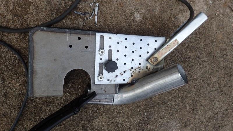

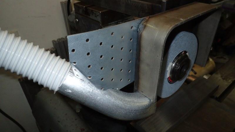

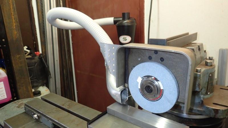

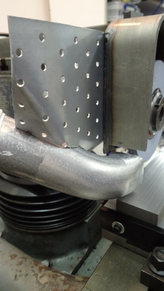

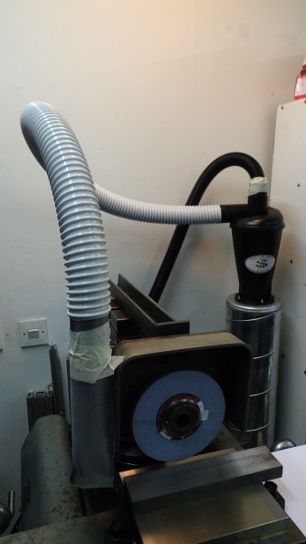

I am thinkking of turning one cabinet sideways and putting one welding curtain to isolate partly 1/3 of garage when I do grinding, but first I try to get is behave well in first place.

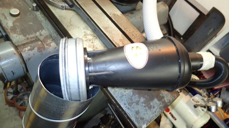

Today I tried a different approach:
Shopvack
50 mm dust collector as close to spark fan as possible
Cyclon separator
Well, Results are inconclusive:
1. That collector is really close to "action" and even though airflow feels small it seems to coller really well
2. there is more dust on the grinder table and magnetic chuck than on previous test with 100 mm hose and funnel collector on the table. BUT less dust (hardly noticeable) one meter away from the grinding machine :scratch: I had some paper sheets to collect the grinding dust on the same places than before. I don't get it.
3. The cyclon worked really well, it collected all that got into nozzle, there was absolutely nothing int the vacuumcleaner.
« Reply #15 on: August 07, 2018, 02:14:43 PM »

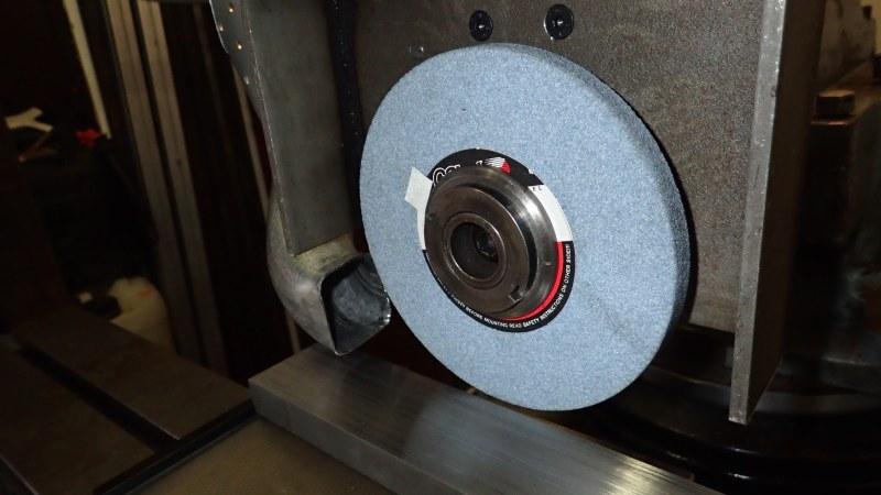

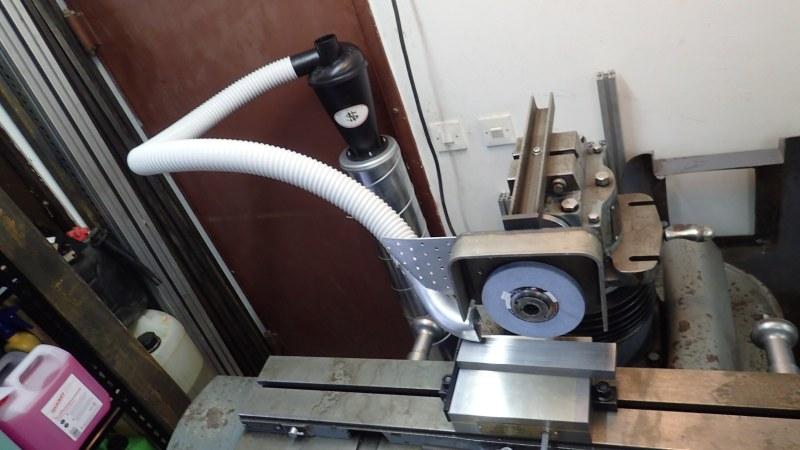

There is a temporary plate at the front of the guard (I removed it to take pictures), there seem to be whole lot less "sparks" bouncing of the guard with this nozzle attached to guard - compared to prevous test.
Another variable is that this nozzle is at constant distance from the grinding wheel and very close. The funnel was at the considerable distance on the moving table.
I only have a stick welder, I could not finish this 50 mm nozzle and I noticed that it is very imprtant to get the nozzle head on to spark spray. I put some PVC material and observed that it took a direct hit. Nozzle needs a little more projection at the bottom.
Wonder if I could locate the 100 mm hose stationary close to guard and build a simple pre separator for it.
Annother thing is that there is a rubber lip on Gerrit's drawing ... need something like this and maybe a brush strip type thinggy at the other three sides of the guard.

Tried to think this over.....
1. Sealing strip/brush....I don't want any hard material that would cause an havoc when piece of it will be sucked between part and spinning grinding wheel.
2. Flexible hose? I noticed that when I used a piece of PVC near the grinding stone it was fine, but at the exact spot where majority of the propelled sparks hit was caked and melted only after 15 min of use. This got me thinkking of the hose material.
Some rubbers are pretty good with abrassives, not all of them are good for oils (if I ever have temptation to wet grind for any reason), same for PU.
Aluminium corrugated hose is probably "yikes" for most obivious reason...think of iron dust, rust, dust, possibly oil or such previous machining + AL. Does anything comes to mind? :scratch:
There are some really professional materials, but really difficult to buy one metre I need (reels are 10 metres) and they are expensive!
I got a nice zap from the last experiment....that hose is not antistatic!

Few more tests and results are still inconclusive. I have now two very different avenues under construction:
1. Low flow, high suction (shop vack) and for it I am trying to build optimized suction nozzle. I did not anticipate it to be that much work, but I took 45 degree angle, tilted, turned and when it looked right i marked and cut, then beat the other end square (1 hour on one evening) and tried to make bracket for it (2 hours another eveneing) still needs to weld it together.
2. High flow, low pressure system. Think of the cheapest & nastiest repurposed wood working dust extractor as a fan, body and boss for a big filter.
This would need a preseparator made out of steel. Any ideas?

Idea on this experiment is to place small diameter (52 mm hose size) very close to spark spray in such an angle that high velocity particles will ram right into nozzle, even thoug the air velocity would not be greatest ever. Secondary purpose is to have suction in the guard/hood to contain the particles that go around the wheel.
There are some compromises...when I originally made the guard I was considering making an union for suction into it, that would benefit from adjustable guard. I wanted to make guard pretty solid in case something goes wrong, so I ditched the idea of guard suction. With 5 mm hot rolled steel it feels a little excessive for 160-180 mm grinding wheels. But now that horizontal adjustment would be handy. I deed to make suction nozzle adjustable and I need to weld extra piece to noxxle to close thea cap that opens between the guard and nozzle when nozzle is adjusted for new or bigger wheel.
I tack welded with a stick to see if everything is aligned. Looks OK.
