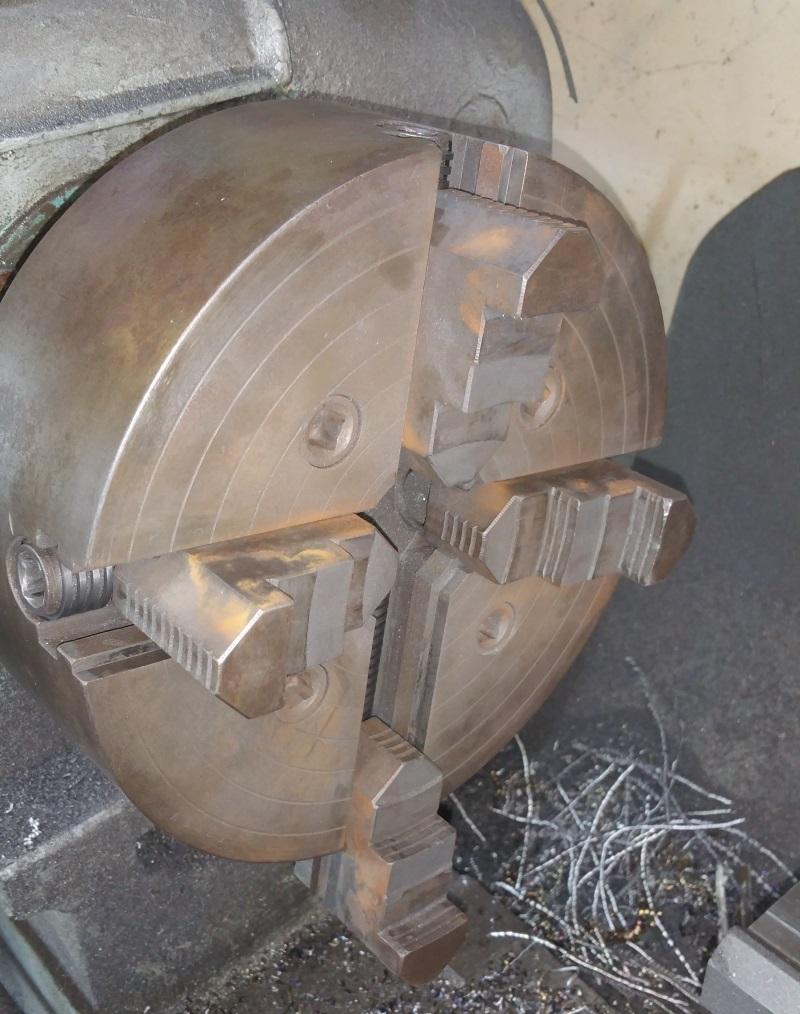

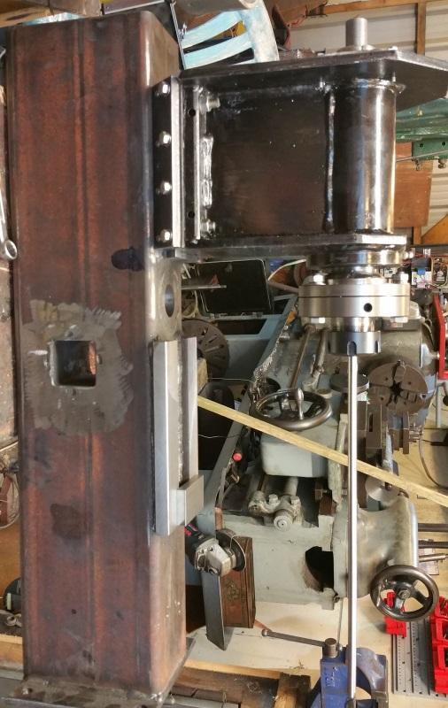

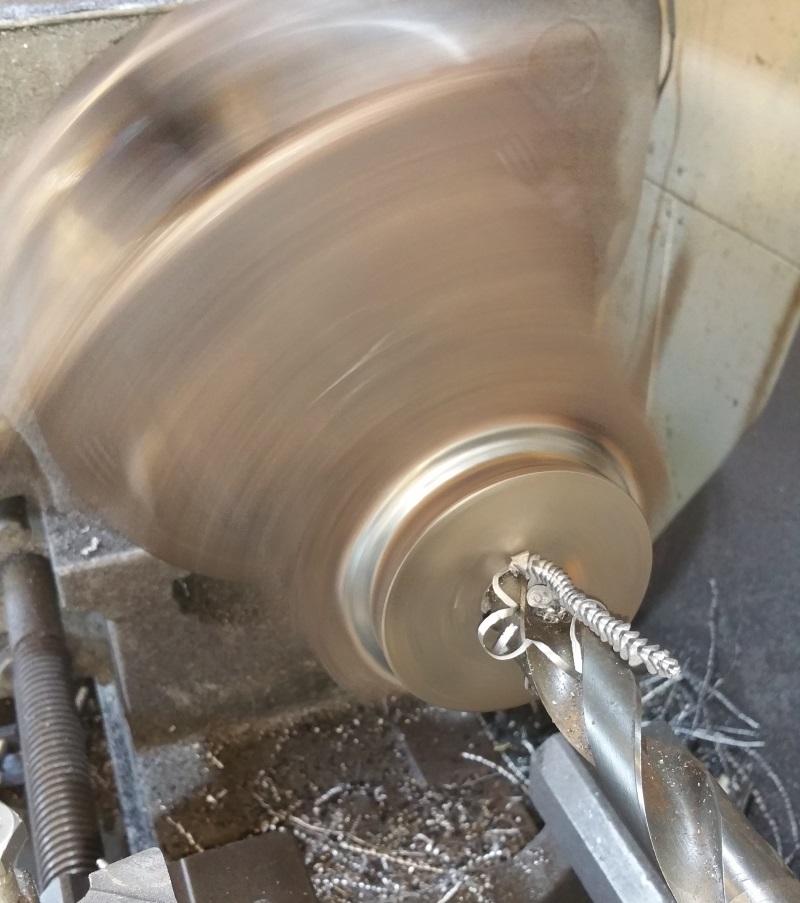

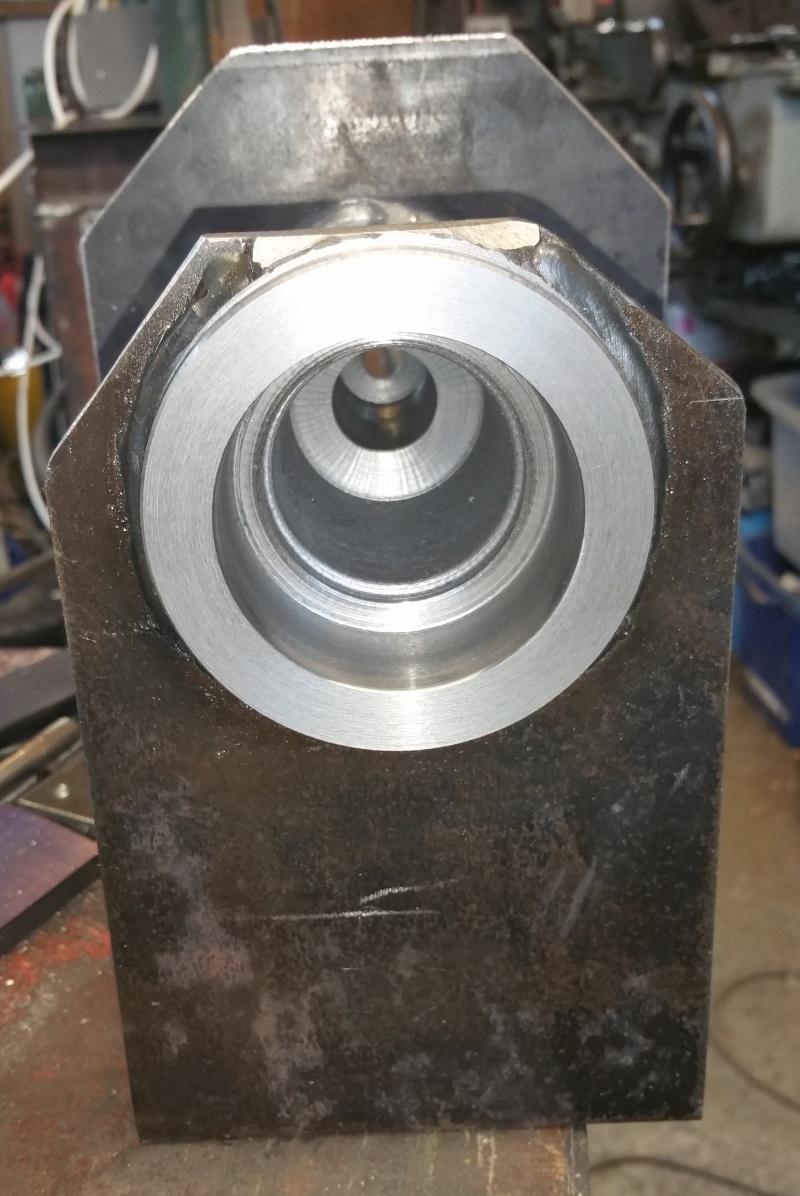

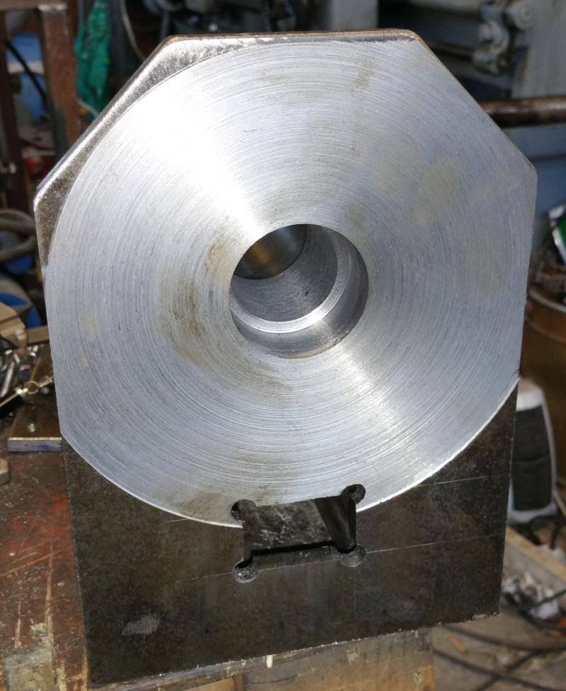

Today I started on machining the head but I had to cut a extra bit out of it to fit to the four jaw chuck, just goes to show no matter what you have its not enough my 4 jaw is 10" and when I got it off my uncle I thought it would be plenty for anything I would ever want to do in fact I think I am going to have to resort to the 14" faceplate to machine for the bearing in the top.
If I had tried without cutting the extra bit out the chuck would have been as shown in pic 2, not good but took a action shot of the first drill 25mm and finally the end result is a space where the bearing and a oil seal I ordered today will sit.
Tomorrow I am going to attempt the hard job of lining it all up to do the top bearing as i said probably on the faceplate.

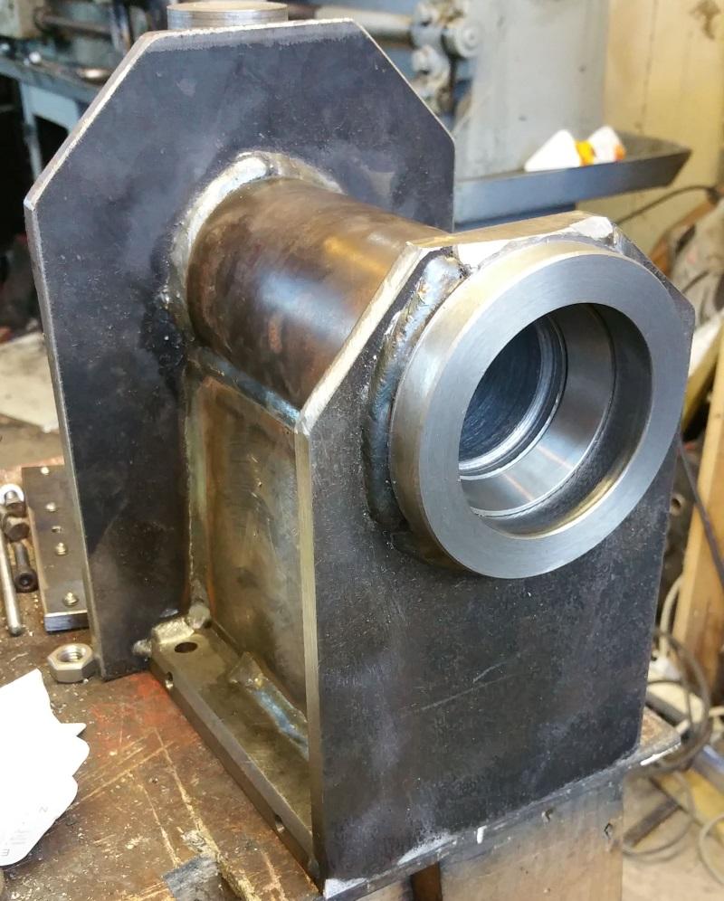

I managed to get the other side lined up, machined and get the bearing shells fitted however after I had put the last one in I remembered something. I should have made a way to get them out again if I ever need to  :doh:
Too late now however so fingers crossed it all goes to plan or the head will have to be remade unless anyone has any ideas?

Hi Shipto,
A run of weld around the inside of the bearing rings will shrink them when they cool
the rings then usually fall out
That or tack a strap across the old race and drift from the far end
Offline shipto
  • Posts: 874
  • Redditch, UK
Re: Another homemade milling machine
« Reply #29 on: April 02, 2017, 02:24:30 PM »
excellent suggestions John now I think about it a disc tacked to it would do great.

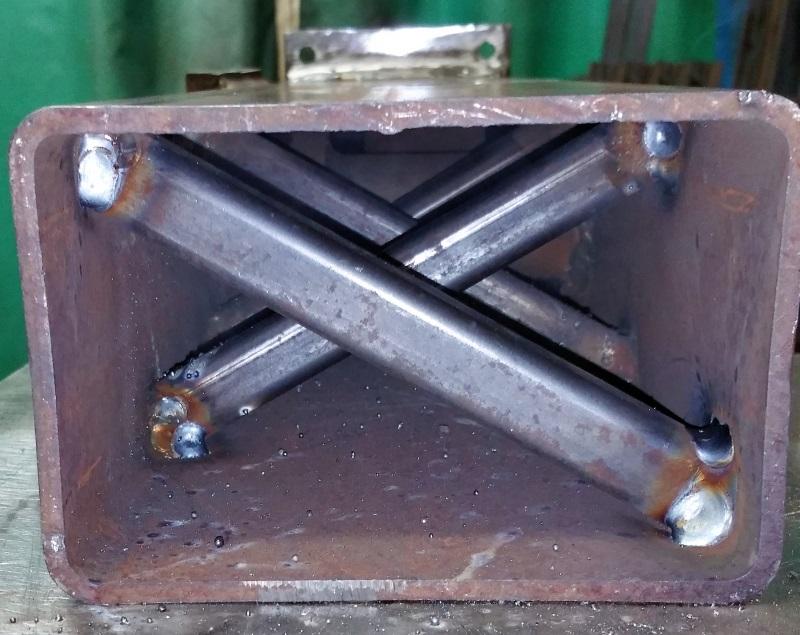

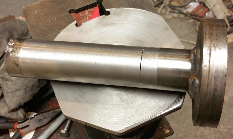

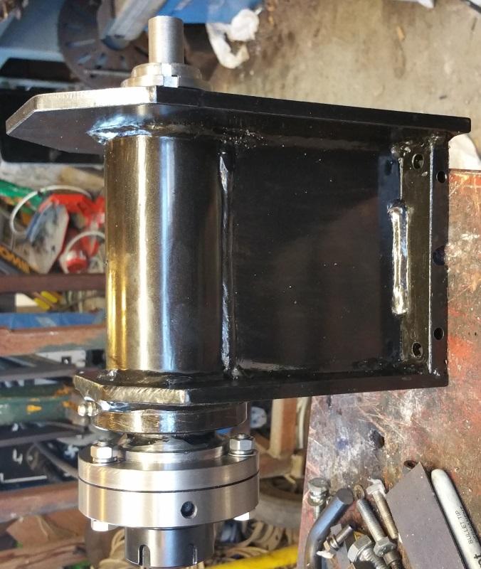

« Reply #33 on: April 09, 2017, 04:23:02 PM »

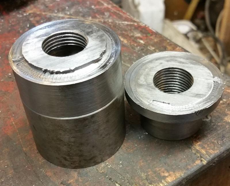

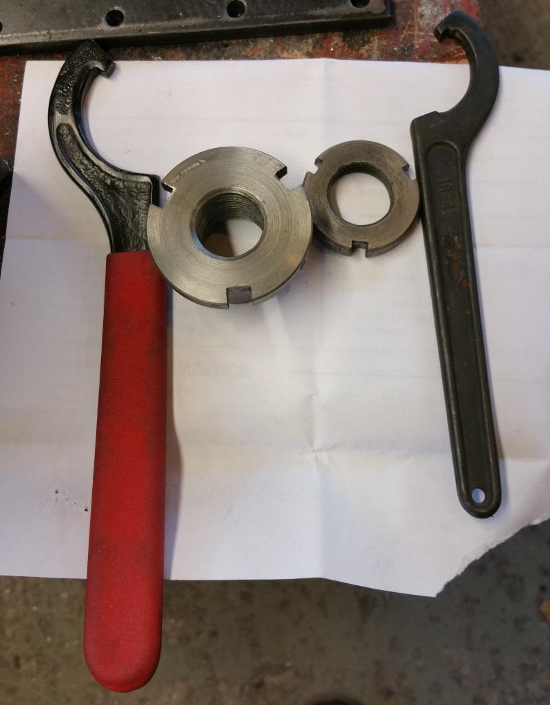

Well here in pic1 is the latest mistake It wasnt till I had welded the flang on, cleaned it up and centered each side that I set it up and did a cut along the length and I noticed it had been cut half way through  :doh: cant even remember what I started to cut it for.
Well went back to my bits of steel and started again and pic 2 is the result. I am very pleased with it this is the first time I have cut a thread and made nuts to suit which is where I was at the end of today and apart from my parting tool of sorts breaking part way through meaning I had to finish it on the donkey saw even this went reasonably well.
I still have to clean up the nut and cut the lock nut off the bar which is the job for tomorrow.

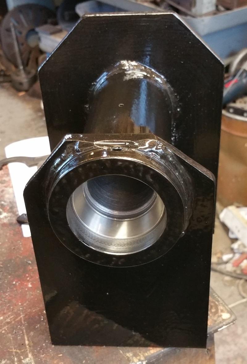

So today I finished the nuts and gave the head a lick of paint, I chose black because, well its was either that or white no expence spent  :lol:

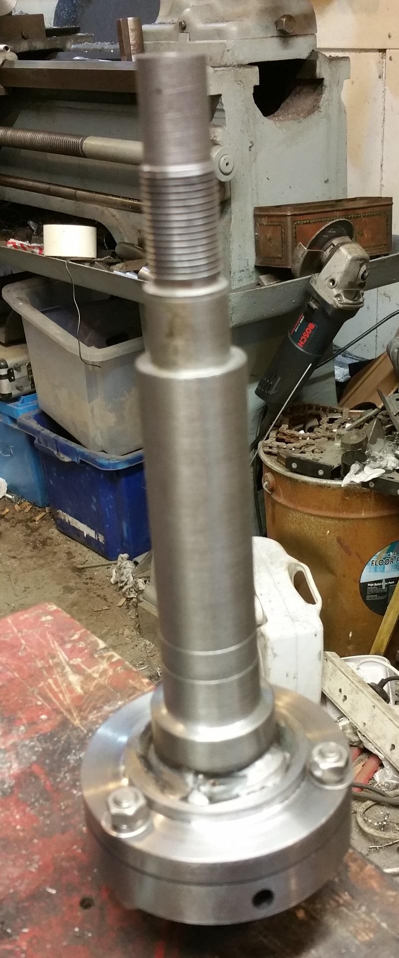

fitted the shaft and I am really chuffed with it rotated image so it in the right orientation just need to make a housing for the top seal but its got to have a channel for the grease nipple.

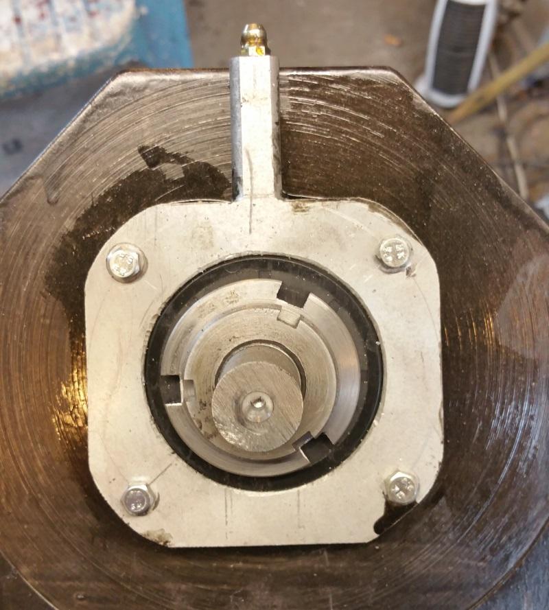

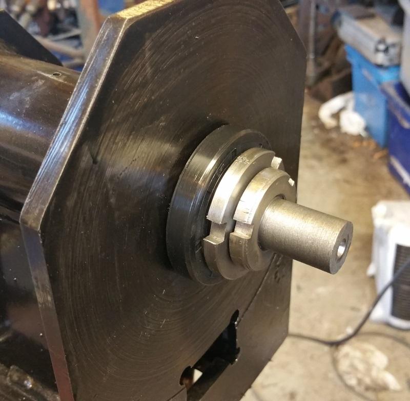

Seal housing is made and fitted and head is fitted to slide. Drilled the housing at a slight angle so the grease is delivered just under the lip of the seal.
