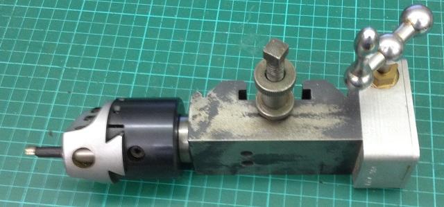

I have been using a Dickson quick change on my Myford for a long time but buying additional tool holders for it in my neck of the woods is beyond my budget, so I decided to change for one of the B2132 type from Busy Bee in Alberta the additional tool holders are only $27 which I can afford. The B2132 is designed for a 12 inch lathe. with a small modification to the compound slide however it works fine.
All I had to do was mill a step into the end and back sides of the compound slide. the one on the end is .25 x .125
http://i5.photobucket.com/albums/y169/my30mm/tools/IMG_1680x1024_zpspld55tt4.jpgsetting up my Myford with altternate toolpost
and the one on the side is .125 x .125
http://i5.photobucket.com/albums/y169/my30mm/tools/IMG_1681x1024_zpszv0epwug.jpgsetting up my Myford with altternate toolpost
I know all the Myford purists are probably gasping, but a tool that can be optimized for little expense seemed like a reasonable compromise.
I pushed out the Myford 7/16 post and tapped the slide 1/2 x 20 and machined the 9/16 end of the B2132 post down to 1/2 inch then threaded it 1/2 x 20 and then drilled and tapped the end with a 1/4 x 28 to put a locking keeper plate on the underside of the casting that was filled originally by the large end of the original Myford post.

I have started to set up a few tools now and what a difference it makes to not have to keep adjusting and switching tools in the holders. The knurling tool is a push type so it likely wont get used but the back end has a place for a tool that can be used for facing or boring.
The holder for the Morse taper that came with my Dickson set back in 1970 has never been used and the one that came with this new post likely wont see any either. Am I missing something here with this particular tool holder item?  I use the tailstock for drilling holes in material that is held in the chuck.

My Colchester has a 'T2' Dickson post, and over the years I've accumulated several of the taper holders. I can't recall ever using one for it's intended purpose (drilling, boring etc) but I have modified one or two for other purposes - the steel is quite workable if you anneal it.

The big tool holder in that set in my case is not a taper one, it is for boring bars. A taper one is available as extra elsewhere but is not commonly sold as part of the set. Yes, QCTP's are a wonderful invention.
