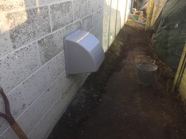

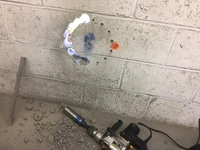

Current idea is to chain drill with my 50 mm diamond core drill, hopefully from both sides to avoid breakout. I do have 110 mm and 125 mm diamond tipped core drills, but the smaller diameter hopefully gets me nearer the circle that I want.
  • Posts: 9161
Re: Titivating A CNC Plasma Table
« Reply #127 on: January 17, 2017, 07:43:23 AM »

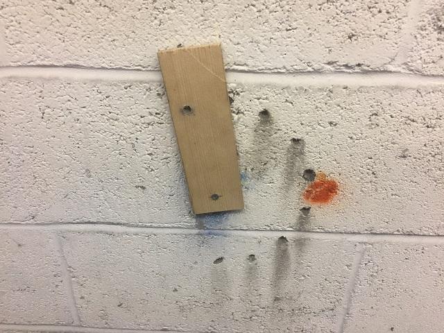

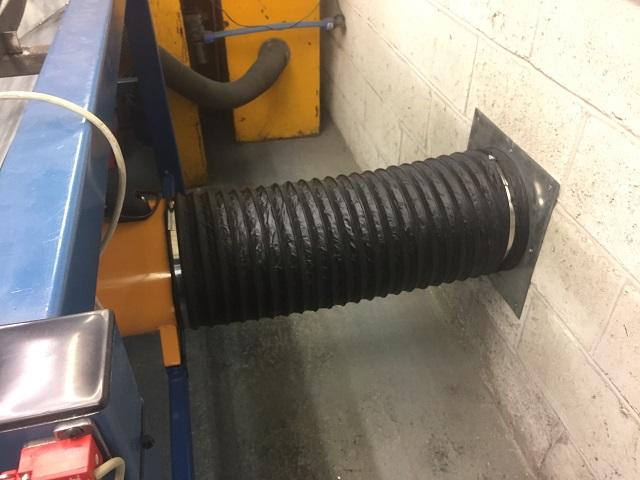

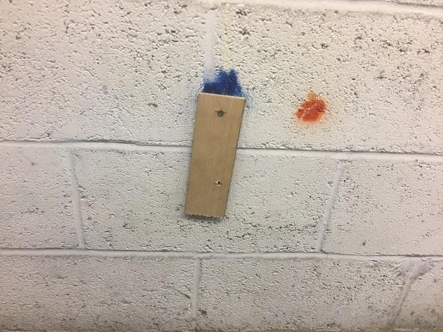

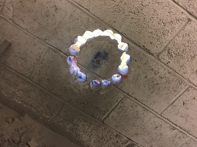

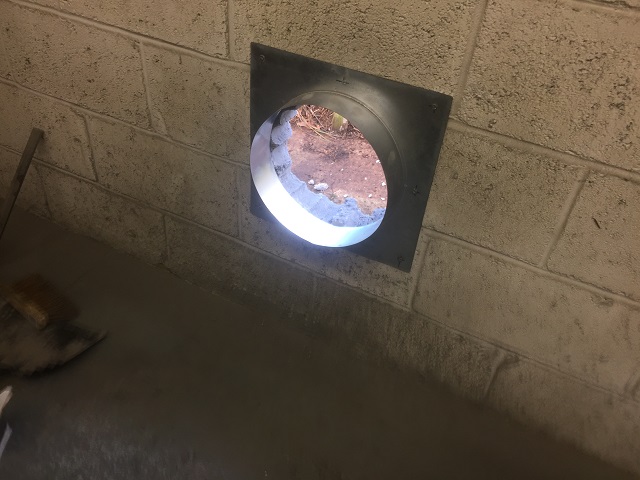

This morning I attacked the wall.
I'd thought long and hard the best way to space 2" diameter core drilled holes reasonably accurately to give a 12" 'wobbly edged' hole, and in the end I came up with the patented angular hole spacer. Simply a bit of wood with two holes spaced 5" apart, one being 2" from an edge. One hole was used as a pivot, on a screw in the centre of the hole, and the other was a guide for a masonry drill. Drill one hole, then rotate the spacer so that the edge of the gizmo lines up with the last hole, and drill another. Worked like a charm  :ddb:
I then drilled these hole out to the guide drill size for the diamond core drill, and drilled out the core - it went remarkably easily, with the expected conical break out on the far side.
Then it was just a case of fixing the inner wall plate and outer cowl, and connecting up the 12" heat resisting flexible air pipe to the extractor fan on the table.

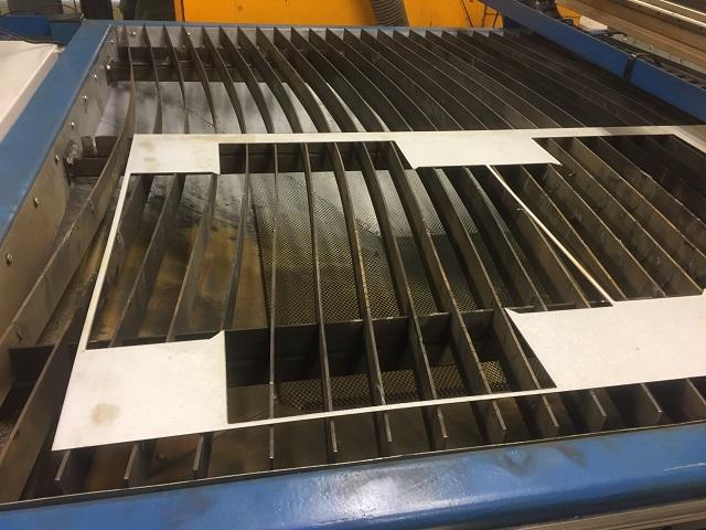

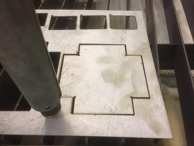

Well oddities abound - all excited I loaded up a sheet of 3 mm mild steel (zintec coated) and set it to cut out a 'bearing baffle' that I'd previously designed and cut on the table before I started updating it. It started off ok, measuring Z=0 and setting torch height, but when the actual plasma should have been initiated, movement stopped and the Hypertherm 45 displayed an error light showing 'loose consumables'
In the guts of the machine torch is a micro-switch that closes when the consumables are tightened onto the torch - I buzzed out the cables to the plug and everything was fine - closed when tight - open circuit when loose. Nothing to do with the CNC controller, this must be an internal issue with the Hypertherm - maybe something I disturbed when I remade the plasma voltage cable :scratch: . So I pulled the torch and cutter off the table, opened up the Hypertherm, and buzzed the switch all the way through to the main board - no issues. Put it back together and back on the CNC table, and tried again - same issue  :bang:
There is a button on the screen allowing me to trigger the torch on and off manually. Out of curiosity I clicked it, and initially there was a very weak release of compressed air - I did this several times then the torch fired up, no errors and full air discharge. I've come to the conclusion that the air solenoid in the Hypertherm was perhaps sticky and has now cleared, but why that should make it report loose consumables is a mystery  :scratch:
After that everything worked as it should - very odd. So here is a video of it cutting, and a picture of the result. Not surprisingly the cut quality hasn't improved since I did the re-build, but that's due to worn consumables and non-optimal cutting conditions controlled by program. Also there is an issue with the cut not ceasing fast enough at the end of a feature - I need to tweak the post processor to stop the arc marginally before the end of the feature to eliminate the nick it's producing.

Bucket was carrying away the spoil from knocking the 12" hole in the wall.

How's the extraction?
  • Posts: 9161
« Reply #136 on: January 19, 2017, 02:35:27 PM »
A major improvement Matthew  :thumbup:
No longer does the welding shop fill up with a noxious fumes. Not sure about that pile of bodies accumulating outside though  :lol:

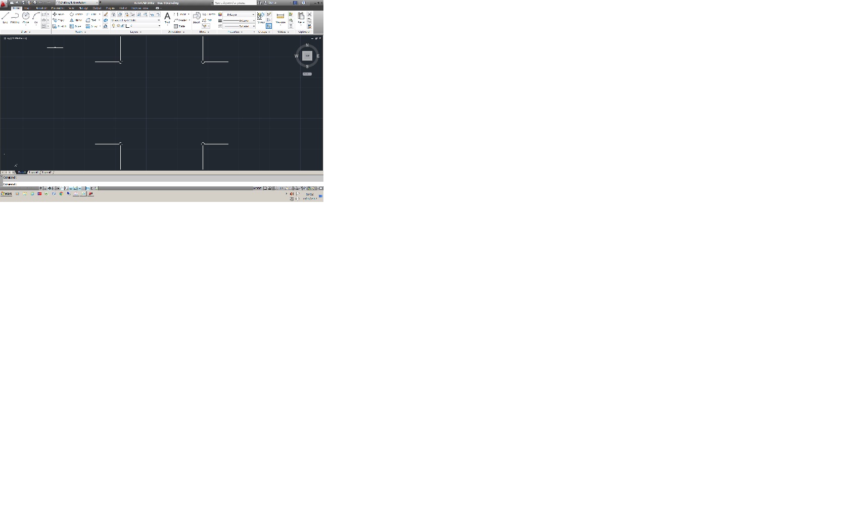

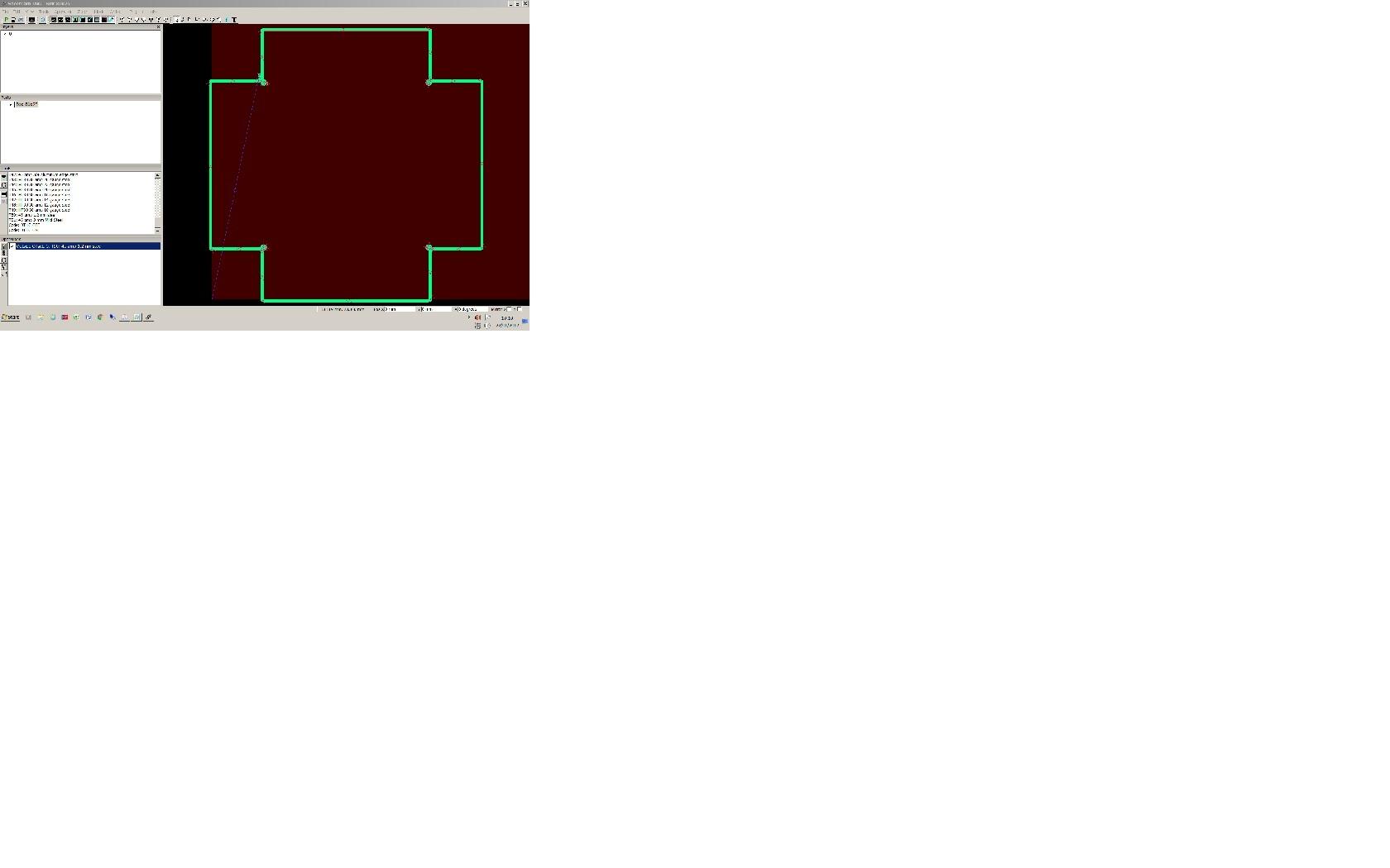

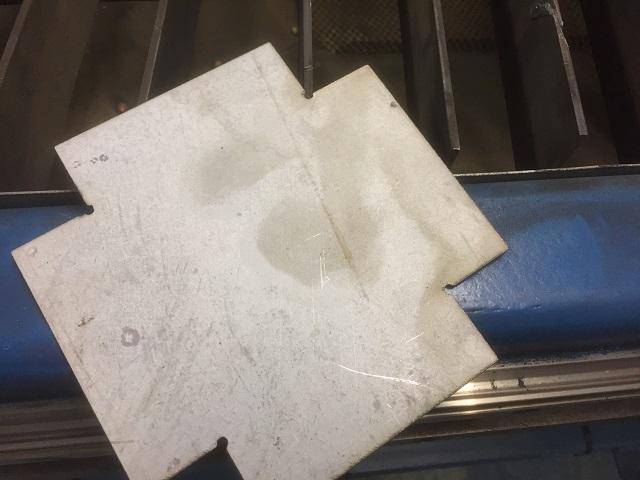

This mornings exercise - try it out on 1.2 mm Zintec mild steel. I'd done a little trial yesterday to optimise cut speed, and this morning the idea was to make a little simple box.
- Draw it in Autocad - save as a DXF file
- Import into SheetCAM and produce a G code TAP file
- Import into Mach3 and make a flat box !
- Bend it on the Edwards Box & Pan folder
Absolutely straight forwards - it took less than an hour including taking the pictures and writing up this thread - magnificent - and no laying out bend lines, or having to make corner notches that go squiffy
--- I love it  :clap: :clap:

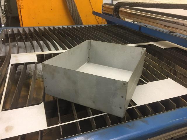

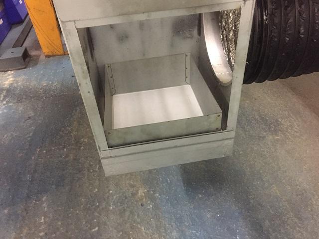

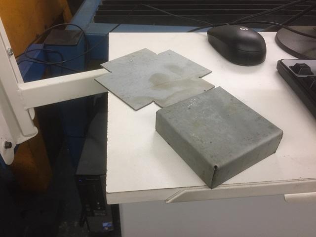

So what's all this box making all about  :scratch:
Well I decided that although bits nicely drop into the collection area at the bottom of the down drought extractor 'funnel', it would be much easier if there was a removable 'ash pan' in there that could come out for cleaning etc.
Ideally it would be the same size as the bottom of the drop box, but in reality it has to be able to pass through the door opening. In my enthusiasm to get it as tight as possible my first attempt ended up about 3 mm too big  :bang:
Never mind - it takes 65.06 seconds (according to sheetCAM !) to cut another slightly smaller one - I'm sure that the bigger box will come in handy for storing things  :lol:
I spot welded the fold tabs as I think it is neater than pop rivets. If too much falls at the periphery and hence misses the box, I can always fix deflectors further up the drop box.

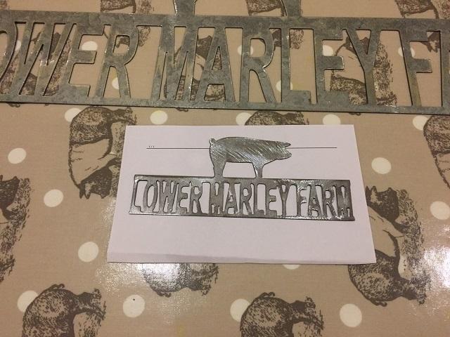

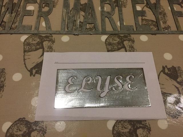

Oh this Plasma Table is GREAT fun  :clap:

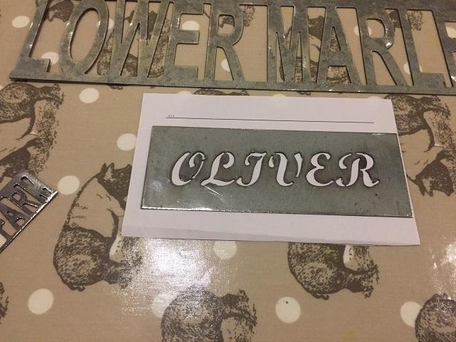

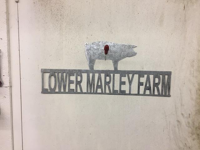

I've been trying to learn Inkscape, which is a very versatile but not very intuitive graphics program that let's me grab images, trace and manipulate them and do things with text that are difficult in other programs.
Here are a few things I've done recently - firstly a sign for the farm (*), then some name stencils to entertain grand children who are invading at the weekend  :bugeye:
(* sorry the pig is skewered by a red screw driver, I couldn't find anything else to hang it on ! )
