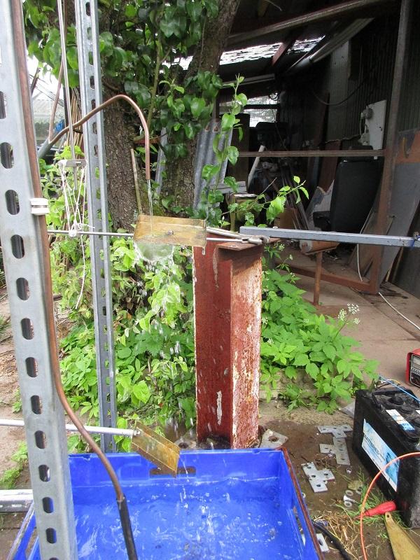

 The idea of a water powered clock has always interested me . There is very little information available on the web .The only reference that I can find is to one built in about 1903 by the Earl of Meath . There was a brief write up about it in 1949 in the Horological journal
I aquired  a copy and have made a working model . It works by directing a jet of water onto an inclined pallet on the pendulum ,if the water supply is uninterrupted all that would happen is the pendulum would be pushed to one site .
The clever part is a deflector plate fitted directly above the pendulum pallet on its own suspension   and controlled by the pendulum rod but not fixed to it . This crosses and interrupts the column of water  directly above the inpulse pallet . Therefore  the only water to land on the inpules pallet is a column of water  equal to the the height differance between the deflector pallet and the impulse pallet .
Next stage is to make it full size with a 2.5 second pendulum which will be about 12 feet long .
I have ordered enough green oak to make a tower 18 feet tall and 10 feet square
When it is working I will use it to control a turret clock  based around my light house drive mechanism  Mike

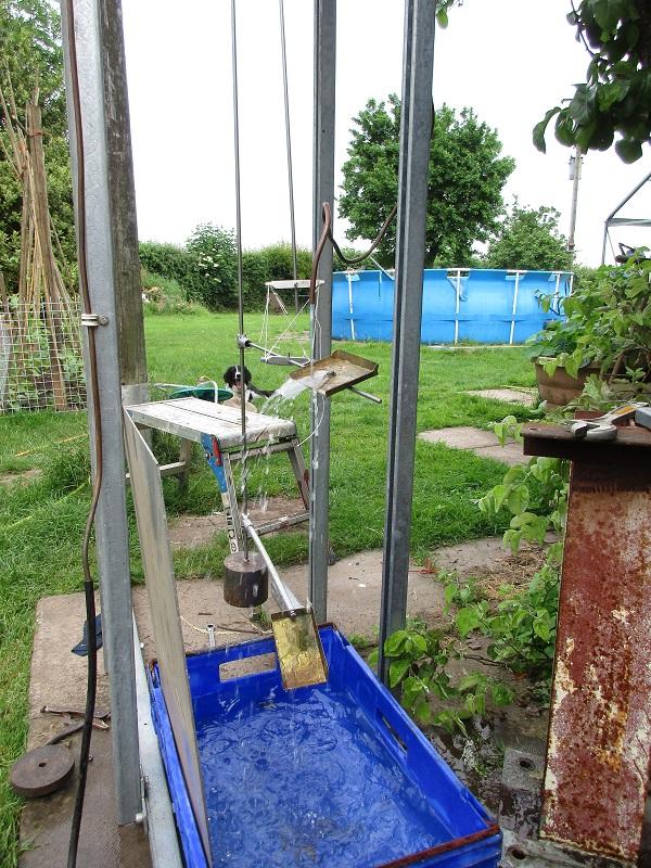

The next stage in building a water powered clock involves getting a means of operating a conventional clock  . As this  is a free pendulum design I do not want to take any power from the pendulum so that when the water supply is not being interrupted by the defector plate it will fall onto a  paddle that will control the operation of a conventional  weight driven clock .
