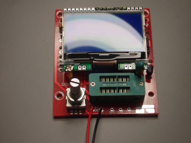

« on: January 16, 2016, 02:53:22 AM »
On Rob Wilson's thread "Re: Digital oscilloscope project/kit "#18 is a nifty transistor tester he build from kit.
http://madmodder.net/index.php/topic,11145.msg130205.html#msg130205
I had to have one too.
http://eu.banggood.com/Wholesale-Warehouse-DIY-M12864-Graphics-Version-Transistor-Tester-Kit-LCR-ESR-PWM-wp-Uk-986954.html
It arrived two days ago and I build it yesterday. Was easy eneough and it works. Kit was good, but there were few things that annoys me. I could not find a parts list. References between circuit diagram and PCB were non existent. Felt really weird to "weld" componen on the PCB on silkscreen reference of the value. Makes troubleshootting bit hard if it were more complicated and more layers.
Really wished the insructions were better in structure. Engrish was parts funny, parts incomprahensive. That extended on user interface. E.G. function generator frequency mHz?
Anyway, seems to work reasonably good.

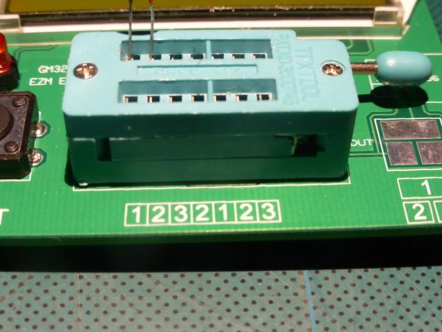

« Reply #9 on: January 28, 2016, 06:30:55 PM »
So, yes I had to have the scope - no problems. I bought the one with pre soldered chips. Then the Component Tester but this time I bought the assembled board, like John S.
BUT :-
"I am a Bear of Very Little Brain, and long words Bother Me," Quoting  A. A. Milne.

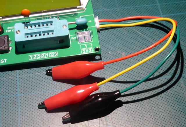

How do I use it, everyone else seems to know. All the experts show components plugged into the ZIF socket - how do they find out where?
Eventually, like Poo Bear the light dawned. This board has the Mega328 computer chip (Same as Arduino) and has RAM, ROM etc built in. The software configures it as a three terminal tester. Components can be connected to any two of them - resistors, capacitors, diode and inductors. Transistors and other three terminal devices can be tested - magic!
The attachments show the ZIF socket. The figures are not a serial number :doh: but refer to the holes in the ZIF. Two parallel rows, any combination of the holes can be used 1&2, 1&3, or 2&3 or 123 for transistors. There are three pads on the board and three flying leads.
Very happy bear.
I hope that this might help other bears out there.
Ian

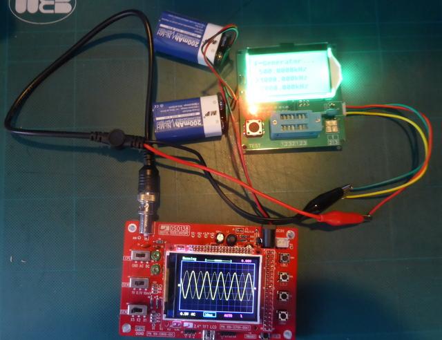

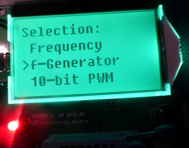

Offline dvbydt
  • Posts: 83
Re: Bang good transtor tester DIY M12864 build
« Reply #10 on: January 29, 2016, 05:46:10 AM »
More fun :D
A long press on the black button brings up a menu and you can pick one of 10 sub functions. The only one I have played with is the function generator.
Photos attached.
The camera captured two scans, only one scan is normally visible.
