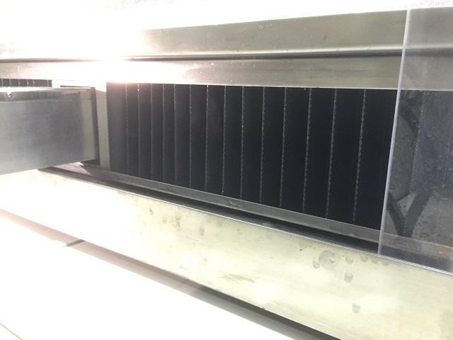

A simpler bellows with no folds can be made from discs of fabric.  I used blackout curtain material for these bellows:
http://img.photobucket.com/albums/v649/etfrench/Spherical%20Pano%20Head/Macro%20Pano%20Head%20II/DSCN6816s_zps6kc0fdfs.jpg3D Printed Quorn Tool & Cutter Grinder
If you go with folded bellows, then make the stiffeners from light plastic and use a v-bit to create the pattern similar to making stencils (assuming you have CNC).
p.s. Here's a model of a Bonelle: https://gallery.autodesk.com/fusion360/projects/22104/bonelle-tool-and-cutter-grinder?searched=

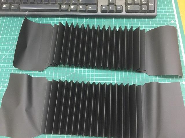

The best looking way to do bellows would be the origami method used by the vintage camera folk. Use polyester paper. It should fold like paper but won't get torn as easily.
  • Posts: 9118
Re: 3D Printed Quorn Tool & Cutter Grinder
« Reply #81 on: December 27, 2015, 05:57:55 AM »

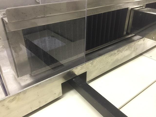

There are places that will make them for you - I had some made for my Fanuc Tapecut Wire EDM re-build.
These are simple 'curtains' but they make all sorts of complex shapes. I would have made them but getting the right material proved the problem so forked out a few pennies
