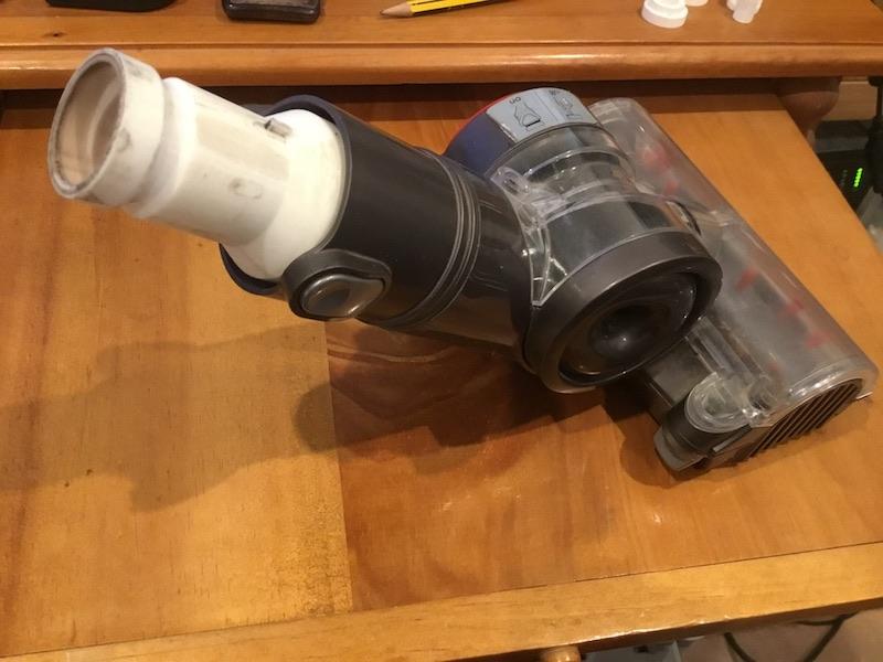

Oh this has to class as a Mad Mod....   14hr delay in hoovering the stairs !!!
My other half bought a new Dyson from Aldi, she loves her bargains.  So muggins job was to hoover the stairs with new light weight model than the old upright.  Break out the stair tool and join !!!  NOT.
Thank You Mr Dyson for changing the fitting size.   So  :coffee: 3D print time.
http://i7.photobucket.com/albums/y253/joulesbee/3D%20Prints/DC%2028%20to%20DC14%20Adapter_zpstlqgnr9j.jpg3D Printing for Suckers
Couple of hours measuring parts resulted in above CAD model, including O ring...  Oooh getting fancy now.  5hrs later I had a print.
http://i7.photobucket.com/albums/y253/joulesbee/3D%20Prints/IMG_0061_zps0cm30bw3.jpg3D Printing for Suckers
This would be 1:30am I finished the print, and join.....   NOT !!!   WTF.... :scratch:
My measurement of the stair tool internal bore was wrong by 1mm.  In all honestly it wasn't where I could reach with the calipers, thats my excuse.  Out to the workshop and fire up the lathe for some very gentle boring to open out the larger end by 1mm.  Bye bye to my O ring, so that was broken away to get at the bore.  Slow machining cut and sealed the surface as I went, the end result was the bore to size and no ragged internal surface as the plastic rewelded into a thin skin, as seen below the step.
http://i7.photobucket.com/albums/y253/joulesbee/3D%20Prints/IMG_0062_zpsjinth6su.jpg3D Printing for Suckers
This time "click" it fits and the other end also fits a treat.  I had spent some extra time reverse engineering Dysons locking lug, before realising I only needed the central part and not the rest, oh well I have the design for any other fitting I may design for this vac.
http://i7.photobucket.com/albums/y253/joulesbee/3D%20Prints/IMG_0064_zpsqbj8bbwp.jpg3D Printing for Suckers
Just goes to show traditional machining still has a place.  I modifed my 3D model to correct for the bore and take out the O ring.  All finished by 3:00am, isn't insomnia great...
Stairs got done this morning, the look on my other half's face    :loco:   Priceless.
To state the obvious I could have just used the upright vac  :lol:  Wouldn't be a MadModder if I did that.

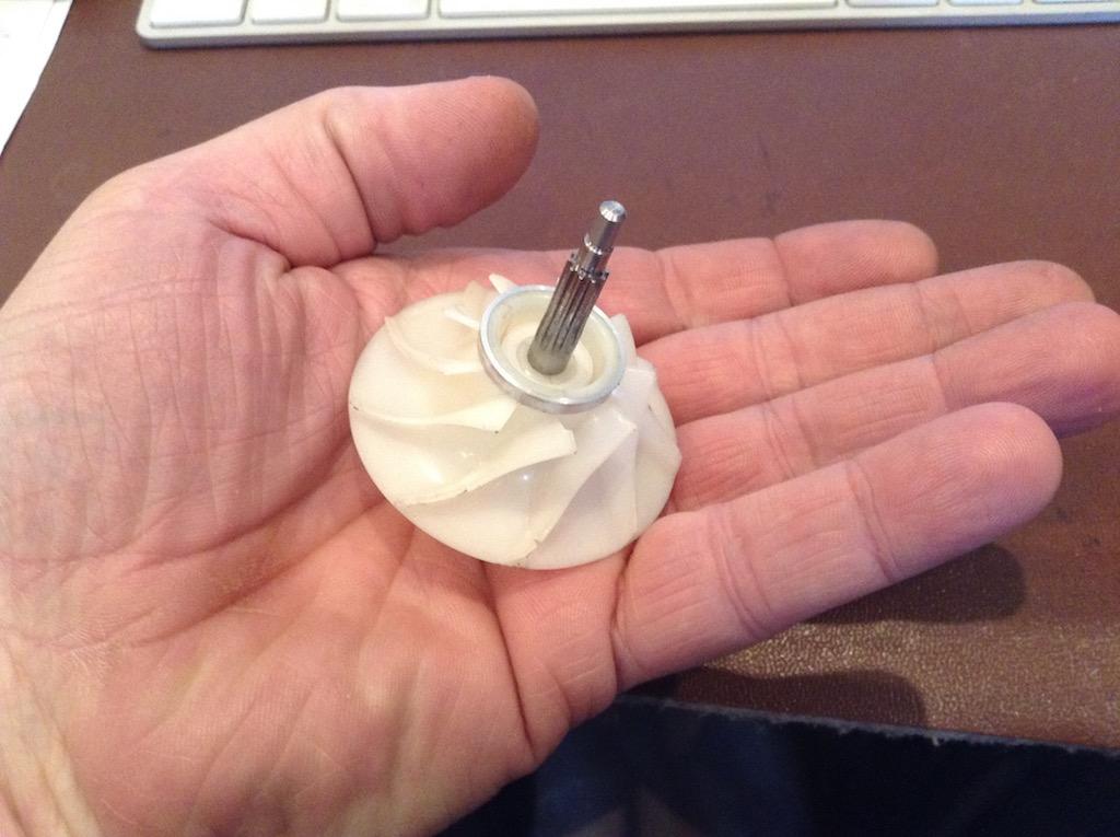

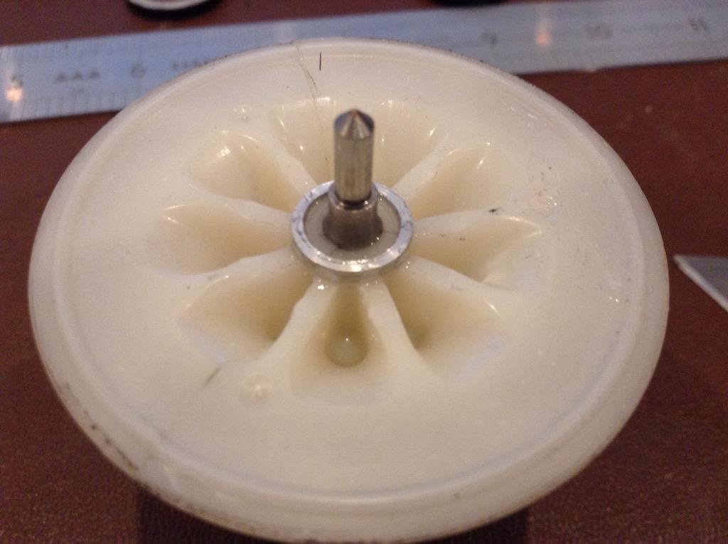

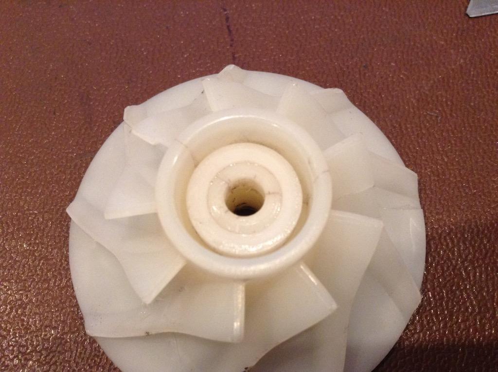

 :lol:  The printed part outlasted the Dyson turbine in this cleaning head.  Very impressed seeing how flimsy it is that the compressor wheel lasted this long.  Now if I have a Pocket NC, a new alloy compressor wheel would be a doddle.   Since vacuum cleaners seem to have had their power reduced in recent years we really only used the small head so my thinking is, compressor transplant from the larger turbine head we don't use.  A resin 3D printed one would be an option, but I don't fancy its life expectancy.  I can still ask Santa for a Pocket NC  :hammer:
  • Posts: 1321
Re: 3D Printing for Suckers
« Reply #19 on: May 07, 2019, 10:53:41 AM »
I just can't help myself, Mad Modding....

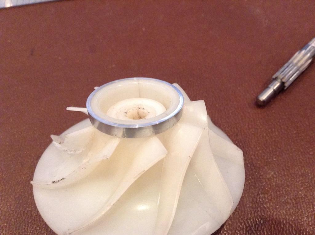

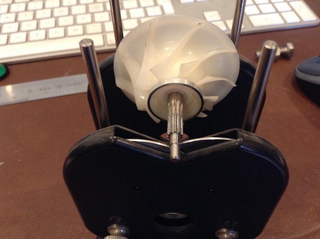

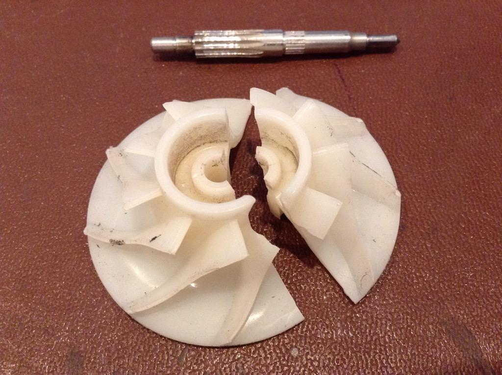

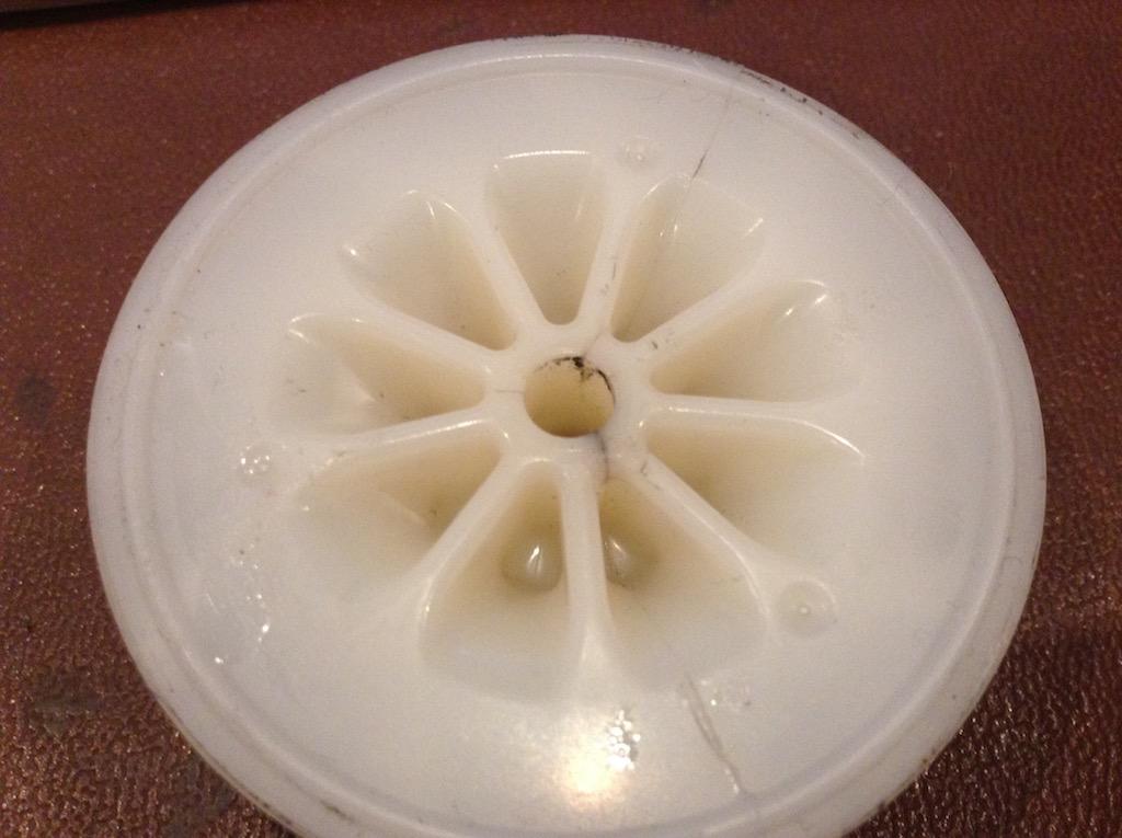

The other vacuum head didn't use a similar compressor wheel, soooooo can I fix this one ???
First off glue it back together and see how bad it is under a bright light, flood the fractures with cyno and hope it wicked in.  The main load on this wheel is on the front where the splined shaft bites into the plastic, so this end is going to need some reinforcement.  I started with a Delrin ring, it being a tight press fit into the recess on the nose of the wheel.  This on its own wasn't going to hold the wheel together so an external alloy ring was also machined and pressed on to the wheel outer.  This should hold the front end together for a while.
The back of the wheel also need some work to stop it bursting apart.  Having sorted the front I could press the shaft back in and mount the shaft between centres.  Some very careful and light machining removed material to let me fit a machined ring on the rear and flood it and the shaft with cyno.  Thats as good as I can get it, removing anymore of the radial arms risks the outer edge of the wheel coming apart.  Final job, check the wheel balance, yesss a little bit over the top, but many moons ago I used to build small commercial jet engines, the balance isn't great but it is such a light assembly and not many places to take material off. Should have made the rings bigger  :doh:
All thats left now is to rebuild the vacuum head and see if the compressor holds together.  Now wasn't that lots more fun than searching for the turbine assembly that Dyson want half the price of a new head for....
Oh, and another story to tell the wife why the vacuuming hasn't been done  :poke:

Yeah, saw those Andrew, but they have to cope with some high rpm and centrifugal force, the blades also tend to be quite chunky.   Just tested the vacuum head, it's a little down on power with a bit more vibration, hardly surprising as it has bits of blade missing.  However it still works and cleans the stair carpets as before.
