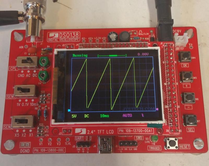

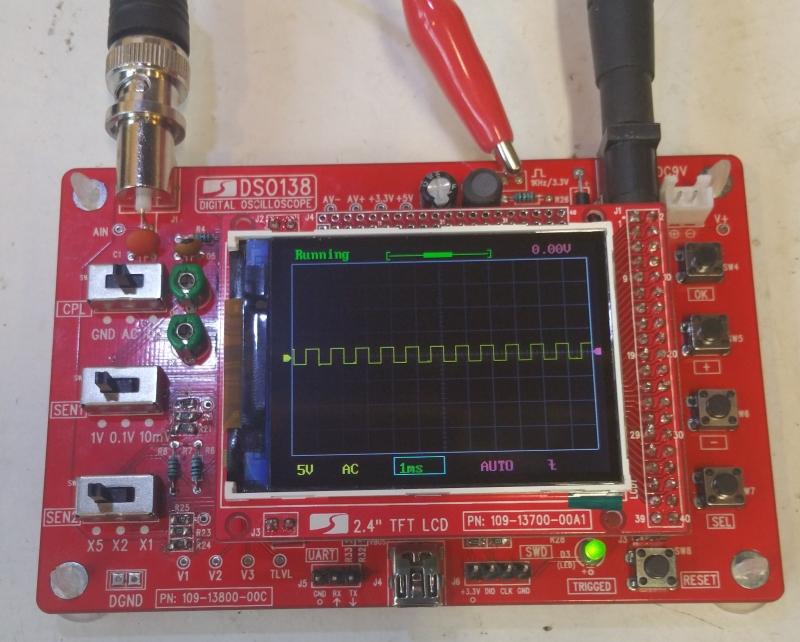

Re: Digital oscilloscope project/kit
« Reply #185 on: January 10, 2016, 11:52:57 AM »
Mine lives  :ddb:
2 pics one with the self generated signal and the second with the signal generated by my other oscilloscope.
sen1 switch is a little temperamental it needs jiggling a little to work properly but I will live with that.
